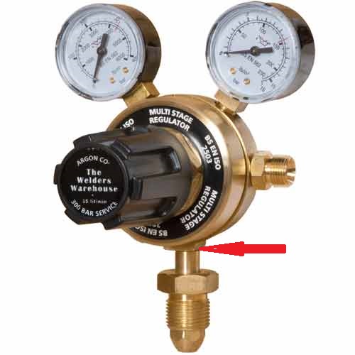

Not done any welding for a while and was trying out a new torch but was getting dirty,porous looking welds. After checking all connectors were tight and trying my other torch i started checking for leaks and found the regulator is leaking here:
It is a threaded joint but doesnt look like its ment to be tightened, loosened. Its still under warranty, should i just return it?
