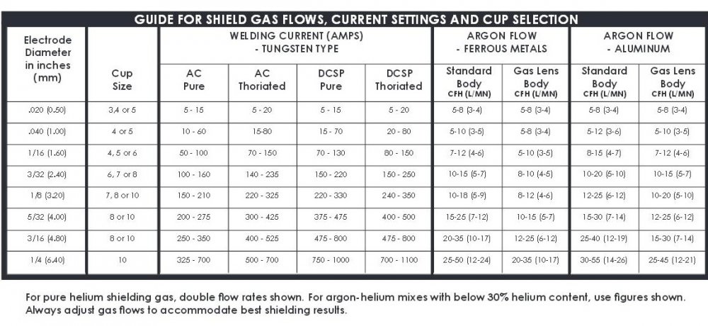

Hi guys, I'm new to tig welding having only just bought an R-tech 161 ac/dc set, and I'm finding I'm using a massive amount of shielding gas
I've probably spent about 4 hours welding total so far but my 20litre bottle has already dropped from 200bar to 120.
I've calculated about 3.3 hours constant use at 8l/min would be an 80bar pressure drop, so is this the kind of consumption I should expect? If so I need to get on the boc volkzone deal sharpish

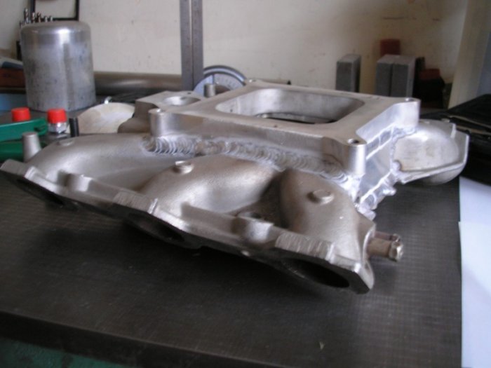

) that was proper bitch. 4 or 5 rounds of swapping between a carbide burr and the torch before i could get a stable arc
