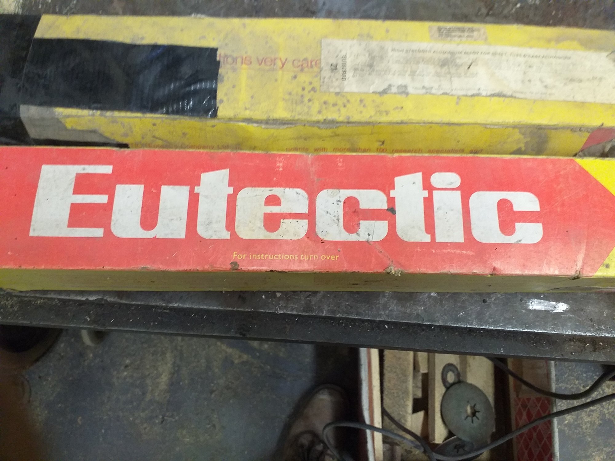

Matchless I started with nothing, still have most of it left Messages 2,870 Location Essex UK Feb 17, 2020 #1 I acquired these two packets of rods, free, I assume for TIG, any thoughts on them? I have not used my tig yet, can I use these for any aluminium repairs? one packet is around 2.4mm and one 5mm,
Brad93 Member Messages 19,087 Location Essex, United Kingdom Feb 17, 2020 #2 Gas welding/brazing rod for use with Eutectic Flux No 21 on aluminium. Not sure if the composition. May be able to use with tig.

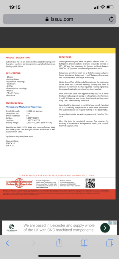

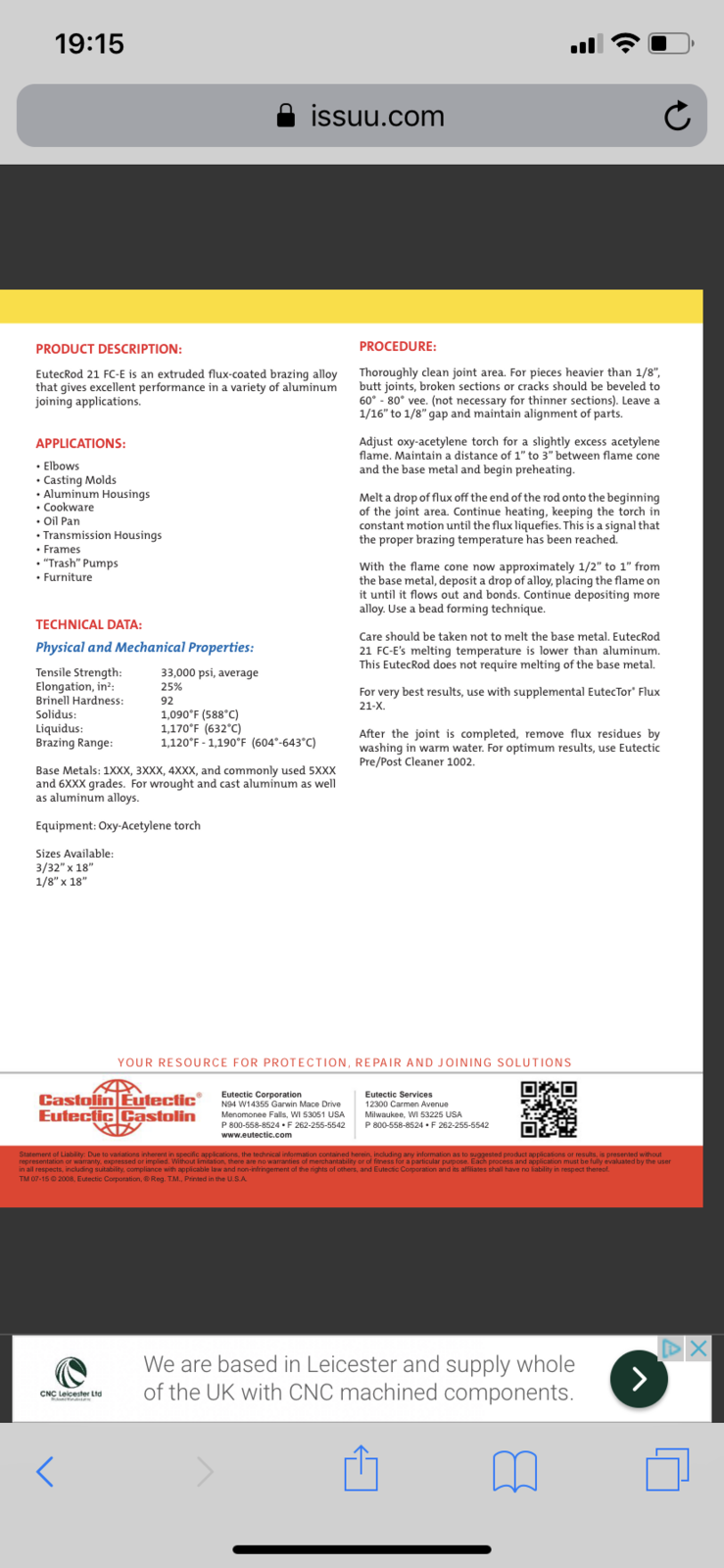

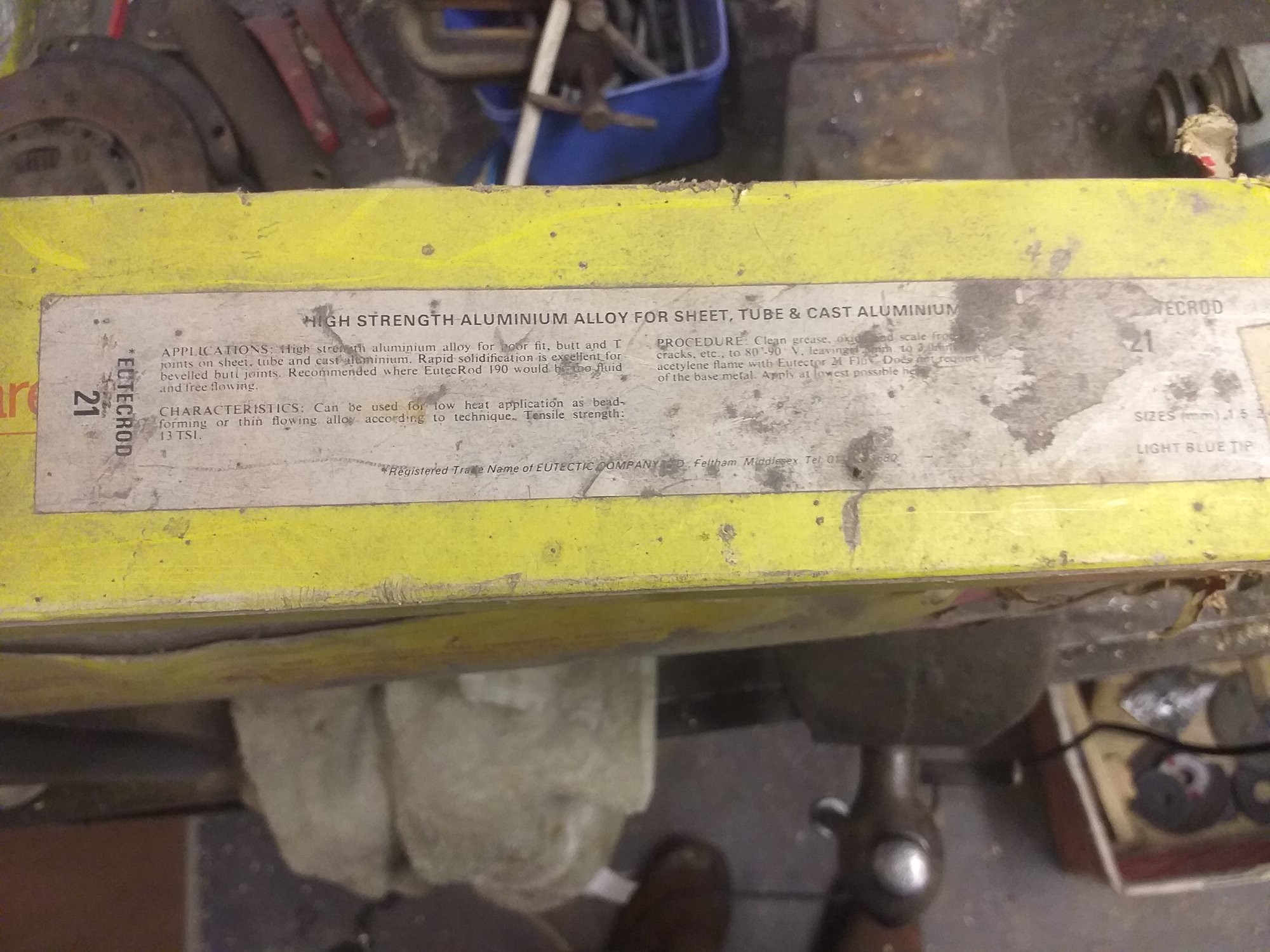

Brad93 Member Messages 19,087 Location Essex, United Kingdom Feb 17, 2020 #3 The only data sheet I can find is for these flux coated versions. Can you get a better picture of the label. 9E042E81-AF02-4E28-A9FD-9DA2E35B6883.png 413.1 KB · Views: 62
Matchless I started with nothing, still have most of it left Messages 2,870 Location Essex UK Feb 17, 2020 #4 will try, bit dirty, thanks,
