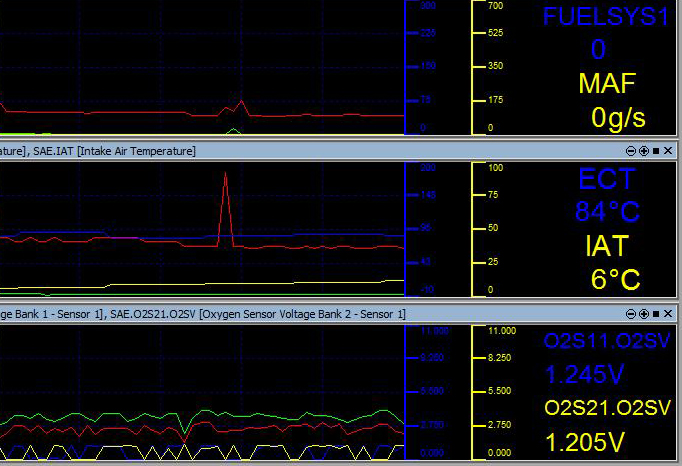

Hi there,
I wonder if someone may be able to share some wisdom on this?
My lovely old Jag (1995 4.0l X300 Sovereign) recently struggled to pass an MOT - on emissions. The tester (as luck would have it, a fellow Jaguar enthusiast) spent several minutes revving the engine to get a pass.
The test showed that the mixture is rich, however, oddly, it idles a little fast - suggesting maybe an induction air leak.
After connecting my ELM 32 scanner, I am getting some readings, which I think may throw some light on this.
The MAF is reading 0.01 lbs/min at 2016 rpm. In fact, it does not seem to go much above this - even up to about 2200 rpm. Now, I don't know much about diagnostics - but that seems very low to me. In this same frame of data, the bank 1 O2 sensor is reading 0.045V and Bank 2 sensor 0.040V. Two frames of data later (with RPM at 2048 rpm), O2 sensors are reading 1.245V on Bank 1 and 1.205V on Bank 2. Engine Coolant Temp is 84 degrees C.
Additionally, Long Term Fuel Trim (Bank 1 and 2) are both consistently at 40.6 % - which, to me, seems high.
This leads me to suspect that the MAF is either faulty - or just getting a bit tired. I guess that this Engine Management System uses the 'hot wire' type MAF? I have heard of these getting choked with soot and loosing their efficiency - and wonder if this may be what has happened.
Assuming that the MAF is reading incorrectly, I presume tha this could lead to the EMS adding more fuel.
I do know that my engine has usual cracked exhaust manifolds (a very common problem on these cars) - and, again, I wonder if this complicates things (misleading the Oxygen Sensors as not all of the escaping combustion gasses are passing by them - some making their way out through the cracked manifold).
As may be obvious, I am not very experienced at interpreting OBD data, so any wisdom will be greatly received.
Thanks,
Ian.
