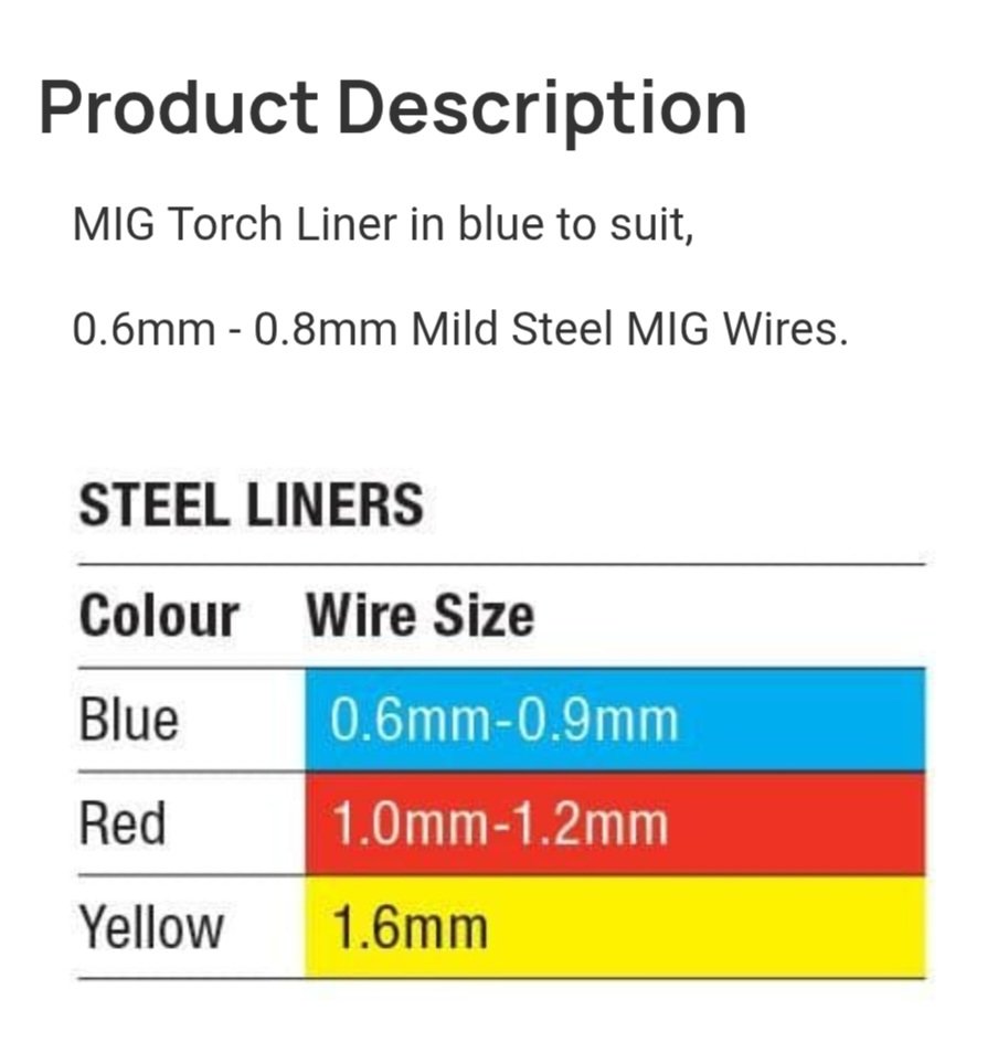

Thanks TEO yea I've got th e correct tips so i should be good to goIn my experience, with other brands, no you don't match the liner. The tip yes but the liner is standard to the machine. On my machines there are liners with different characteristics slippyness wise ie. Teflon for Ali wire but I don't think the internal diameter's differ.
Welcome btw
RYes the liner is sized to the wire, in the UK they are....
But I'm not sure hobby type welders have the choice.

I have a little Cebora 130. Do i have to match the liner size to the wire size please? Thanks.
That'll work for me then BrokenB as I'm using small Guage stuff.for euro torches there are option for groups of wire sizes, for hobby torches ive only ever found the generic ones, but have found they will take up to 1mm wire no problem
