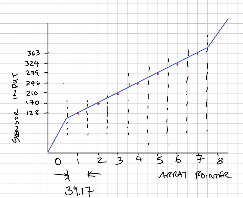

I can't get my brain to work!
I have a number of approximate numerical values coming in from a sensor. I want to map those to a definite PWM output value. This is for a fuel level converter to match a sender to an incompatible gauge. The gauge is non linear and sender has a ladder of switches and resistors. The figures I am getting on test are as per the table at the bottom.
The sensor value can flicker +- 3 so a simple array won't work unless the values are smoothed first. If I am going to smooth them I might just as well use IF, THEN, ELSE to map the values. Of course we also have the problem of the sender being short of one switch!
The program I am using is one that used to do LPG / fuel switching in my Scimitar, written many years ago. Ignore the "LPG" section, it is disabled by taking D10 high.
LPG_PetrolGauge 24/08/2015
Fuel gauge conversion

| Fuel level | PWM output for correct display | Sensor input | |
| Empty | 1 | 1 | |
| 1/8 | 13 | 128 | |
| 1/4 | 18 | 170 | |
| 3/8 | 22 | 210 | |
| 1/2 | 27 | 246 | |
| 5/8 | 39 | 279 | |
| 3/4 | 50 | 324 | |
| 7/8 | 64 | 363 | |
| Full | 108 | No more steps |
