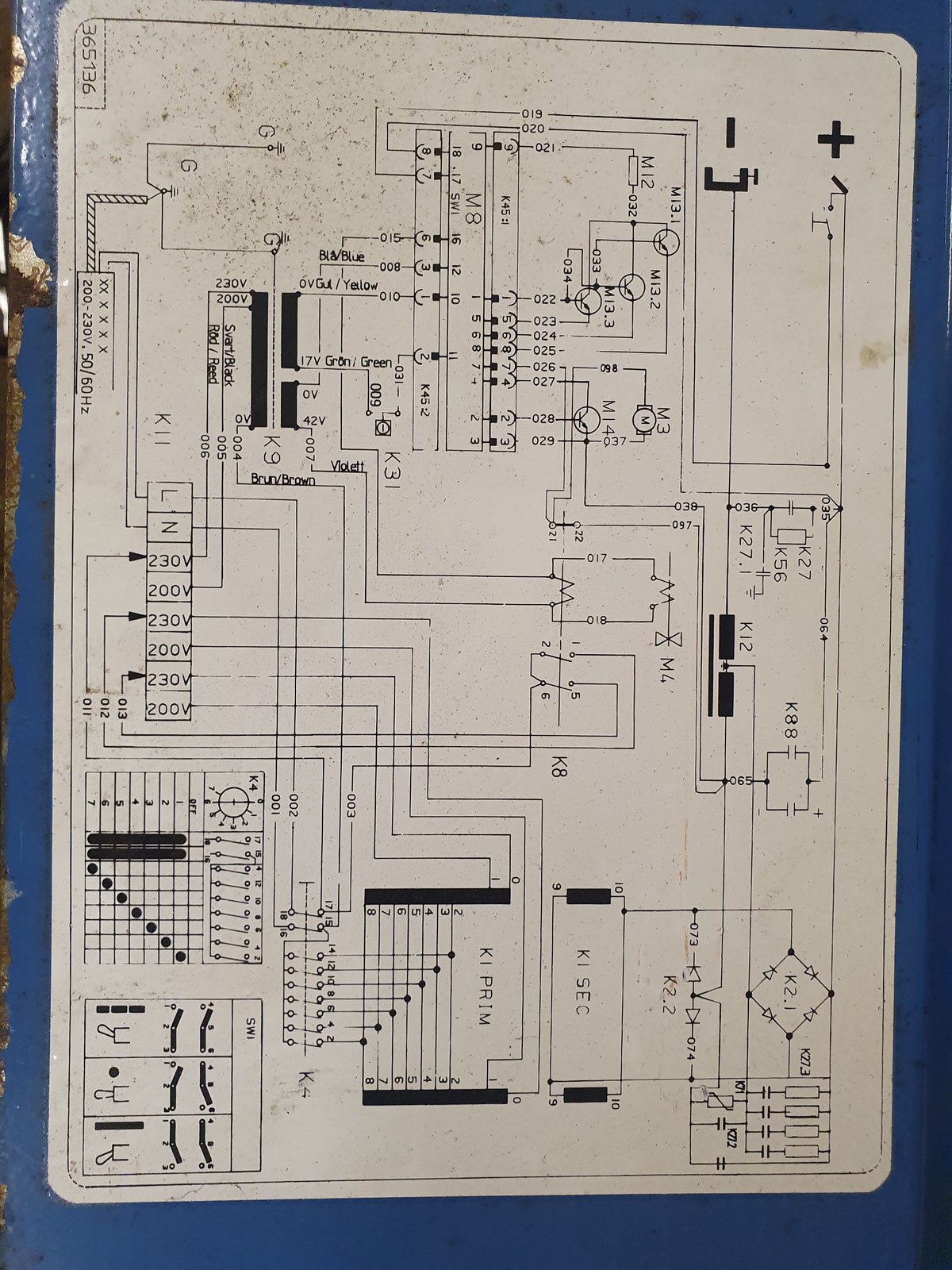

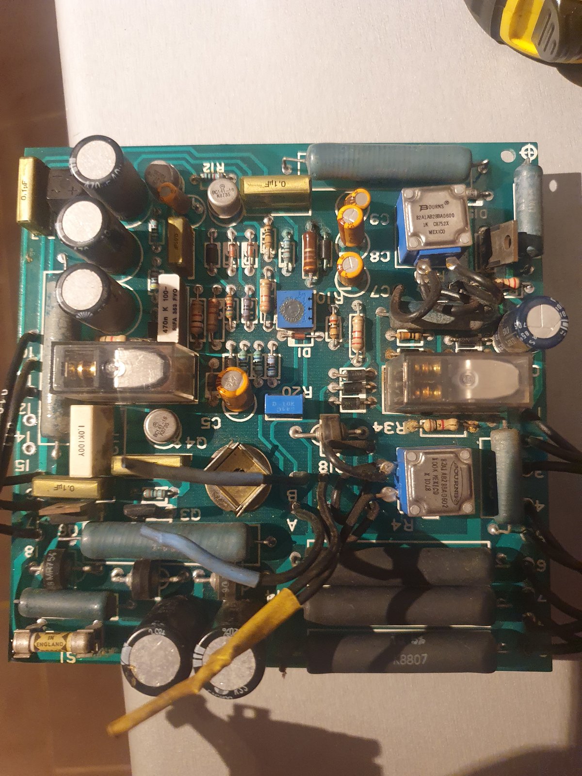

Hi Everyone
I have just been given a old
arco lincoln minimig 180c I believe it was also sold as Snap-on minimig 180c
and ESAB Smashweld It has a fault that I was hoping
I could get some help with troubleshooting
The welder was working fine until it was fitted with a extra long torch then the Wire feed stopped working so far the I have checked the motor running ok with 12v supply the PCB Fuse checked Ok changed the feed switching relay on the PCB the main power relay seems to be working fine switching over when the trigger is pressed along with the new relay on the PCB.
Cheers Flo
