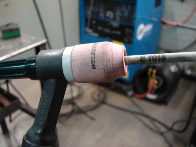

Has anyone here tried anything such as this pic below. ?
Need to stick weld / arc weld on your Tig machine? If you only need to burn a few rods then don’t even bother hooking up a stinger. Just use your Tig torch with a 1/8” or 3/32”collet setup. You can even use the foot pedal if you want.
