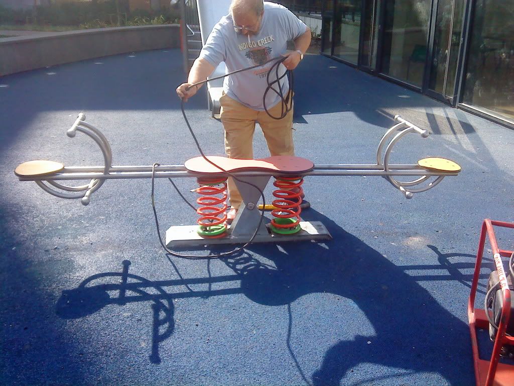

I have a 180amp arc welder that I have for a few years, I was asked to do a repair on a childs see-saw which is stainless steel where 3no 1" welds have broken. I got 6no 2.5mm stainless rods from a mate of mine and I am wondering will my arc welder do the job ???
The 2 plates that have to be welded together are 5mm thick.
The rods I have are :
Low Carbon Universal Stainless
Kestra 4435 LCW AC/DC (+)
