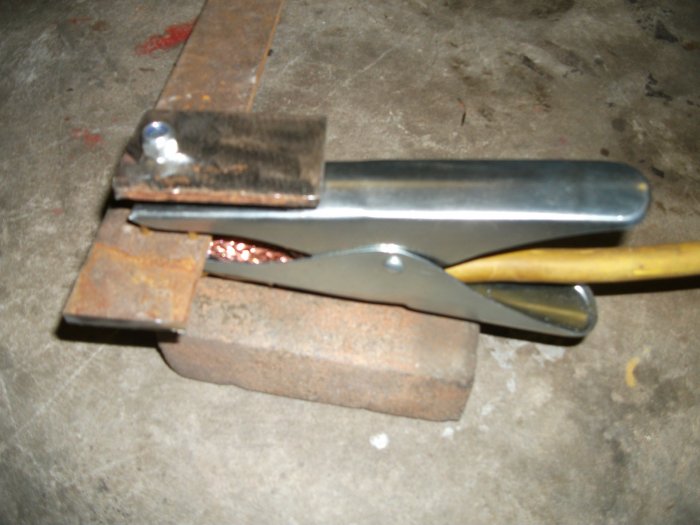

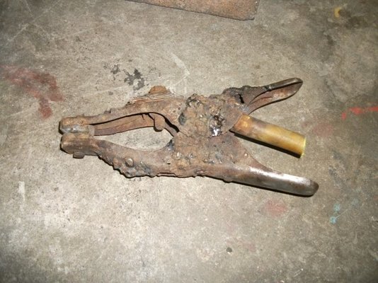

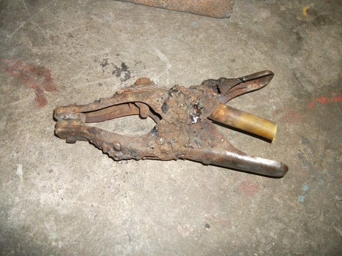

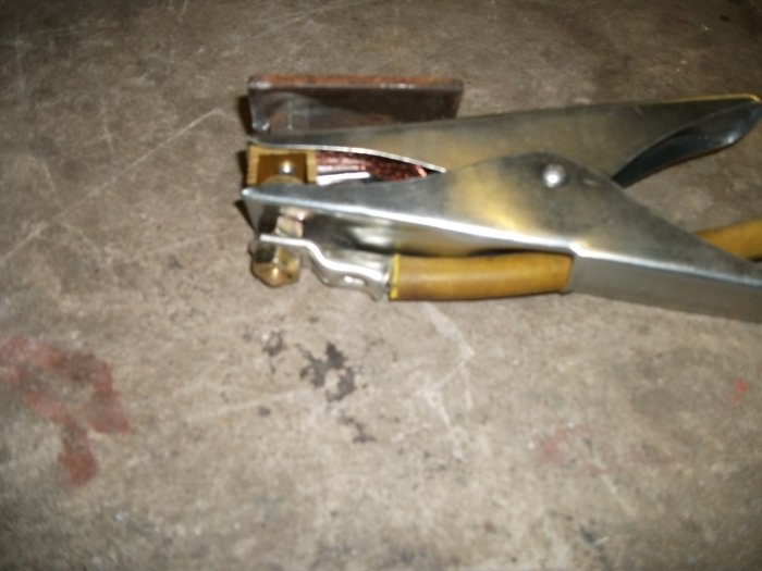

after many years of abuse ive finaly got a new earth clamp
total price £2.00 inc earth lug from autojumble i dont know if anyone else uses the clamp to strike the ark before transfering the rod to the job . it saves marking the workpiece with spatter before the rod gets hot . the new striking plate can be disgarded without ruining the clamp when it gets messy
