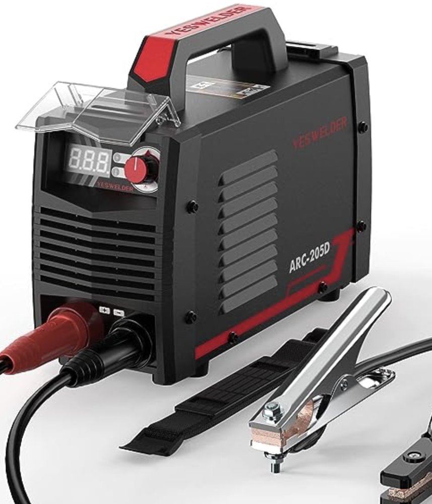

Hobart makes "7018AC" but I don't care for them.You don't say what kind of welders you have. If your arc welder is a single phase ac set and has a choice of high or low voltage output, you will want it on the higher voltage when using 7018s, probably 80 - 90v, and even then 7018s are a difficult rod for a beginner to use.
Yes I have a modern welder both my mig and arc are inverta weldersYou don't say what kind of welders you have. If your arc welder is a single phase ac set and has a choice of high or low voltage output, you will want it on the higher voltage when using 7018s, probably 80 - 90v, and even then 7018s are a difficult rod for a beginner to use.
That's surprising and concerning. My two welders are only 60V and 75V open circuit. How many sets actually give over 100V? A quick check didn’t show OCV mentioned on the spec sheets for many electrodes, although Bohler Phoenix Blau say 42V.Buzzbox's and oil cooled welders are about 48V and just don't cut it now - most rods need 100V plus OCV.......
Both mine are inverters, cheap sets. However a quick look on WSD suggests most are no better. The most expensive Jasic for example states 65V.Most modern DC inverters - have high initial OCV.
