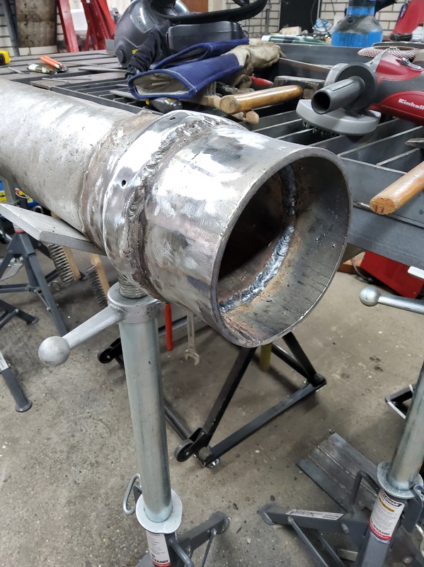

I'm not saying I'm realy good at it, but after years of practice this 5" pipe went sort of allright. Still struggling with small diameter tube though.
