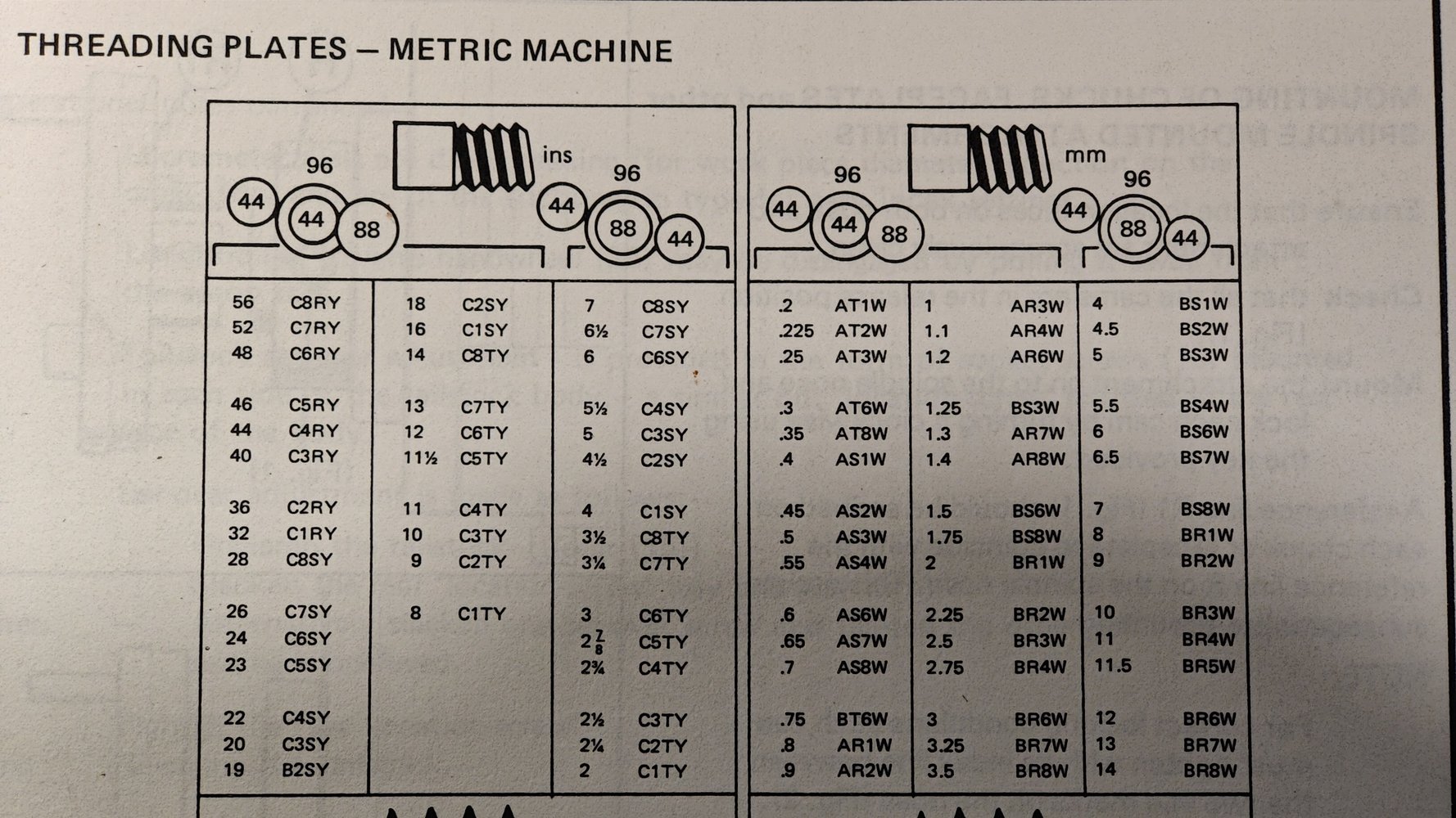

A while ago, a user of my website asked me to make a change gear calculator for the Harrison M300. I duly did so and sent them the link saying "please can you check it looks okay so I can publish it properly?" I never heard from them again
. Ungrateful so-and-so. Took me flipping ages to figure out all the gearbox ratios as well.
A little while later, exactly the same thing happened with someone who had a Boley & Leinen LZ4P.
These change gear calculators have been sitting there waiting to be checked ever since. It would be nice to publish them as part of the revamp of my website but without anyone having checked that they give sensible results, I'm loathe to do so.
Does anyone who have one of those lathes mind having a play with the relevant calculator and seeing whether you agree with what it tells you?
M300 one is here: https://webdev.cgtk.co.uk/metalwork/calculators/changegears/m300
LZ4P one is here: https://webdev.cgtk.co.uk/metalwork/calculators/changegears/lz4p/
