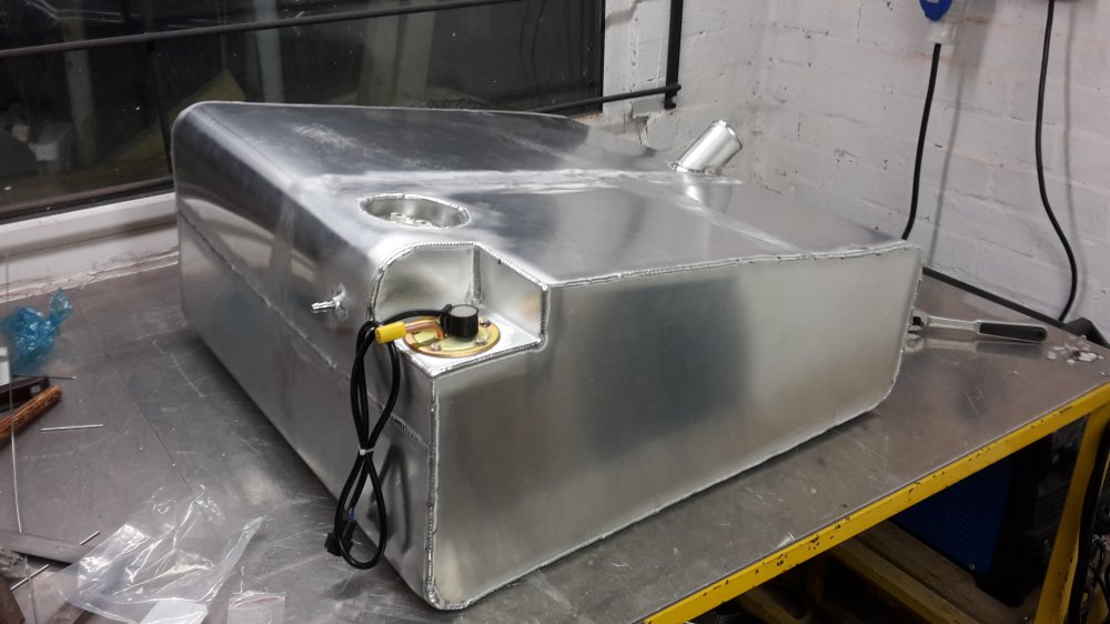

The other option is that which I used on my project. A new alloy tank that takes a Rover V8 injection pump with a flat flange. It could be another type of pump if the flange fitting was useable of course. The design would be a copy of the original tank, with a corner removed and boxed in. It also needs a mounting position for the fuel sender which probably (like mine) needs swapping for a six hole mount type.

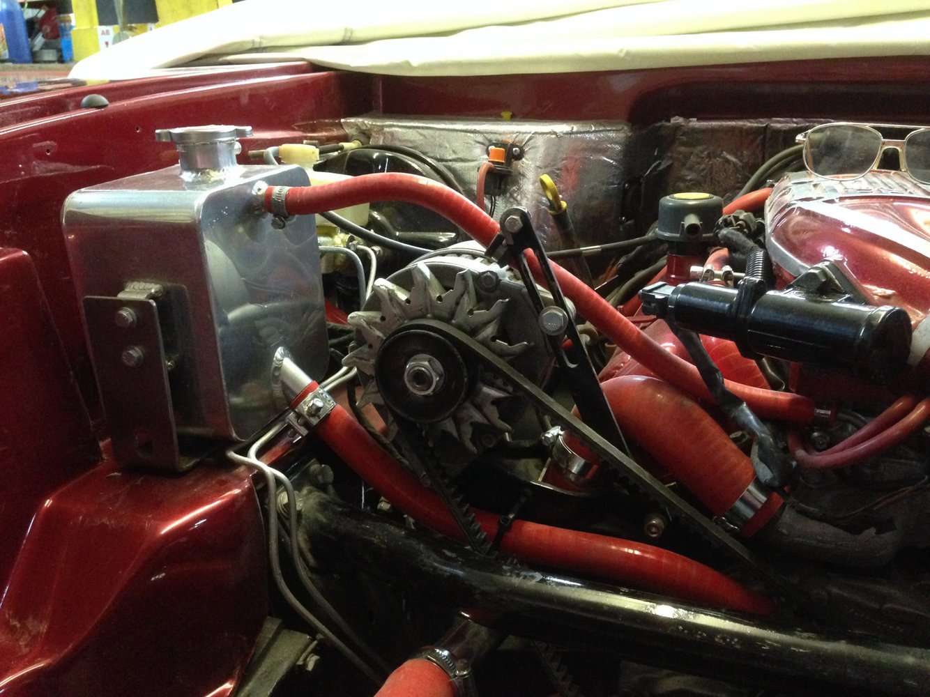

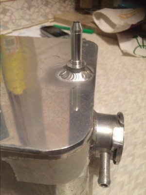

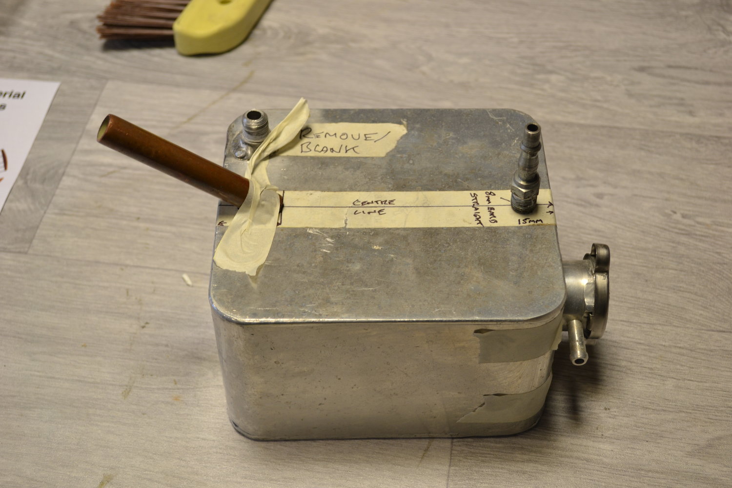

The other potential requirement is for expansion tanks. The original Middlebridge tank is NLA and is a bulky monstrosity too. I have had an alloy one built by someone here and it is just the job.

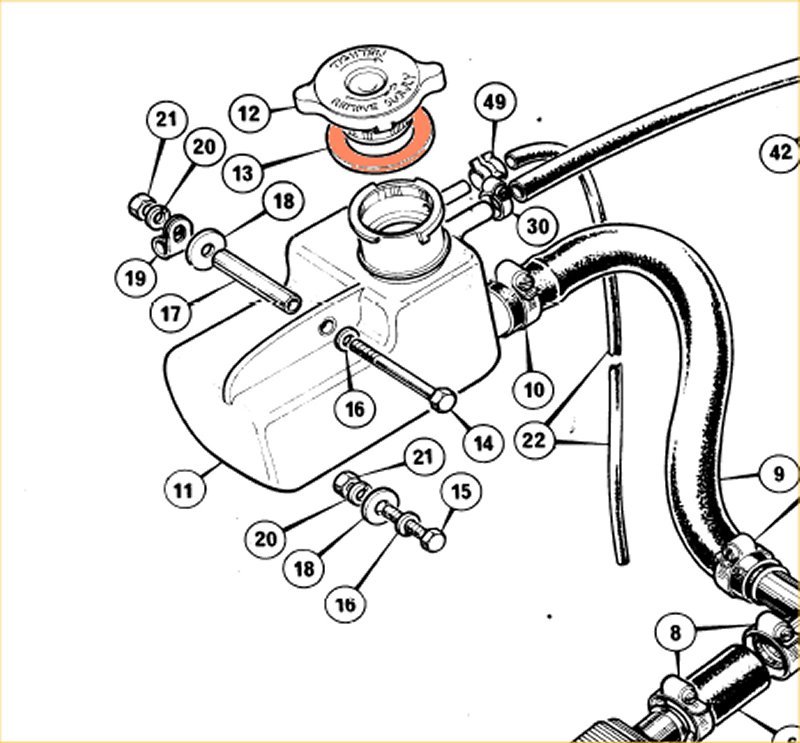

Now the original Reliant fit expansion tank is a Mk2 Transit jobby, again NLA so it would be a saleable item if I could offer an alloy version.
