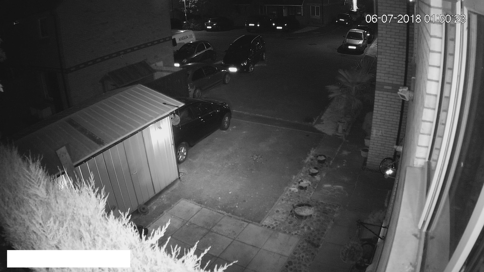

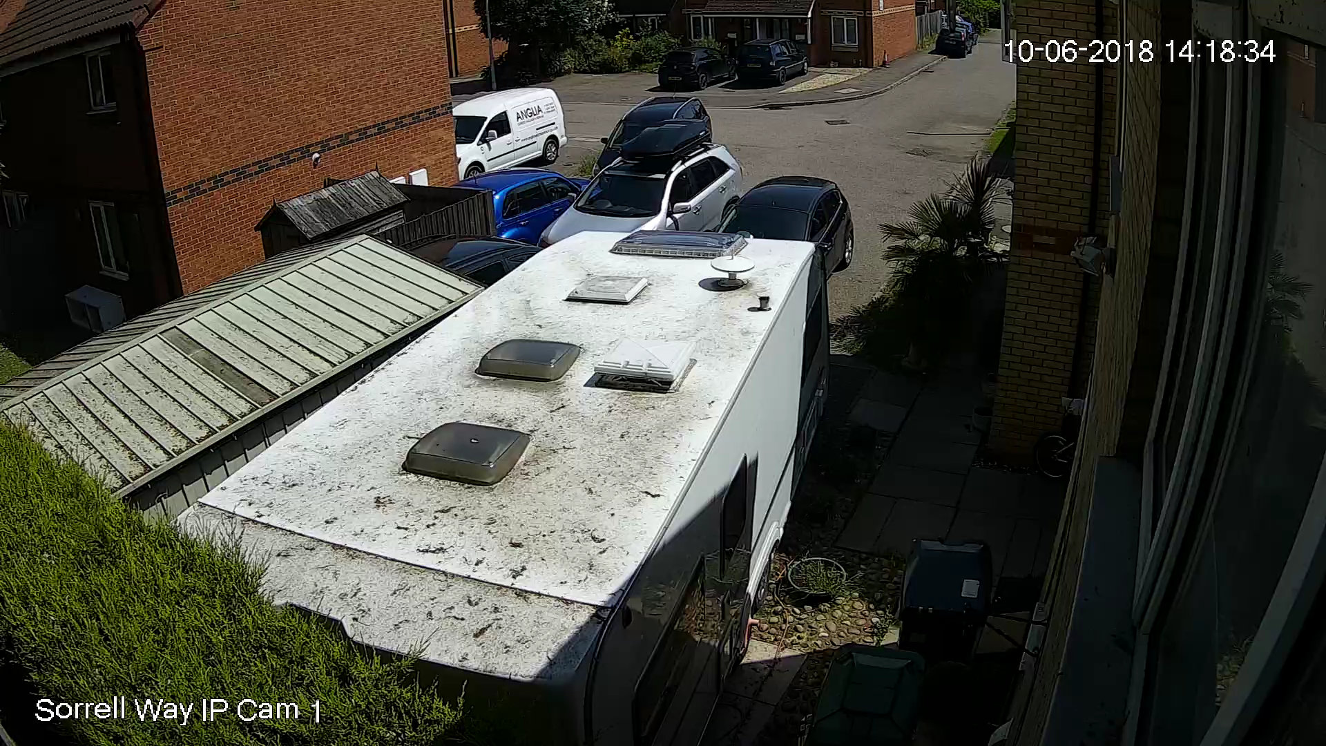

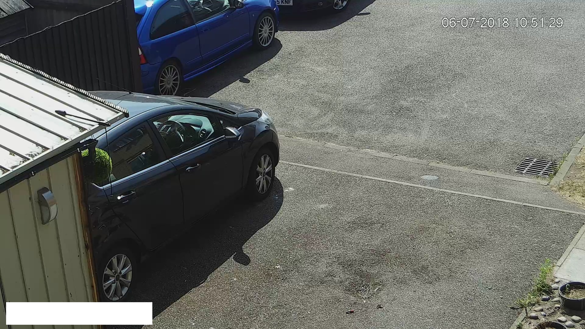

Yes it is quite wide, here's a couple more shots, one at night without the caravan and one zoomed right in and you can easily read a number plate
View attachment 146492 View attachment 146493
