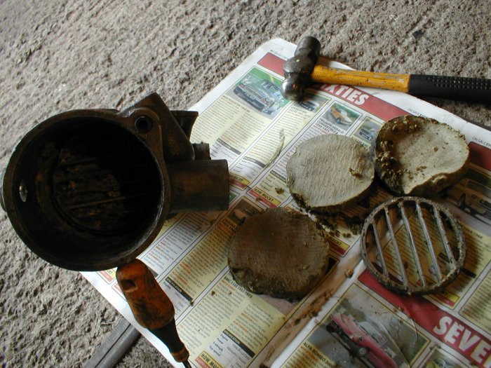

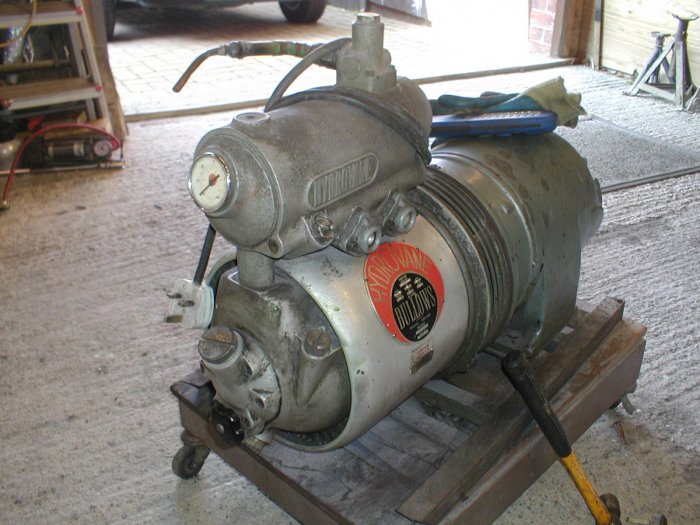

with the long bolt removed you'll need a couple of thin screw drives to prise the round end cap off,gauge will still be attached.
narrow gap all round so you'll need to tap em in at 180 degrees to each other .
ali oxide will fight you all the way
have to agree the total pressure drop on tool use doesn't sound like blocked felt pads.
you'd expect pressure to be same at gauge but no or little flow @ tool.
keep us posted.
keep us posted.
. although technically both soluble in acids and base, aluminium oxide/hydroxide are pretty difficult to attack chemistry wise. could suggest citric acid solution with a drop of detergent or just long soaking in hot soapy water.
