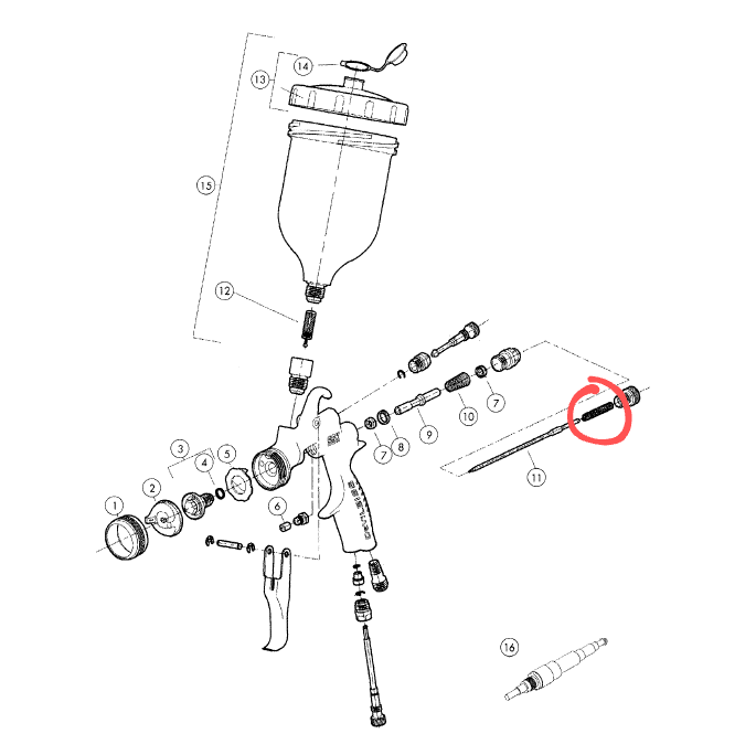

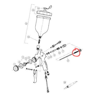

So, anyone have dimensions for the FLG5 spring?
I have a couple cheap gun springs spare.
51.5mm x 6.7mm OD x 4.5mm ID
27.4mm x 7.85mm OD x 6.15mm ID
For my own future reference, the ANI R150 and GF3 springs are
25mm long, 6mm OD, 4.5mm ID.
