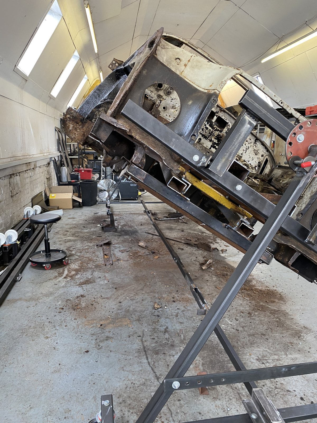

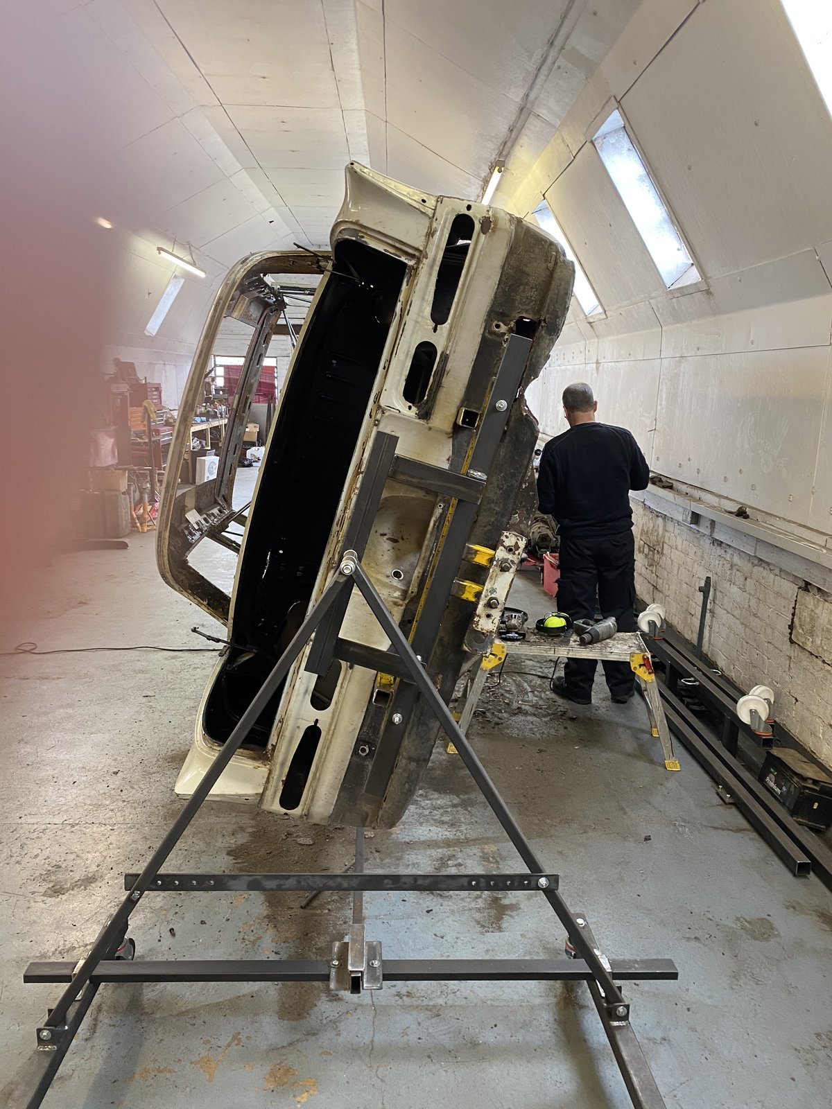

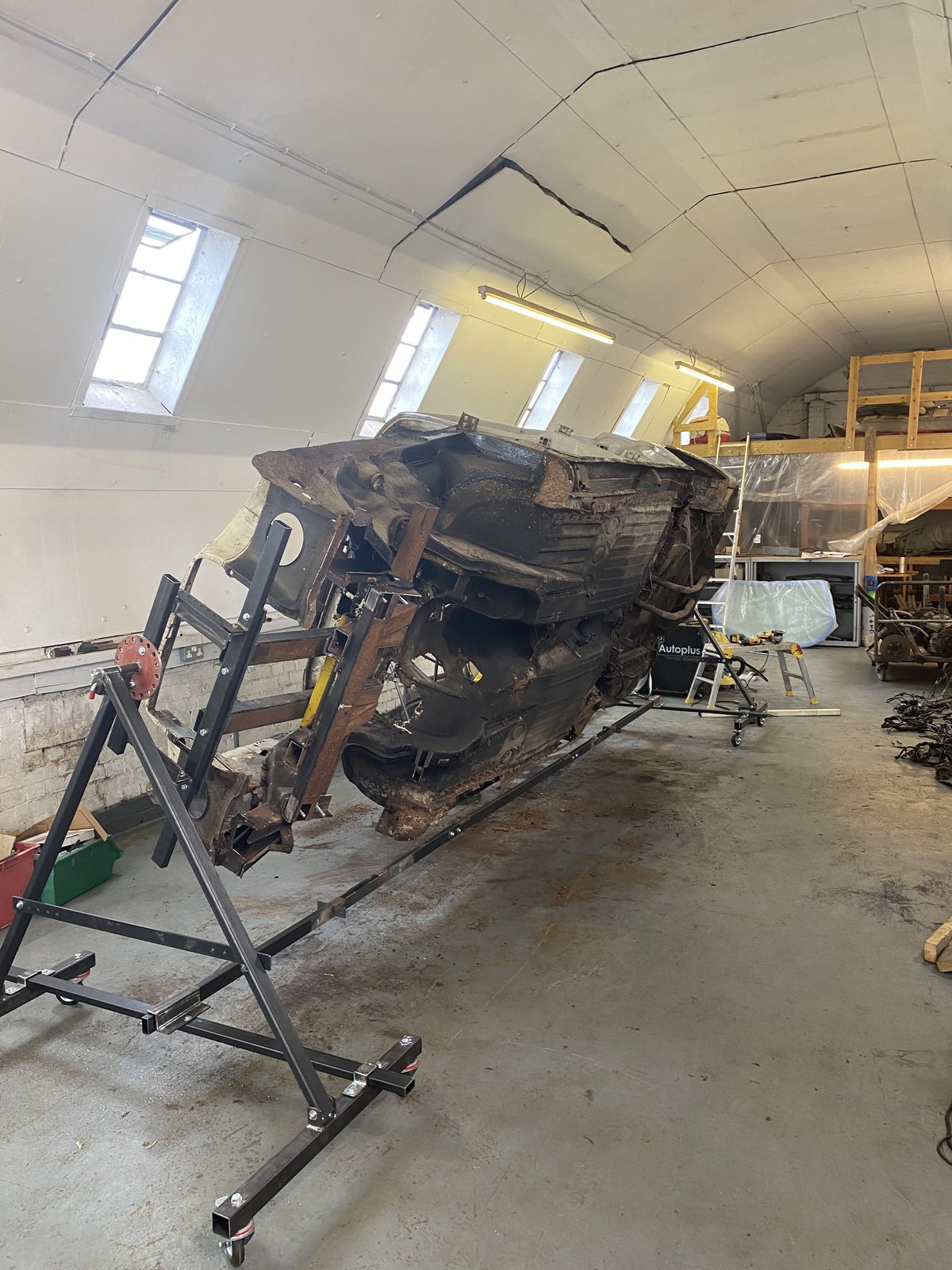

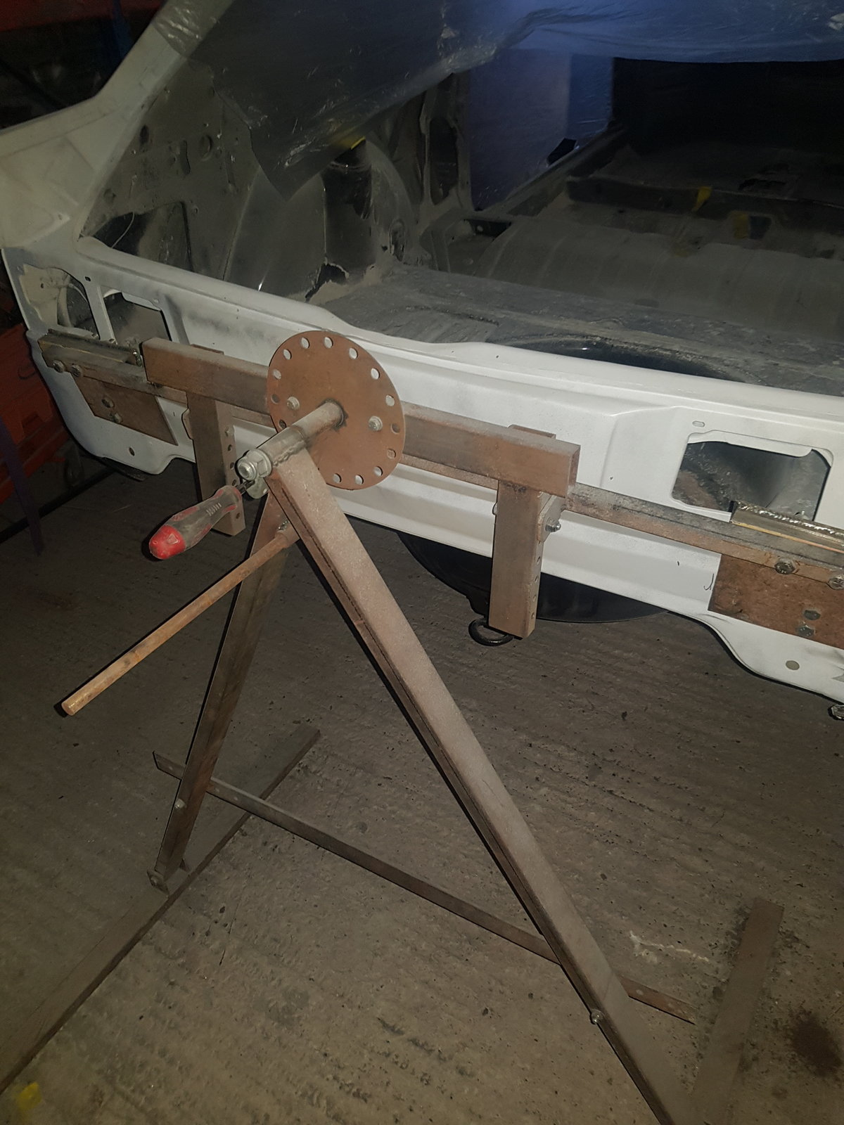

This one is 25x50x3 box,
Car has been sat on it for months...
I reckon the Pivot is some 1/2" water pipe with some 12mm studding through it

That looks like it's been made with my plans - or maybe i saw it whilst i was "researching".![]()
he bought it online, he did ask me to make one but when he showed me what he wanted I was not going to match the price he could buy one for!
