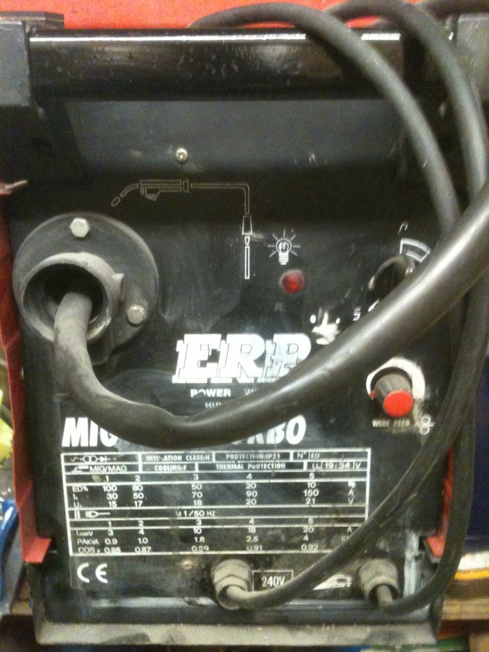

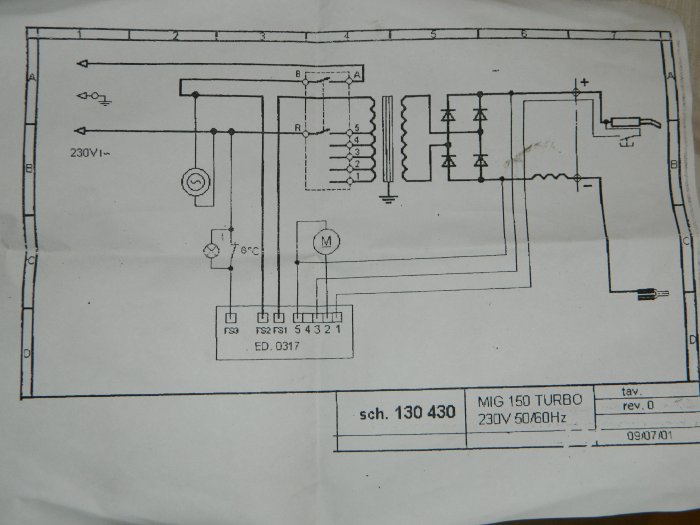

After a wiring diagram for this machine but there are no identifying makings left on it.
It doesn't respond to the trigger, trigger cable was broken but I replaced that. I have 230 volt onto the board but customer doesn't want me to spend any time diagnosing, just wants it back with a diagram. If anyone knows what the make is or has a circuit diagram that would be great, thanks in advance.
