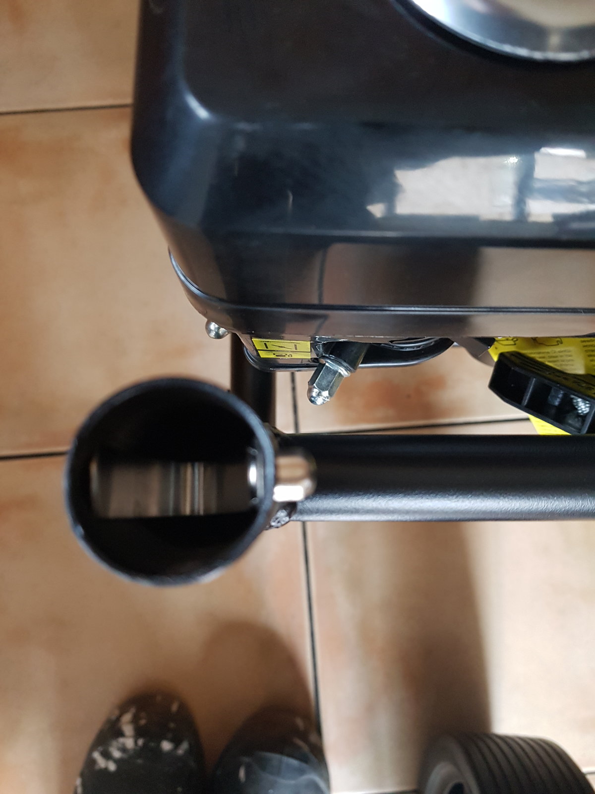

C CT85 Member Messages 37 Location Northern Ireland Armagh Feb 22, 2018 #1 Anyone know the name of these wee inserts the same as the ones that's on crutches??Thanks in advance
500e Always buy fire insurance a flood is a hard start Messages 9,349 Location South West Feb 22, 2018 #2 Button clips, its good to google100 of makes & stiles https://www.rockwestcomposites.com/connector-accessories/locking-telescoping-mechanisms/button-clips

pedrobedro Man at Matalan Messages 13,129 Location CX near Chesterfield Feb 22, 2018 #3 Get them from camping shops I've replaced lots of them in tent frames. A piece of gas rod with a bend at the end can push them in or extract them if they have gone too far in.

bigegg Scream Not Working Because Space Make Deaf Messages 9,749 Location Leeds, West Yorkshire Feb 22, 2018 #4 Lots on the bay: "button clip spring tent" for a range of sizes. About 25p each delivered from china
C CT85 Member Messages 37 Location Northern Ireland Armagh Feb 22, 2018 #5 Cheers lads was hard to search for them when I didn't know there name sorted now
