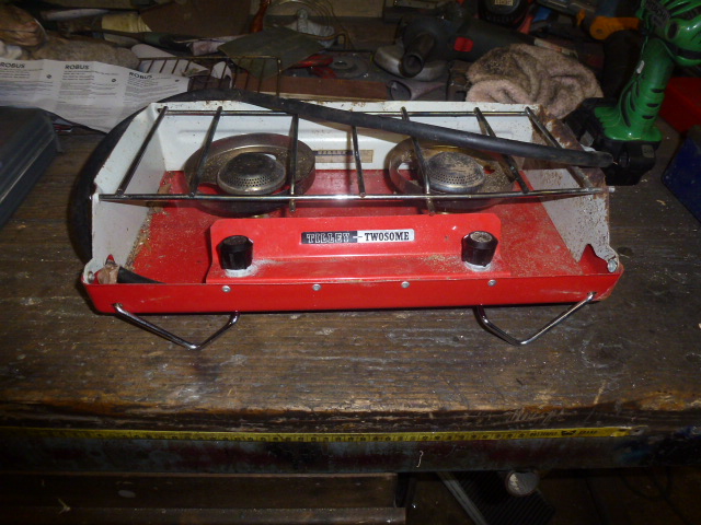

I acquired this 'Tilley Twosome' camping stove last week.

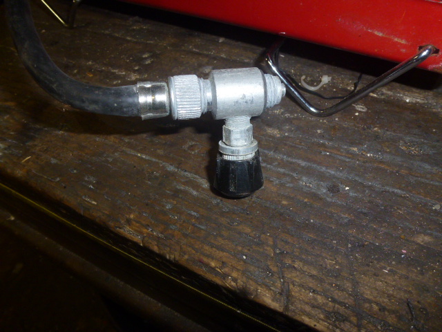

The paint needs tidying but before I go any further I want to see if it works. Going by the hose connection it is designed to run off camping gaz bottles at cylinder pressure.
I want to convert it to run on standard gas bottles because the camping gaz bottles are expensive & hard to get around here plus I need to change the hose anyway due to not knowing its age.
I have several Calor butane bottles, all with gas but it seems that you cannot get a bottle connector for them that allows the gas out at cylinder pressure!
My other option is to use a propane bottle along with an adjustable regulator, either one of the bottom 2 in this photo.
A propane cylinder runs at a lot higher pressure than a butane one so you need a regulator to get the pressure down. I would fit a nut & hose tail to the reg & connect it to the cooker with some new propane hose.
Anyone successfully tried this conversion before?
Another question - would I need to use high temp paint to repaint the cooker body? Does the metalwork get hot in use?
