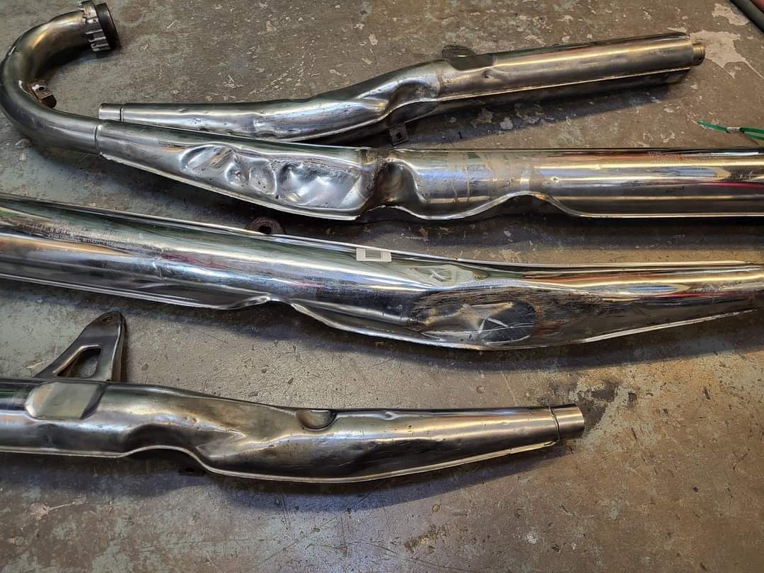

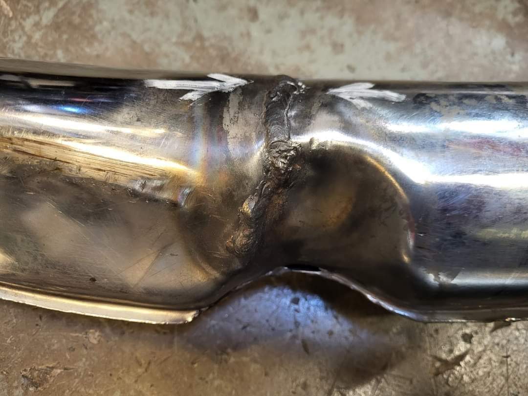

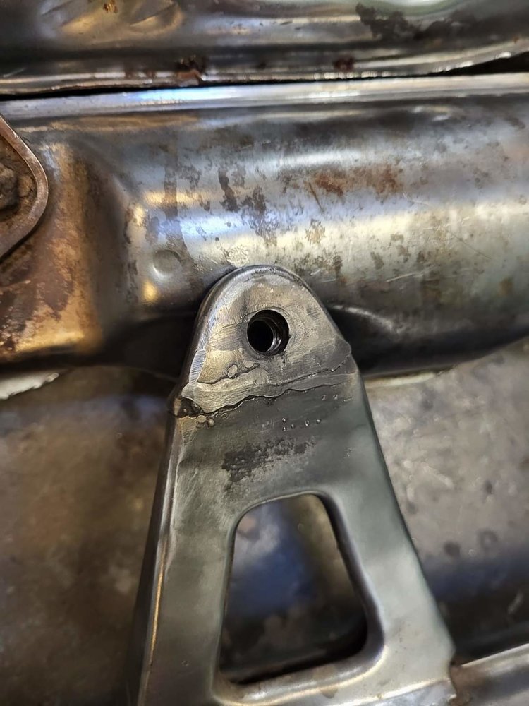

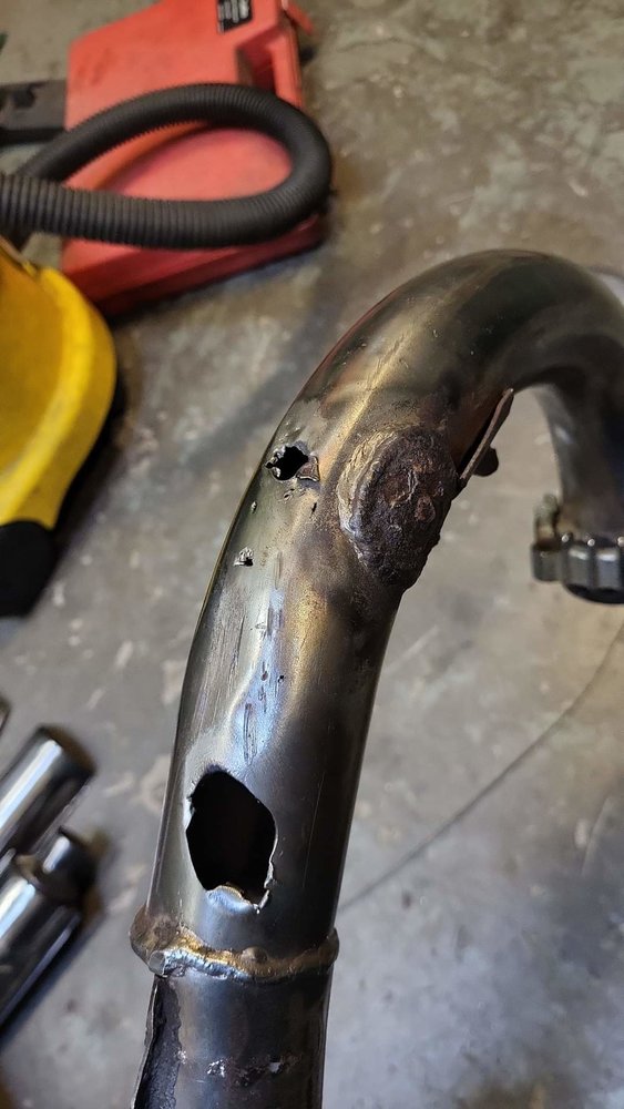

Always done repairs on my motorcycle parts to be rechromed using 55% silver, silver solder.
However, I do have a MIG, that is set up for Silicon-Bronze wire with pure argon shielding gas.
I did try a small repair last year with it but the chrome peeled away around the repair area .. damn!
I have heard of people successfully using silicon-bronze for chrome repairs though, so maybe there is a specific grade of wire /rod to use. (I also have a 200A AC./DC TIG.
Any ideas/suggestions please?
