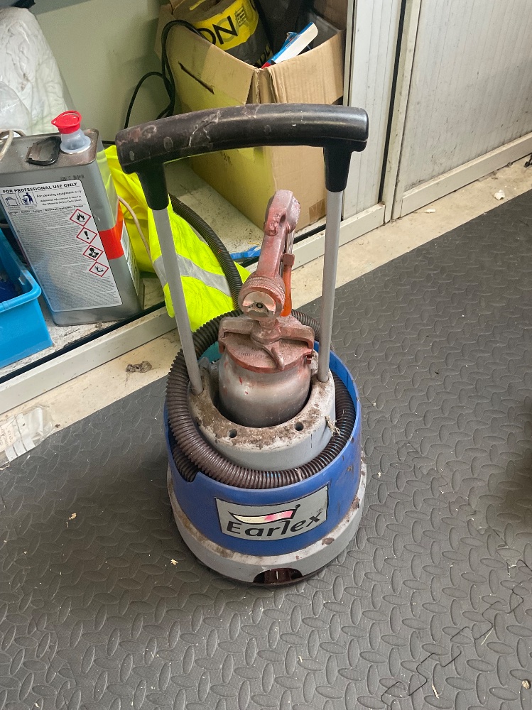

ThanksWe used Wagner and Graco both had short lives always blocking and cleaning was,![]()
