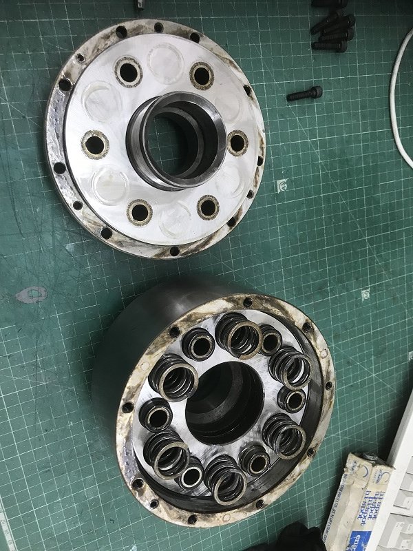

I've spent quite a while making a rather oddball adaptor to fit an internally operated A2-5 hydraulic collet chuck to my A2-6 CNC lathe spindle. It all works rather well including complicated internal oil galleries for open and closing, and the tapers have worked out 'dead nuts on' with no measurable run out.

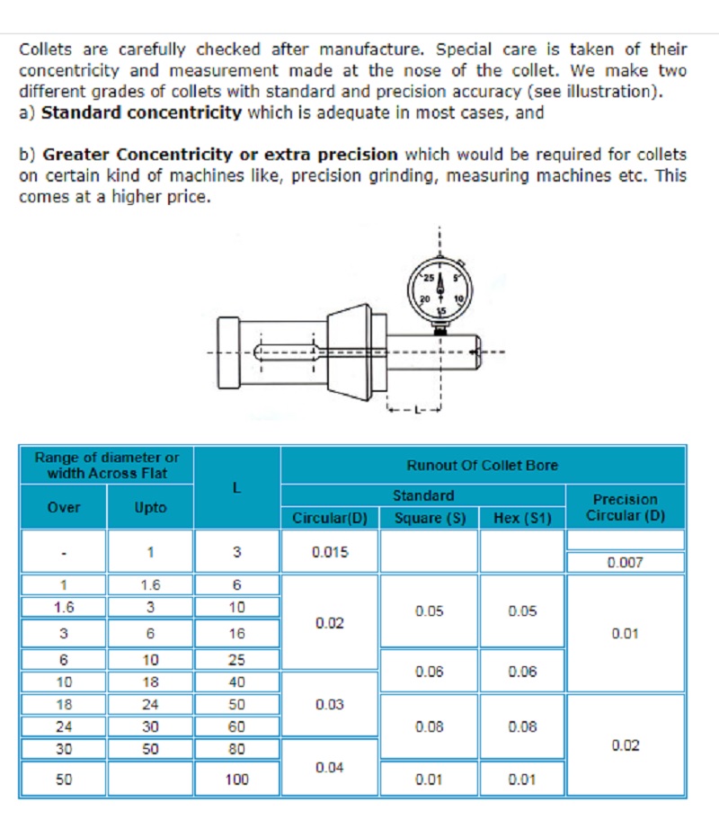

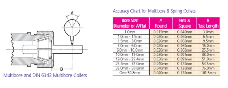

However this second hand collet chuck is giving me about 15 microns run out. OK it's probably 30 years old and not had an easy life but I can only think this run out is in it's taper that the collet is pushed into to close (so not the mounting taper) and 15 microns isn't too much to lap I wouldn't think. But how to go about it?
Any suggestions welcomed!
