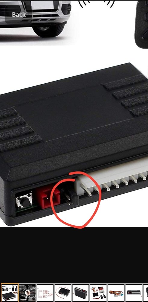

This is on my w124 250d
The central locking works off the key, I see people install these cheap keyless fobs to the central locking pump wiring.
Wired it all up correctly to the main pump green wire and positive/negative.
When I click the unlock/lock button it works correctly but reverses locking/unlocking straight away.
So if I lock it while it's unlocked, door pins will go down but then instantly back up again.
Do it on the key and it stays down.
It's not essential,just thought it would be nice to have,will pull it out if I can't get it to work.
