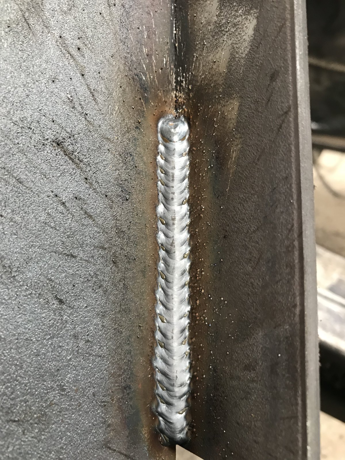

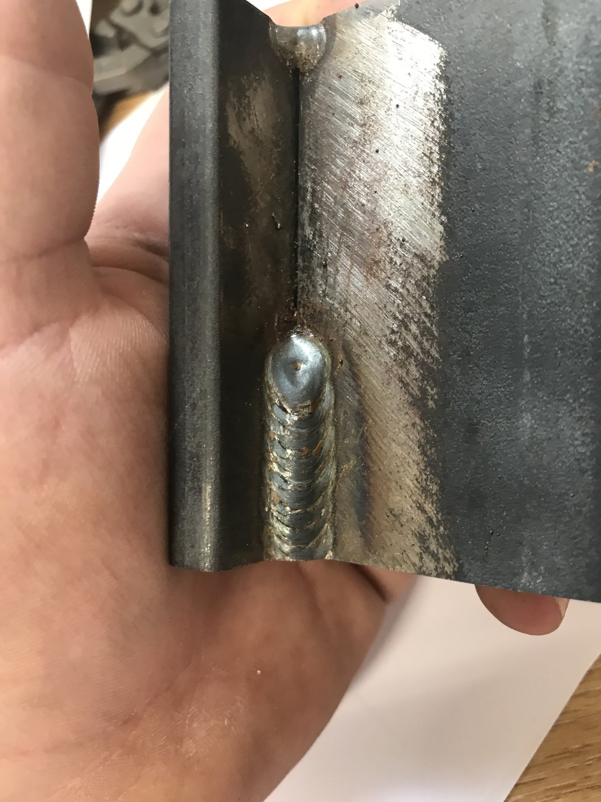

I been practicing vertical welds at work ,think im getting thereNot only is it the quality of the weld, these machines are made to a price. I guess they have tens’s of meters of weld, if not more. If they were all over, how much more would it cost
They look ok to me, but I’m the wrong person to evaluate those. Despite this being a welding forum I can’t weld. I can stick metal together with an electric process, excellent with a grinder
Exactly my thoughts welding the Disco, my welding is rubbish but my grinding and seam sealing is second to none
