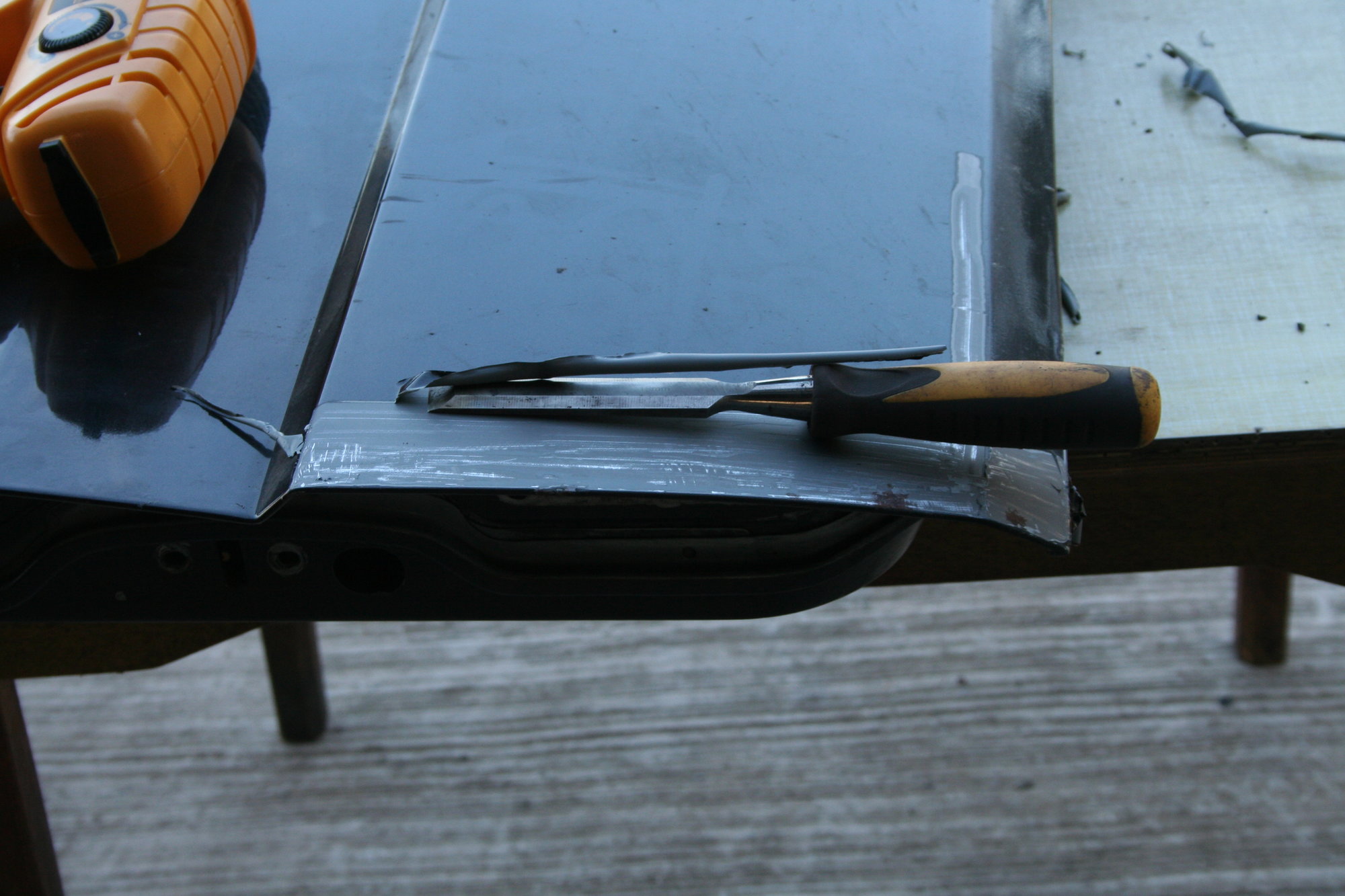

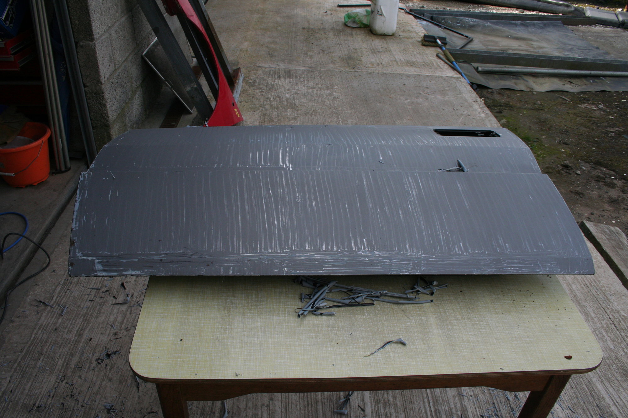

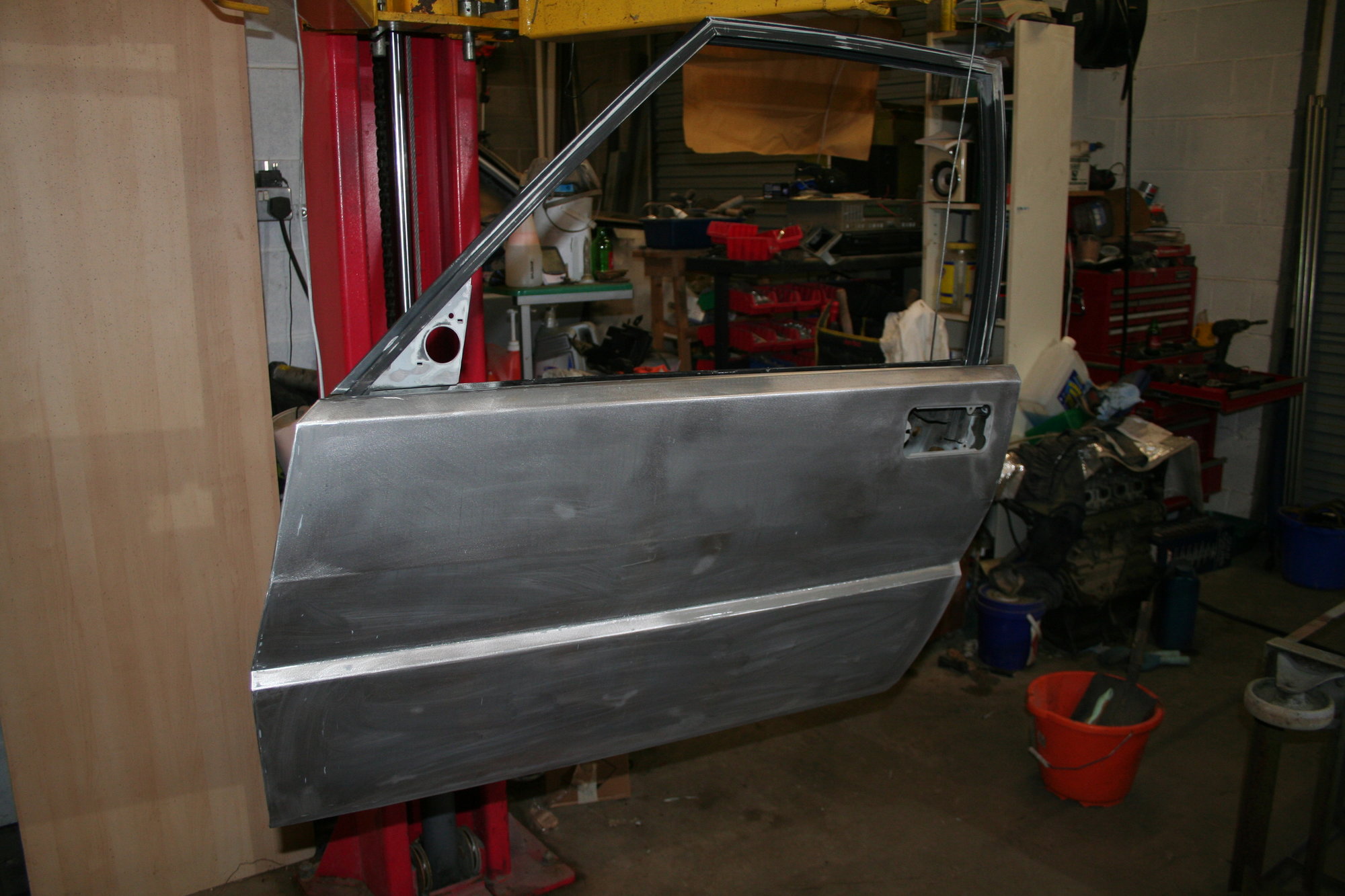

When I tried using DCM paint stripper gel on body paint in winter it was useless, gave up, put the bottle away and got back to using DA sander. Today I thought I'd give it another go. It's 25 C and it is stripping the paint like a hot knife through butter. Apply, wait 2 min, scrape.... just two goes gets through the factory paint. It's gone from being virtually useless in winter to being an excellent solution
