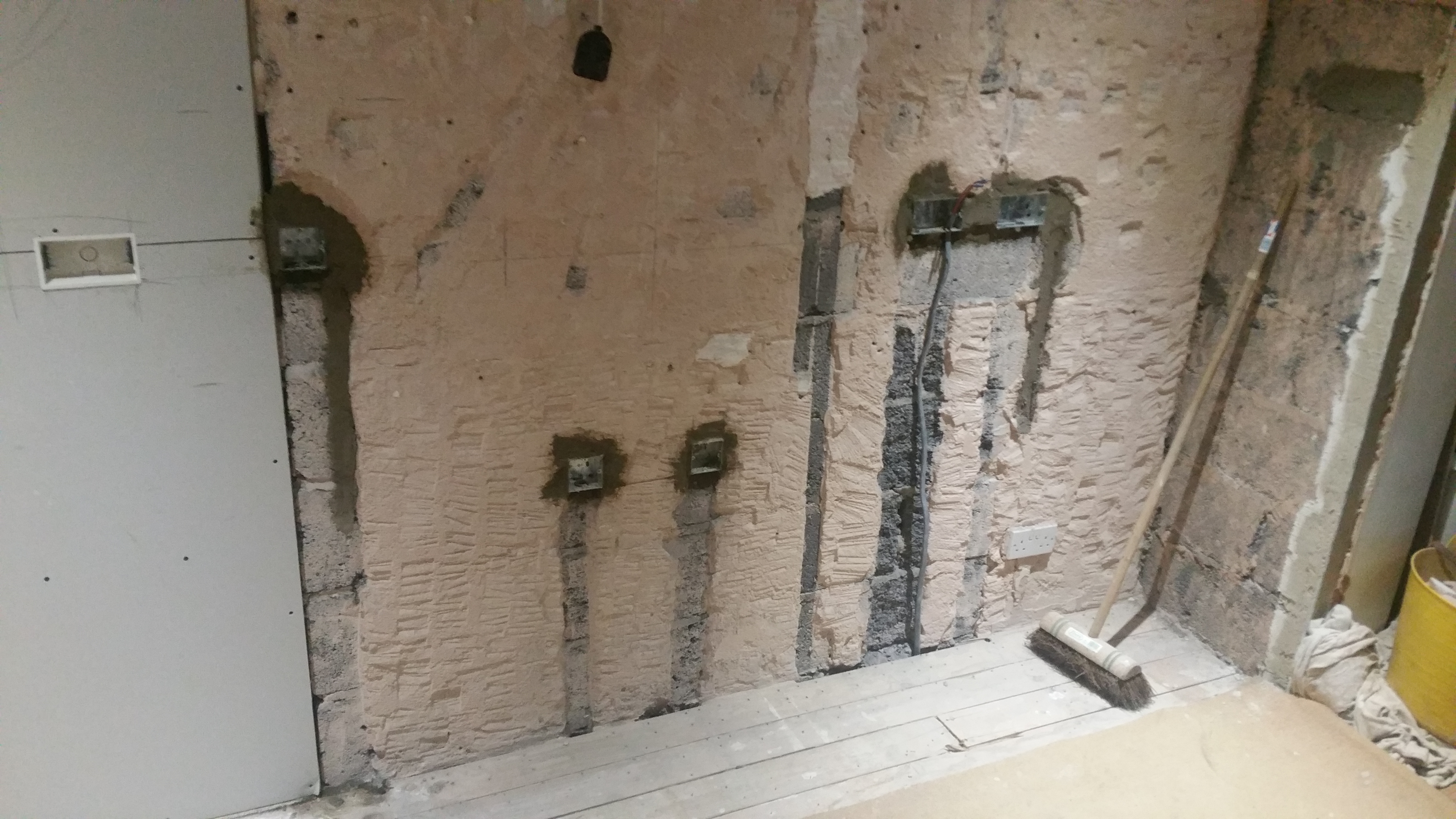

I removed a gas hob yesterday and the bloke fitted an electric hob, I think it was ceramic, it had a 2.5mm flex and the destructions said use a 32a mcb, he already had this installed and a 4mm t&e feeding the connection point (unsure if that's the right name)
the first unit is 4.6 kw 4600/230=20 take the first 10 then .3 of whats left 10+3= 13amp for the cooker
the hob 6kw 6000/230=26.08 take the first 10 then .3 of whats left 10+4.8amp 14.8amp hob
total 27.8 amps total if i add the 5 amp for the extra socket then yes will be over the 30 amp so will have to change the cooker socket for a switch only ? yes
That looks spot on from where I am sitting! Re the socket, is the protective device 32a if so then it will be fine. If it is a 30a fuse then it will still be ok, as I said before modern hobs and things usually won't all come on at the same time this allows smaller flexible connection to the outlet from the hob and a more regulated supply instead of all of them heating together!
s*d it was strugling with what i need to do but when looking on line and both said they need 30 supply i thought better safe than sorry so when pulling in the cables for the ring for the kitchen yesterday went down and pulled another 6mm cable so now got 2 30 amp supplys mate will be coming over and termnate and test in a couple weeks i still got a fair bit of plastering to get on with and the sink to sort
think looking at specs they would just run on what i had but did not feel that safe i know will not use 100 percent all the time but adding the extra 30 just means we now also get an extra socket on each side of the cooker so thats a added bonus better to do it now extra cost was £70 but it was the hassel of pulling the cable and will be running it up the wall i dont like cables runing in trunking so am having to put them in the wall and with the 6mm and 2 2.5 more to do but hayho
