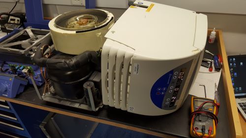

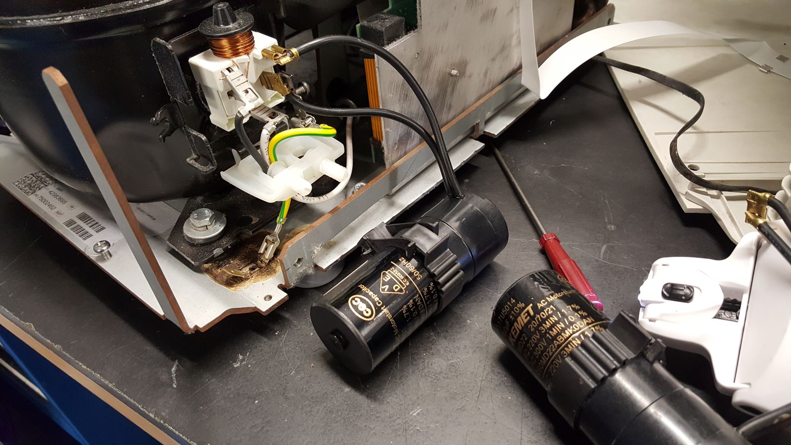

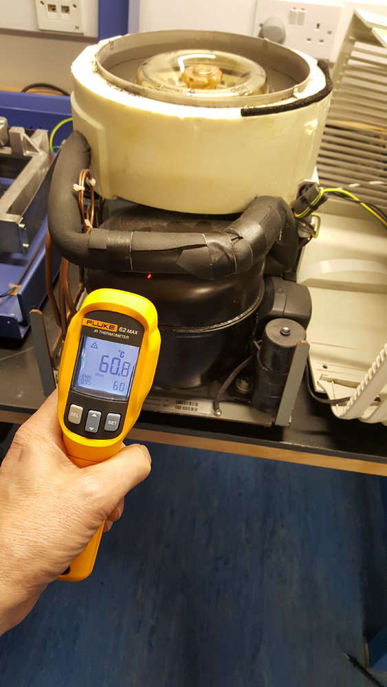

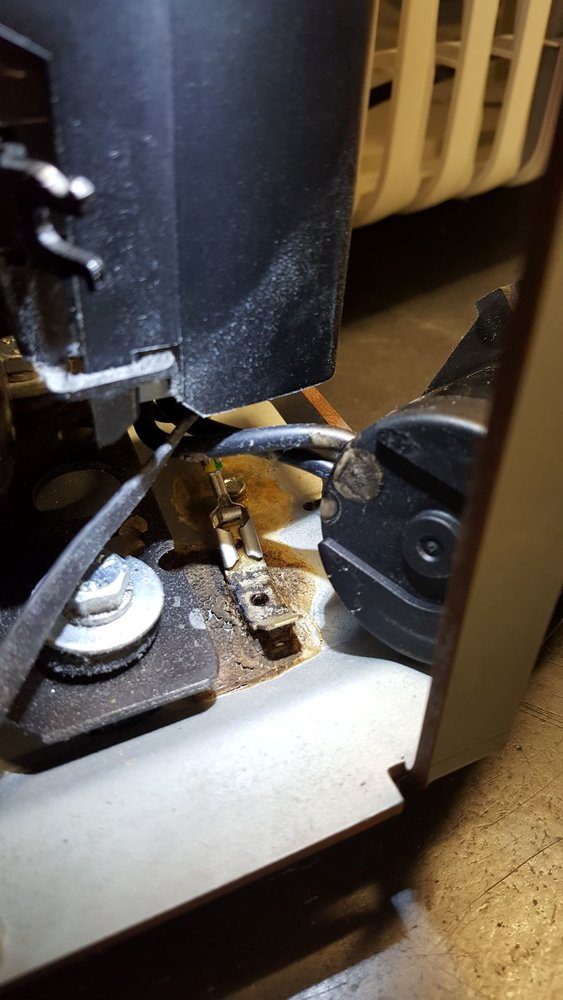

This refrigerated centrifuge is not cooling but the motor/compressor is pretty hot, is it likely out of gas? I can hear the pump cycling on and off every few minutes.
Seems pretty hot but not sure what temp the pumps/compressor normally gets too.
