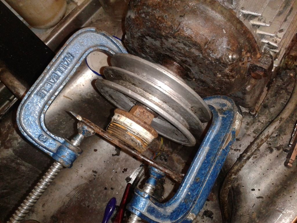

horrible things but get the job done...helps iff you keep the nuts pretty tight on the extending links to stop them stretching to one side as you tighten into the taperFor example -

Iff its to remove the motor pully on your comp then use a bit of heat on the shaft area of the pully to expand it a thou and you should be able to pull that off by hand. Try pulling it with a puller cold and you risk snapping an edge off it![]()
I've learned the hard way with pullers and only buy Sykes now, the difference I quality is emediatly apparent especially in weight and the shape of ends.
I just googles Sykes pullers....
Like i say, the compressor cost me £20. I think the cheapest Sykes unit i saw was £170.
I understand the need for good tools, but there are limits! : )
That said, my current bodge seems to be doing nothing at all (except, that is, for bending the spanner) -
I suspect, more than anything else, the pulley is glued on by years of emulsified vegetable oil.
