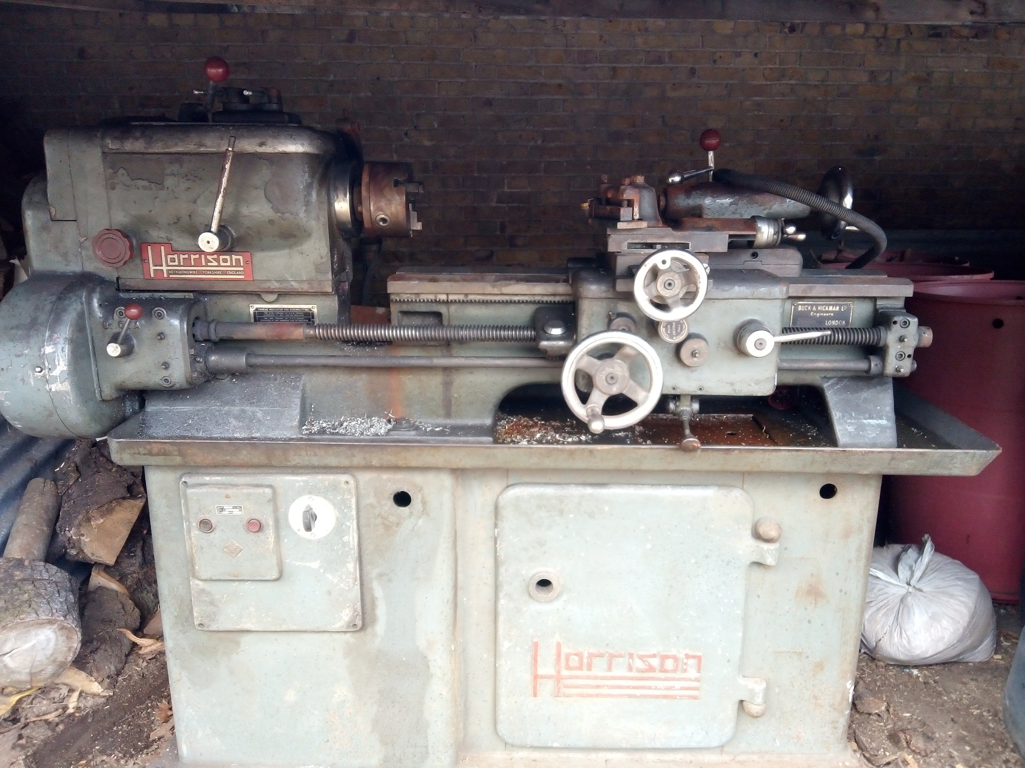

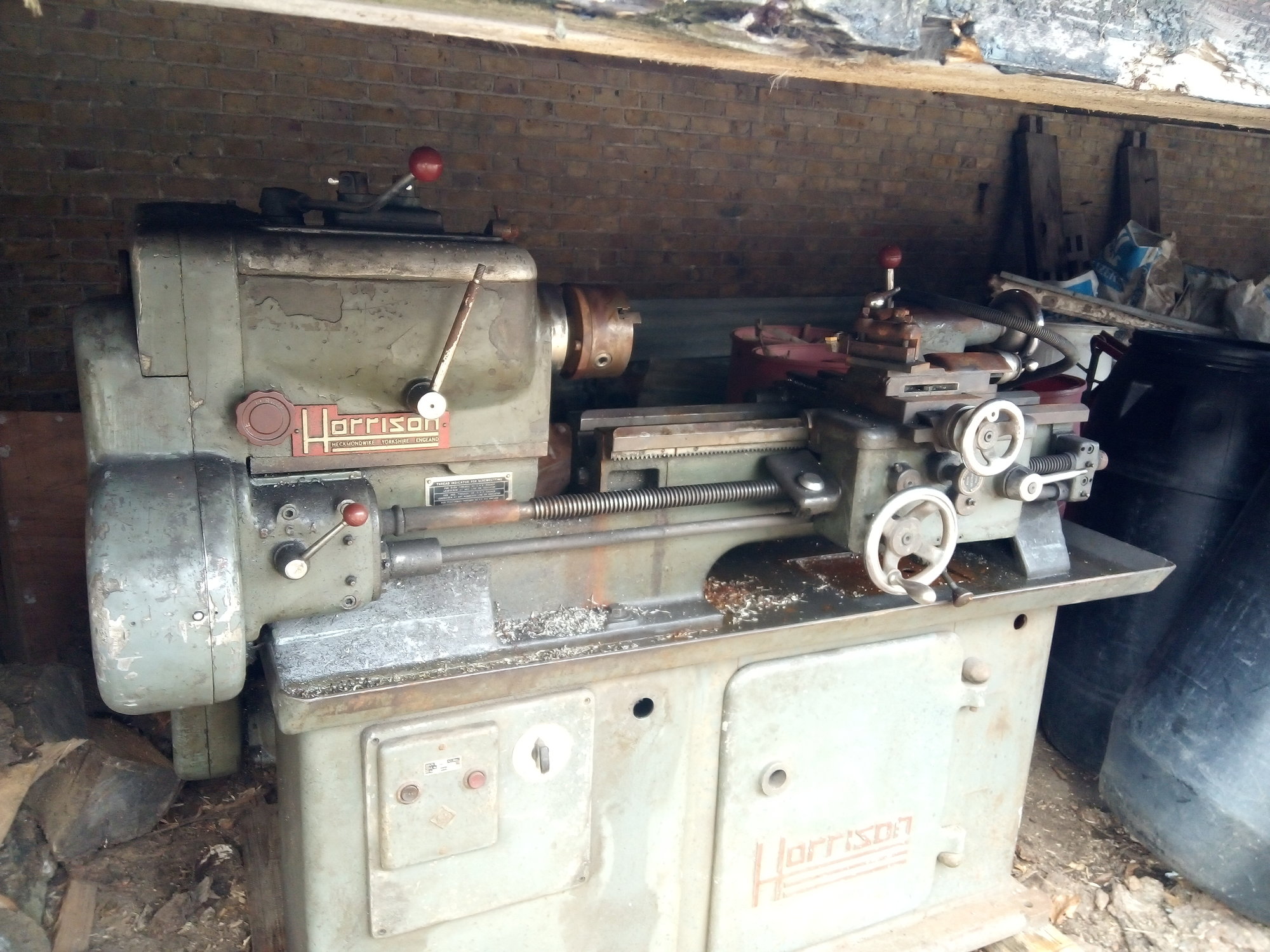

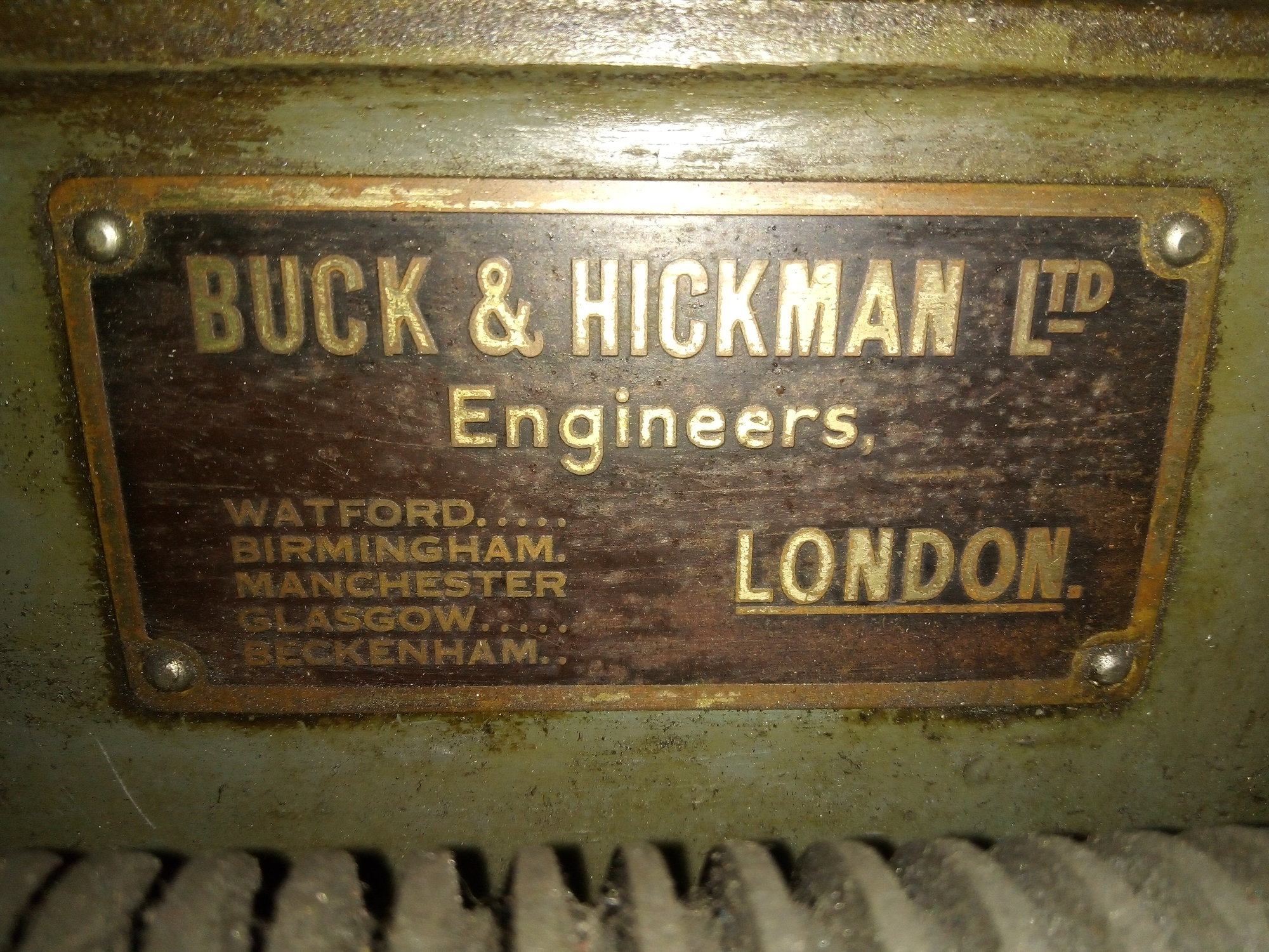

Plenty of help & advice available from the lads & lasses here. A real lathe that's small, not a small lathe that's a toy. Proper machine always liked them, good apprenticeship memories

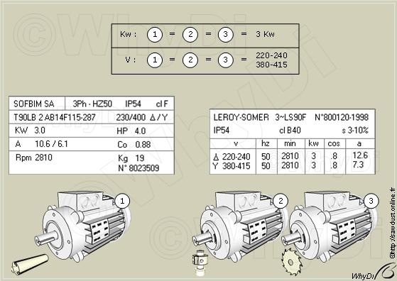

a machine that could serve as well in a production environment as well as a training establishment. Proper cast iron!Can anybody see any issues with me running this on an inverter. It has original 3 phase motor
Don't doubt it but if you can wire it delta for 240 3p(hopefully I've got It the right way around this time)then a 240 1p to 240v 3p vfd is cheap enough to come by. Would need to mess with switchgear as it will only run the motor afaik.It's definitely a 3 phase motor (big red plug)
