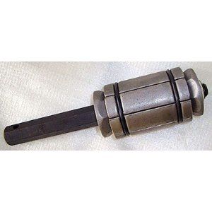

someone has nipped up a clamp outside of the join area on my exh pipe , so its dented it in nicley and stopping the joint slipping together
any ideas ? cant really think of much except chop it off and slice it in 2 , hammer the dent and reweld , then id have trouble cleaning the weld inside properly
