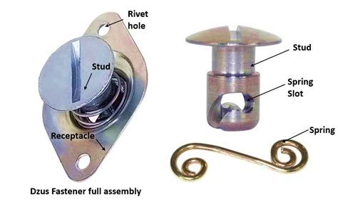

They’re used on light aircraft engine cowlings, they don’t come undoneDzus fastener
Chassis flex.Check crankshaft balancer. Something is vibrating far too much.
And on Chinooks and they vibrate more than a knackered washing machine with a couple of bricks in the drum on full spin.They’re used on light aircraft engine cowlings, they don’t come undone![]()
They do,had them on the parts of my bike fairing that needed quick easy access for maintenance.They’re used on light aircraft engine cowlings, they don’t come undone![]()

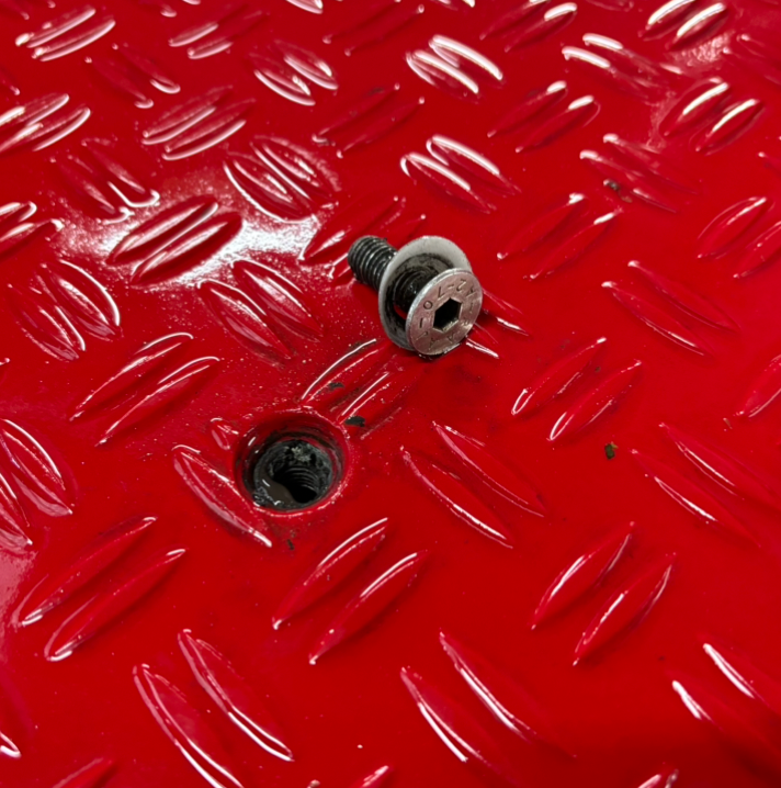

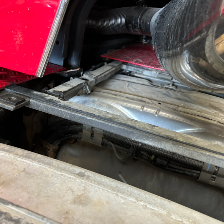

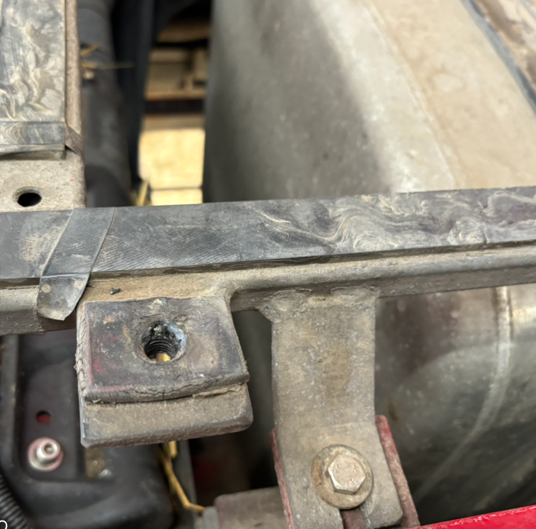

Out of the 12 bolts on the offside only was is accessible from the rear to fit a nut, luckily for me this was the one with the stripped thread!I'd just do the longer bolts with lock nuts on't back..
No , Use a 32 ounce blow lamp heated copper soldering iron , put a heated ready for soldering iron into the head of the bolt and the Loctite will soften for easy extraction. Though that's not often feasible at the scene of the job.Loctite 638 but you will need a grinder to undo them.
AFTERTHOUGHT:-
All these different ideas.
List them in cost,time, practicality, chuck in a hat
Then out the 12 bolts. 4 one idea, next 4 next idea, Last 4 third idea.
