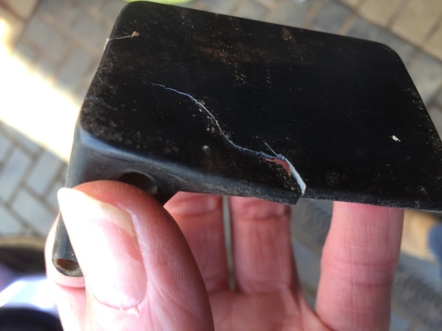

There seems to be a problem on the internal rods, if I put a load of wd40 around the rods they are ok for a few weeks but then the able will stiffen up. It wasn’t a problem until it came back from a garage with a snapped one.If youv gone through a few in the past 3 years you must have a gorilla opening the door
I have a disco and used it as my daily for over a year and none of my door handles are like that
Not with discovery door handlesNo breakers near at hand?

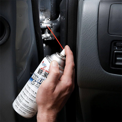

I have moved over to spray chain lube now!bin the wd40 it’s crap
you need spray white grease
Holts Spray Grease 500ml | Euro Car Parts
Holts Spray Grease 500ml at the lowest UK prices from Euro Car Parts UK’s No.1 for Car Accessories, Car Styling & Car Care. Buy today Online, In store or by Phone + Branches Nationwide – Next Day UK Free Delivery.www.eurocarparts.com
Looks like this when on
Thanks, I’ll give that a go.bin the wd40 it’s crap
if it is use lumiweld or technoweld brazing rods. will work a treatMazak/Zamak/pot metal probably. Try a tig on it - surely plenty of used ones on eBay?
