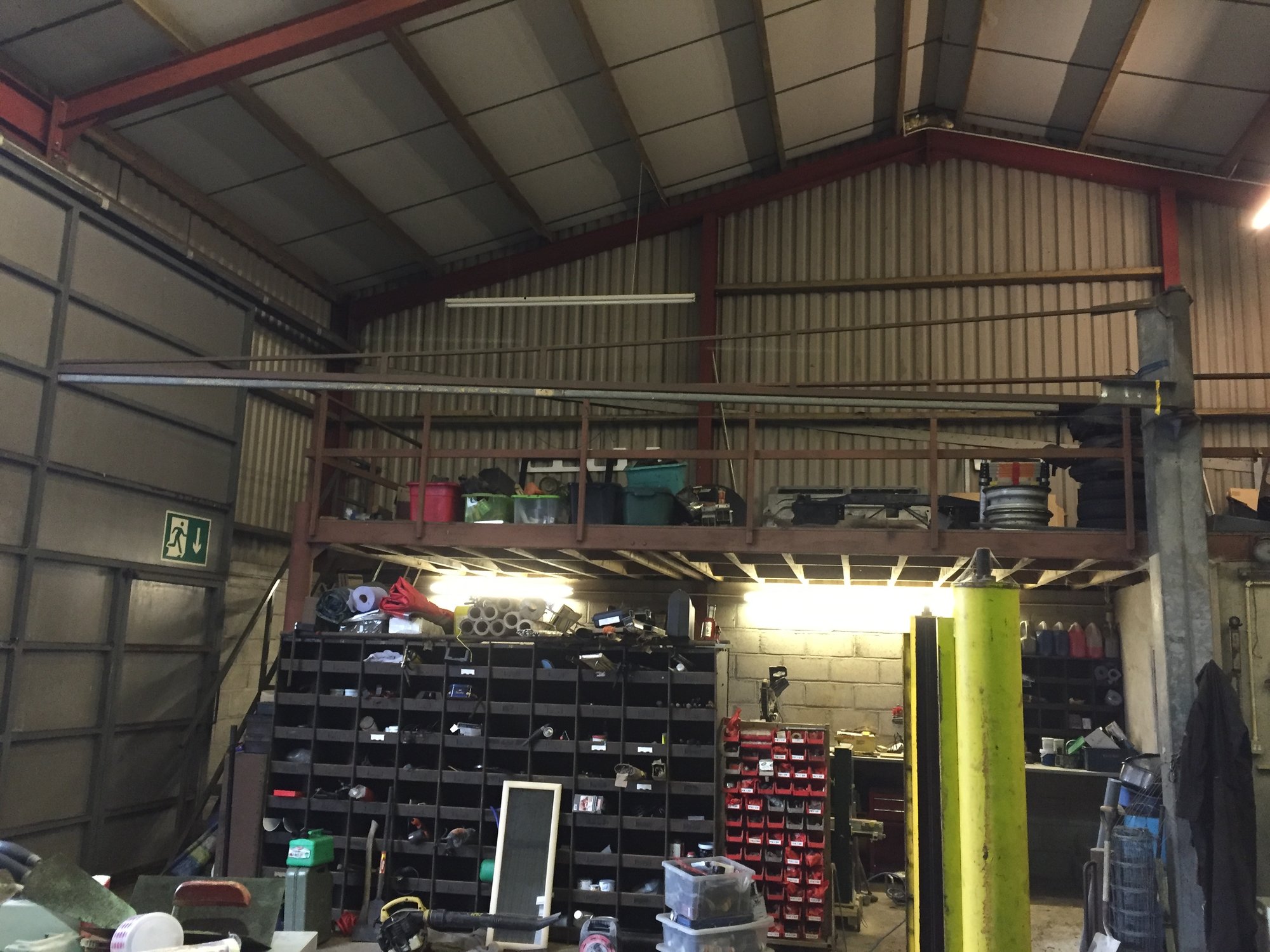

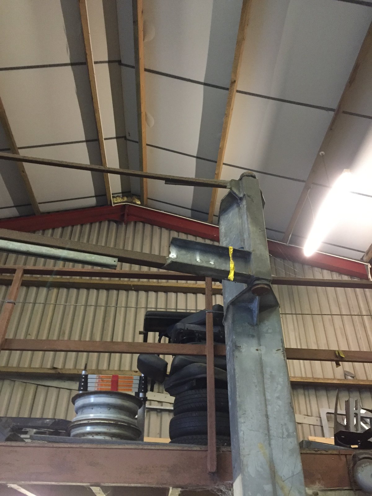

There is a lot of potential in that swing lift, I think the weak links are the floor plate and the galv roller track on the underside of the swing. If it’s bolted to the floor I would be wary of the integrity of the fixings, I would also be looking to tether/bracket the top of the lift column back to the mezzanine floor. I would swap the roller track for a girder trolley and add a few crisscross braces to the top support truss down to the trolley beam, there will be enough room to get these in where the gap is between the girder trolley wheels. I would reckon that @ 250kg if it was sorted, as is nothing.
