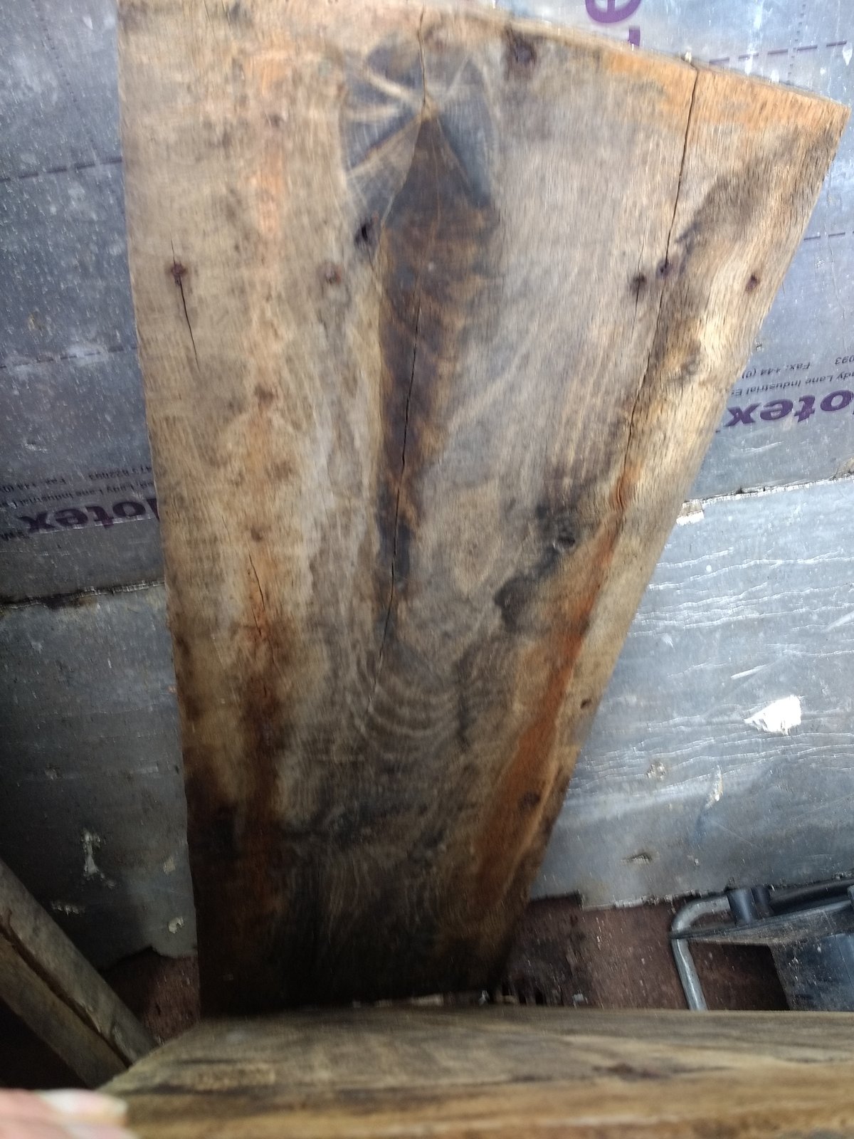

Looks like woodworm to me.

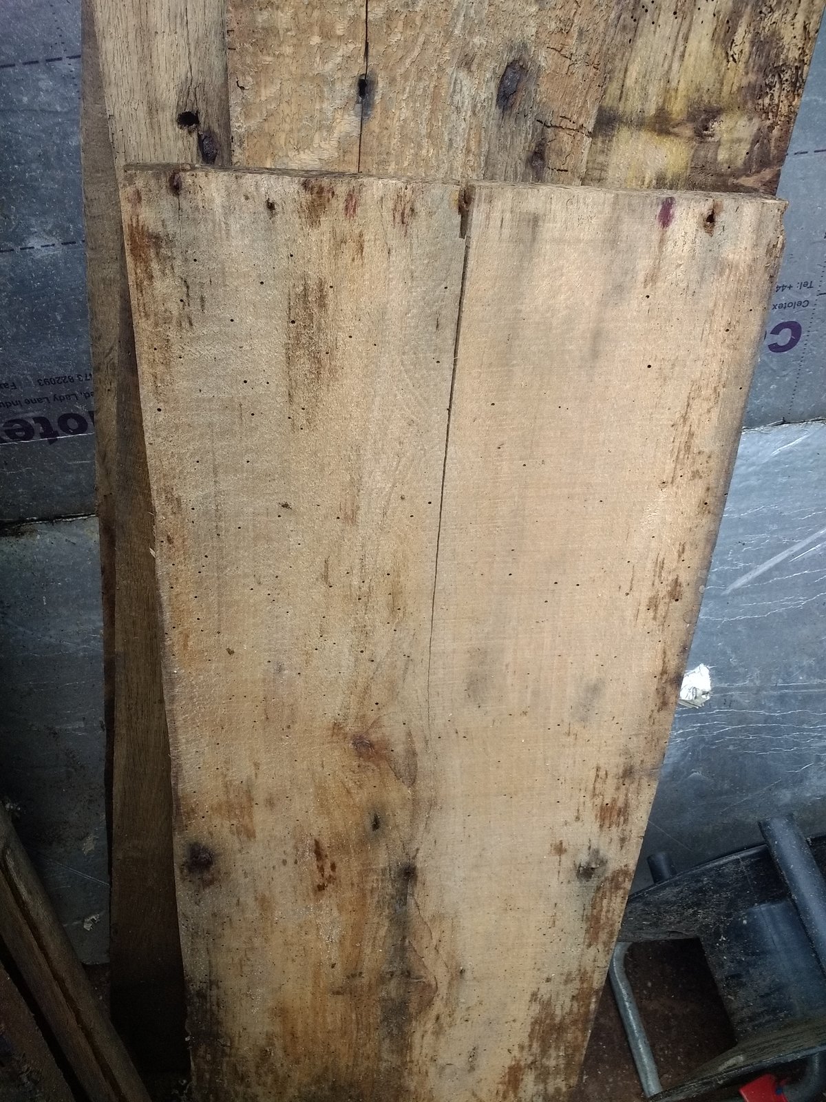

Hi julianf The second of your pics shows Medullary Rays in oak , google medullary rays ,there's plenty of info there , sometimes called Tiger oak , dream up something ornamental to make with it ,or maybe sand and polish a patch first ,so you appreciate what I'm talking about first , there'll be plenty on here who would gladly take that off you. All the Best desmo11225

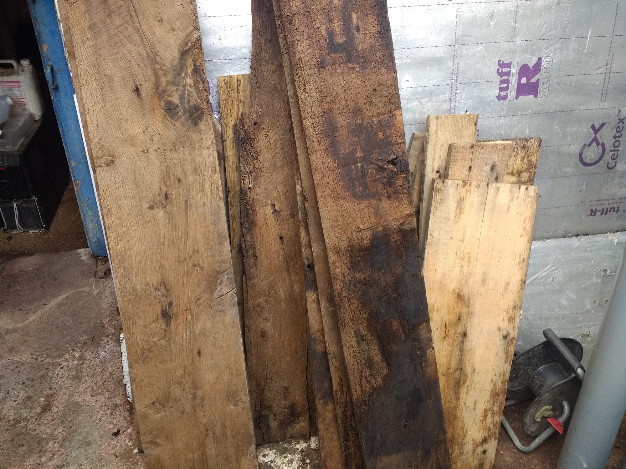

My partner wants a kitchen table to fit with the rest of the place, so that is my intention. But it won't be for a while. At present I'm just putting these into storage as I need the yard clear for some other works.
I have the joists that they came off for the legs etc. of the table too.

If you look at Julian F's second photo down you will see splashes of lighter colour across the grain of the timber, these are what is known as medullary rays & show up on the surface of the wood when the saw cut is at a certain angle to the growth rings of the tree. They are typical of English oak.
Elm dos not show these & has a pinkish tone as in seadogs photo.
Spray the oak with a decent wood worm killer so you don't infect other untreated stored wood ,My partner wants a kitchen table to fit with the rest of the place, so that is my intention. But it won't be for a while. At present I'm just putting these into storage as I need the yard clear for some other works.
