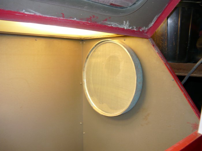

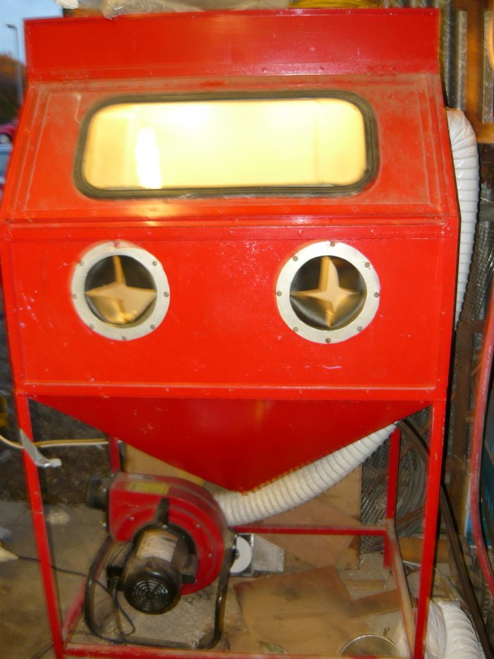

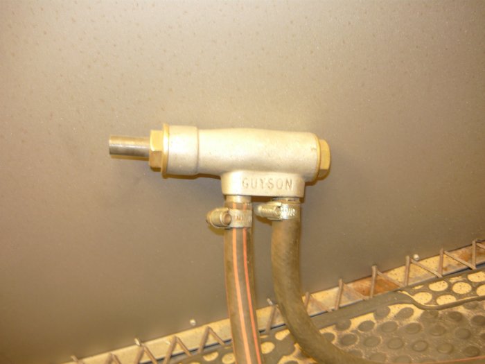

the filter ring is a base of a gas bottle .filter from hardware shop of frying pan with handle cut off . the suction gun i cast in aluminium of an old worn gun machined the brass fittings and made and hardened the jets. its lasted a lot of years with a lot of use the fan is a woodchip dust removal fan bought for 20 quid
