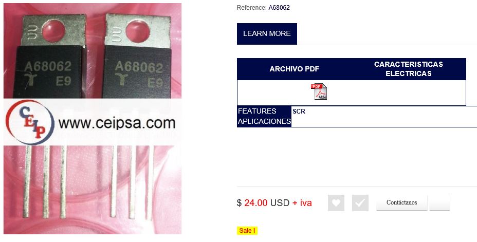

I have removed the board from the speed controller housing and have found a transistor like device marked A68062 MEX T (which looking for the details on the net seems to be a Teccor brand TO-220 cased rectifier) but the details of which are quite scarce and I cannot find out much more about it.
Does anyone know if I can source a different Rectifier to replace this item? I think it popped as a lot of the metalwork in the garage has condensation on it and I think the inside of the controller must have been damp to cause it to track across the terminals and pop. There is also evidence of rust on the mild steel heatsink bar screwed across all five devices (2 of which are marked SCR 1&2 and 3 are marked D11-D12-D13).
contact a few places and look for a newer equivalent, it seems those are obsolete when I searched for them couldn't even find a data sheet
