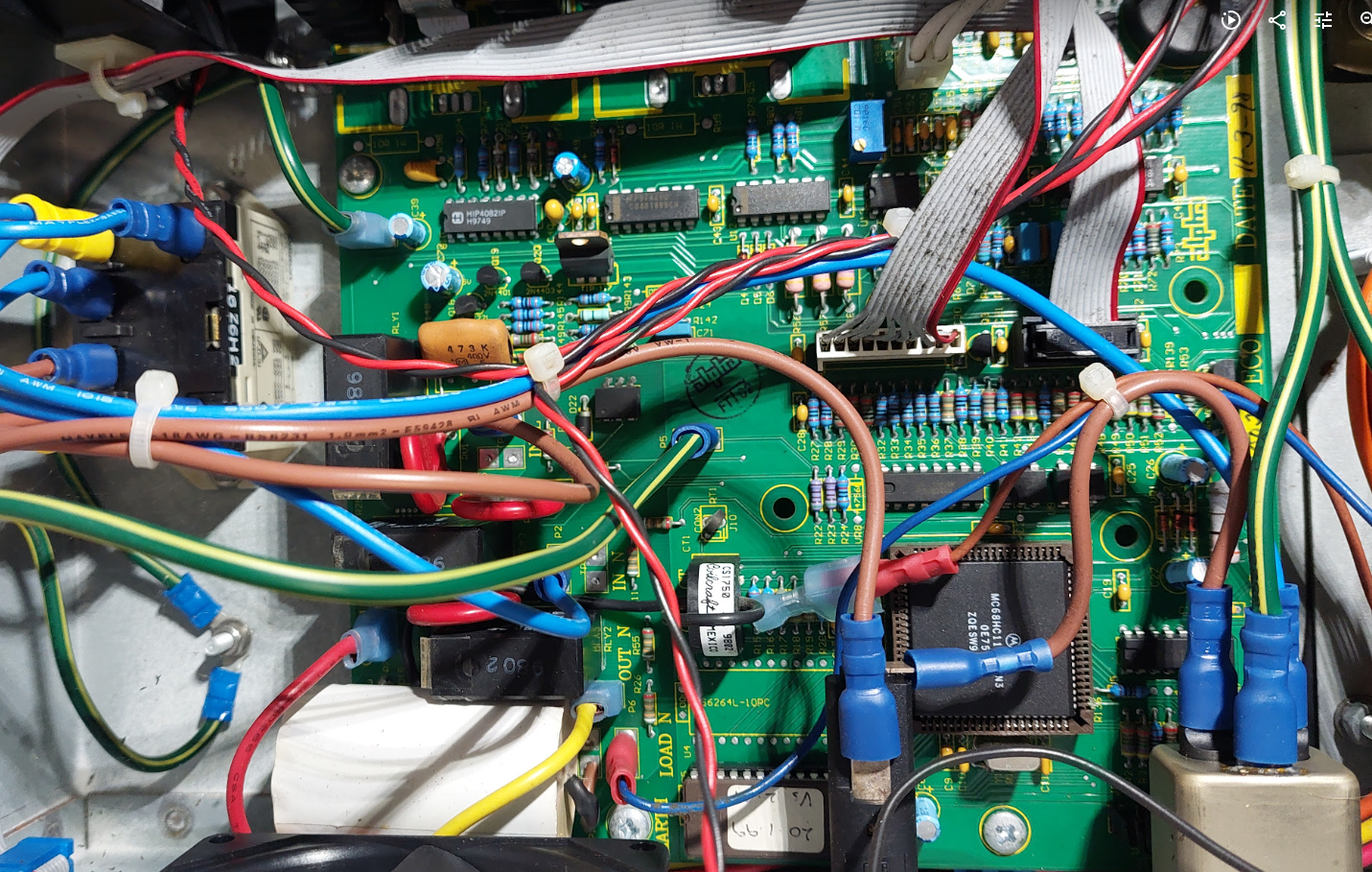

I've had an old UPS in the workshop for a while to keep some critical things powered up, but it died a few months ago, and I've only just got around to having a look at it.
Initially it tripped the main RCD a couple times, and having identified the UPS was the problem, powering it back up resulted in a bang and spark from within, and it blew it's 13A fuse.

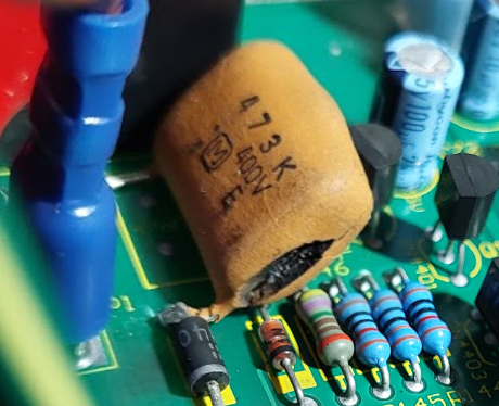

I've just got around to stripping it, and the only thing I can see is what I assume is an old ceramic capacitor has split -
(split isn't visible in the pic, but it's split up the lower edge)

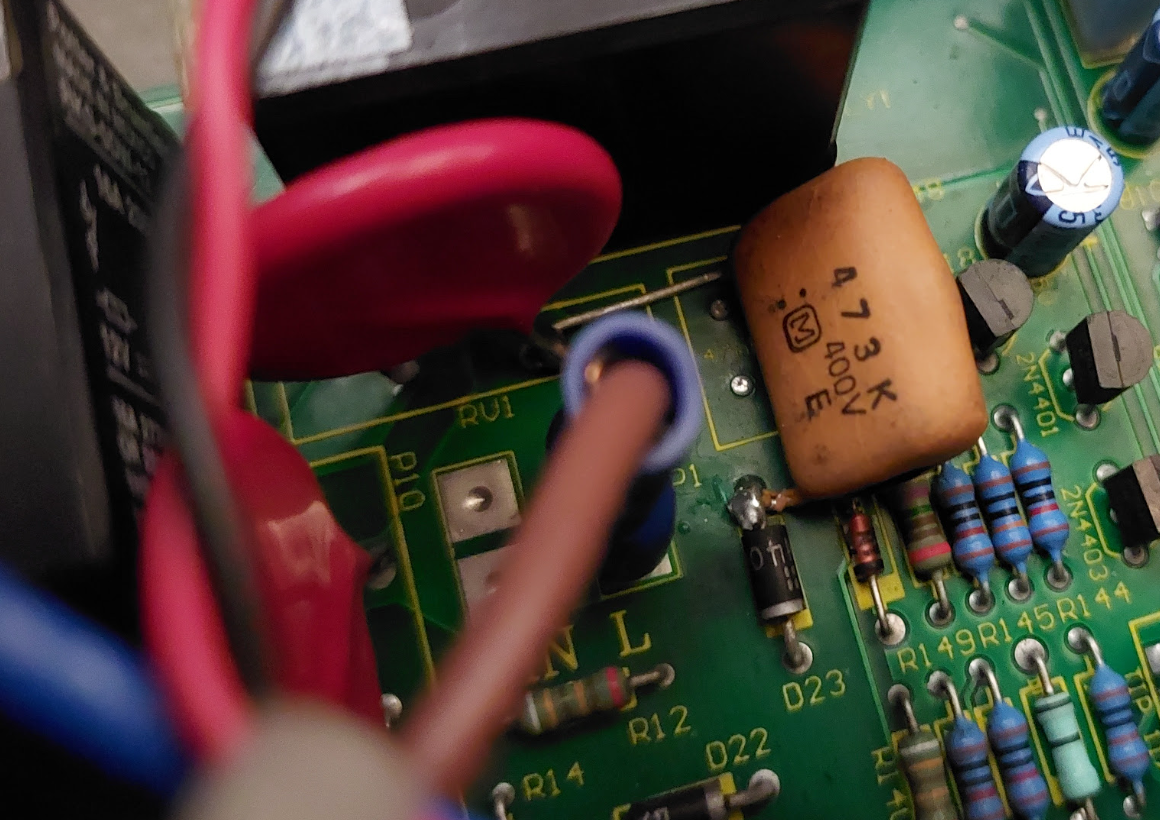

It goes between the leg of the diode, and the thermistor/surge limiter leg.
There is 47nF written on the silkscreen, but from what I know about capacitors, that isn't a 47nF capacitor.
I've not traced the circuit at all yet, but is it likely to cause any short term issues to just cut it out to check nothing else has been damaged?
Also, any suggestions for a suitable replacement?
