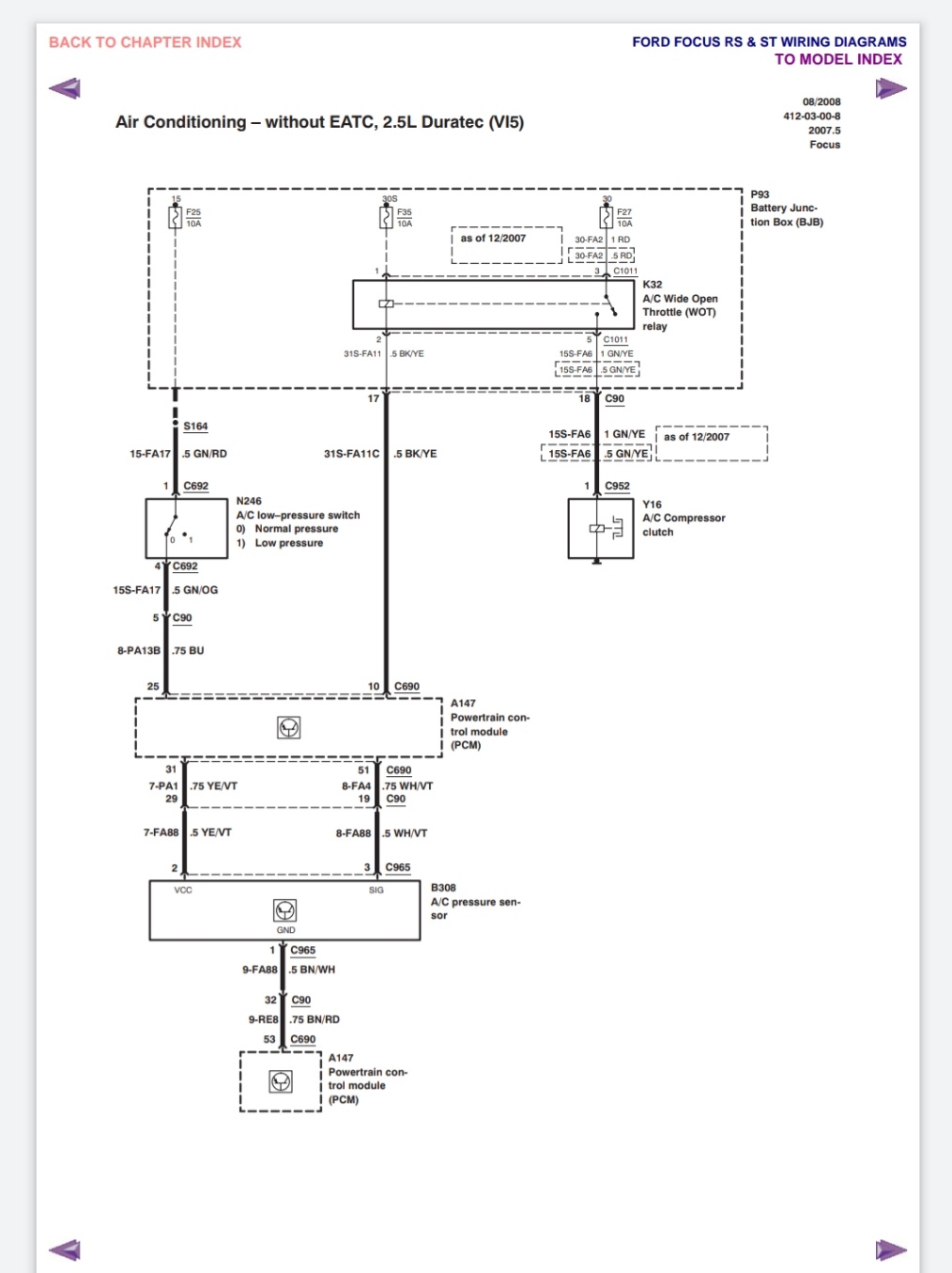

Know there's a good mix of trades on here just wondered if there's any auto air con techs on here with first hand experience of working on Ford PCM controlled air con, that would be willing to give their opinion on an air con problem, tried everything I can think of, and that I have read up on, but still no luck with getting the compressor to come on with the air con button.
Can post detailed diagnostic process covered so far if there are any on here.
