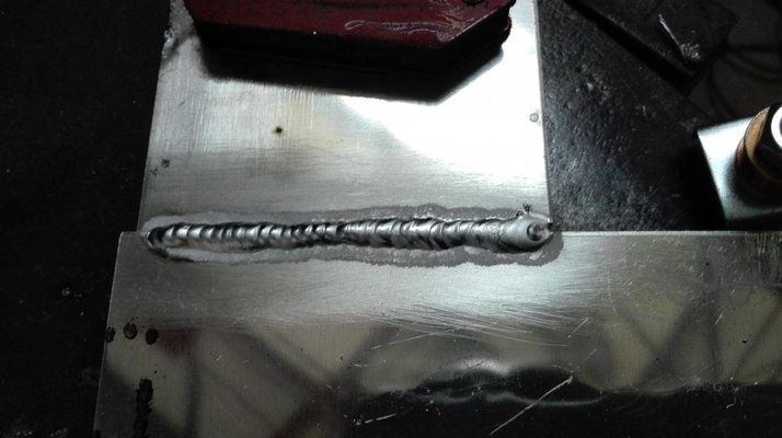

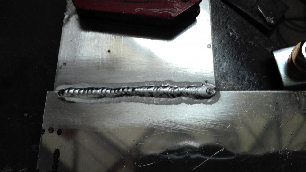

Hi,
Yet another tig newbie here. Been toying around just trying to get used to the technique and trying to find a comfortable position.
Took some pictures of a couple of beads I've ran and would be nice to get some feedback on how I could improve it, whether it be any error in technique, settings adjustment or whatever.
So for the spec, I was welding on 2mm aluminium sheet, cleaned it up with S/s wire brush and acetone. I was using a blue tip 2% lanthanated 1.6 tungsten and a 1.6 filler rod to match. Gas flow is around 7lpm and using a standard no5 cup. Set the amps to max of 85 and controlled with foot pedal. A.c. balance was 35% and a.c. freq was 120hz
