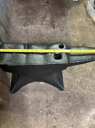

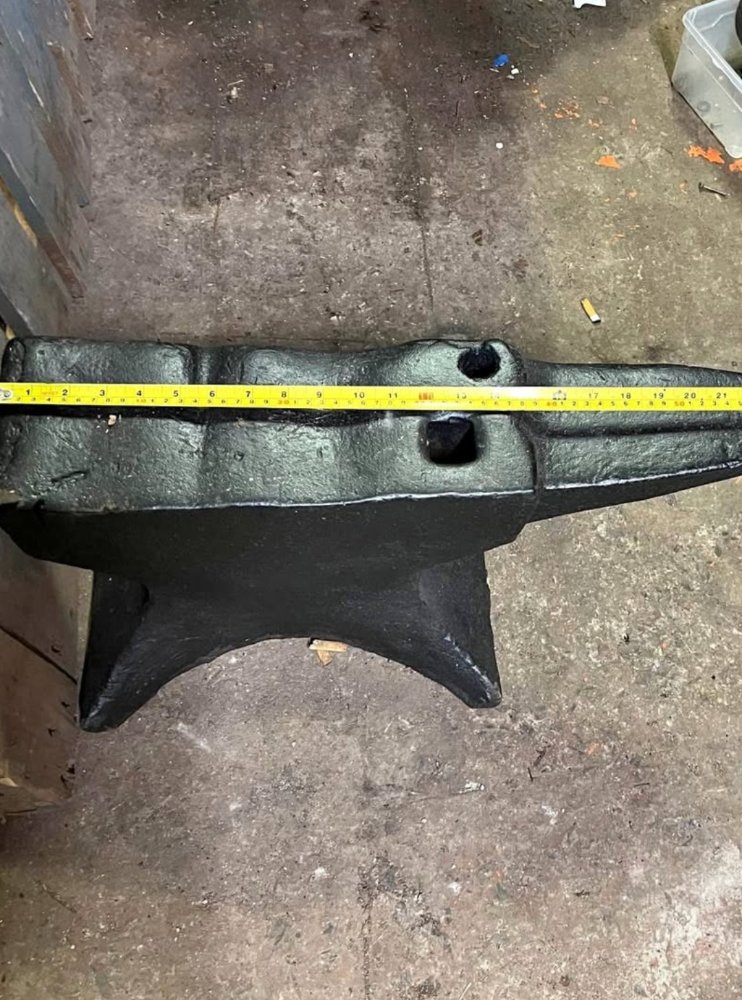

So I might be looking at a couple of anvils over the weekend, what do I need to look for in the way of condition? I'm not a blacksmith but don't want to end up with something that's only good for a garden ornament
