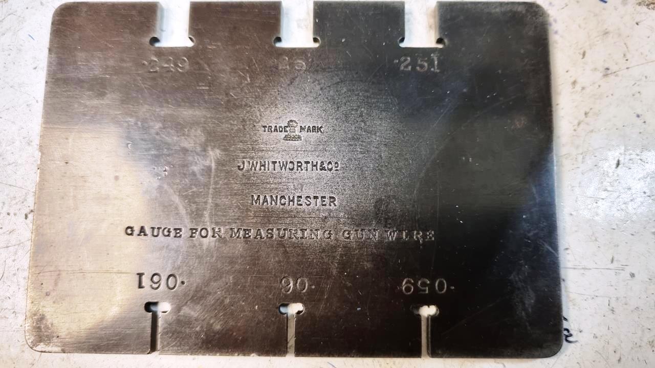

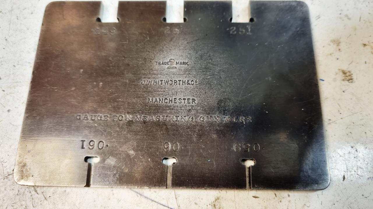

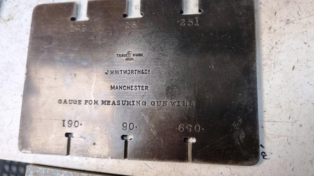

Is it like a gin trap that's got nothing to do with gin?My point exactly Pete, Neither I nor any of my colleagues have a clue!
Wire was wrapped around the rifled liner of battleship guns. Rectangular wire, wound under constant tension. Kilometers of wire.Gun wire was used for breech reinforcement of built-up guns, Invented by the French in the mid 1800's, some of the guns in the forts around Verdun (before they were taken out to be used elsewhere) used it.
British Naval guns began to be manufactured using it also around the same time in Liverpool so possibly the wire works in Manchester were suppliers?
