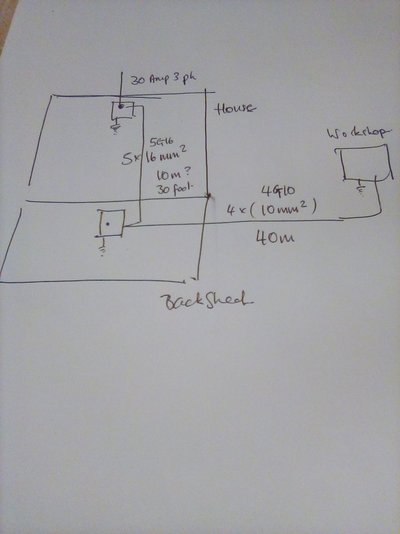

30 amp 3 phase comes into house to first distribution box.
8.5 metre run 26 foot? In 5g16 to second (main) distribution box.
From here I foresee a 40m (120 odd feet) run of 4g10 to the workshop
and earth it in the workshop.
I'll only use one welder at a time, or the lathe at a time, I've 50m of 5g6 i normally use for my welders, and my lathe runs happily off this too.

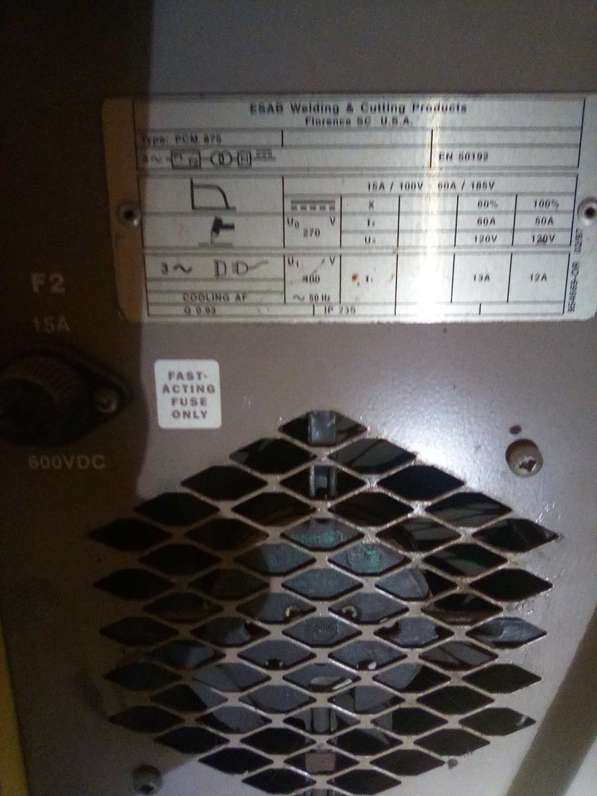

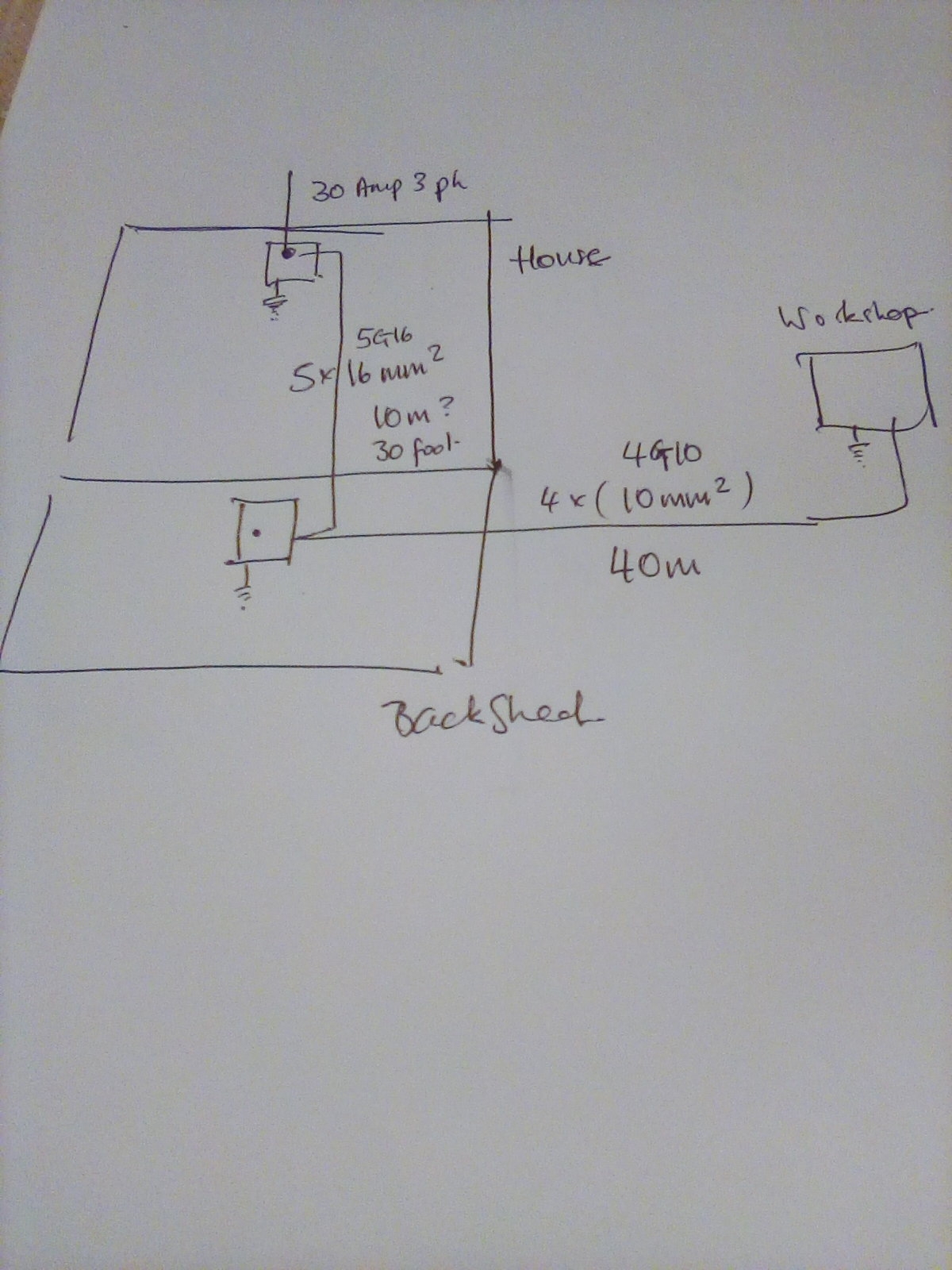

If I have a 3ph compressor and my 3ph plasma going at the same time is it going to go pear shaped?
It's a normal industrial 3ph type compressor, not here so can't get The data.
The plasmas this:
Little sketch:
