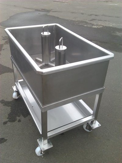

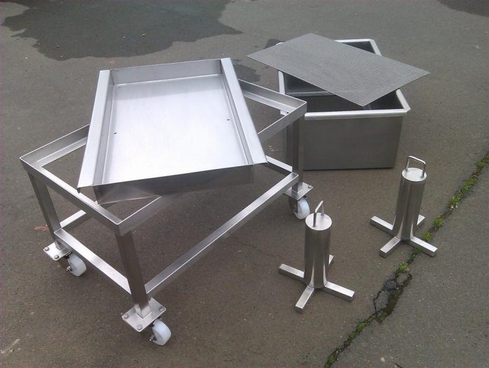

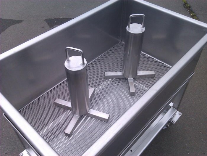

Another blade handling trolley, this one is for a dicer that has cylindrical blades that I'm told cost around £7000 a piece and has about 70 razor sharp edges on it, the upper tray is for the sharps and the lower for the various brackets and fixings that come off when the machine is cleaned and serviced, the trolley breaks down for cleaning,

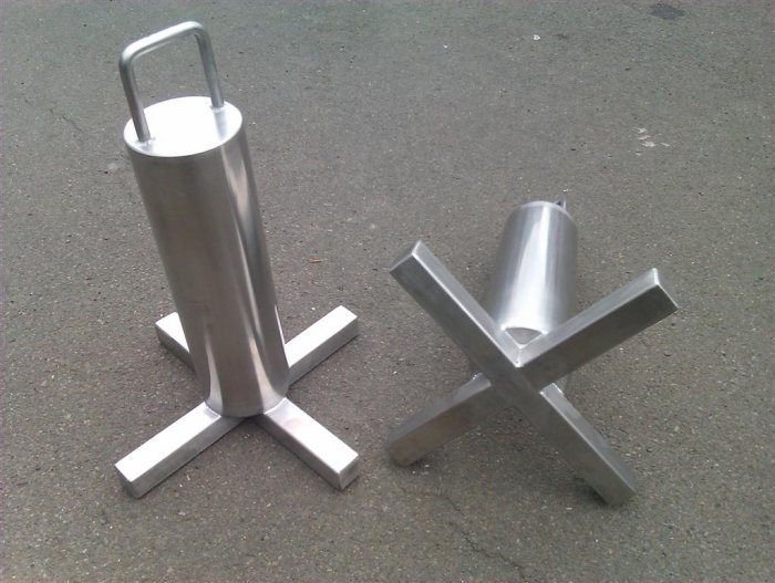

The 2 carriers slip through the blades to enable them to be carried safely.
