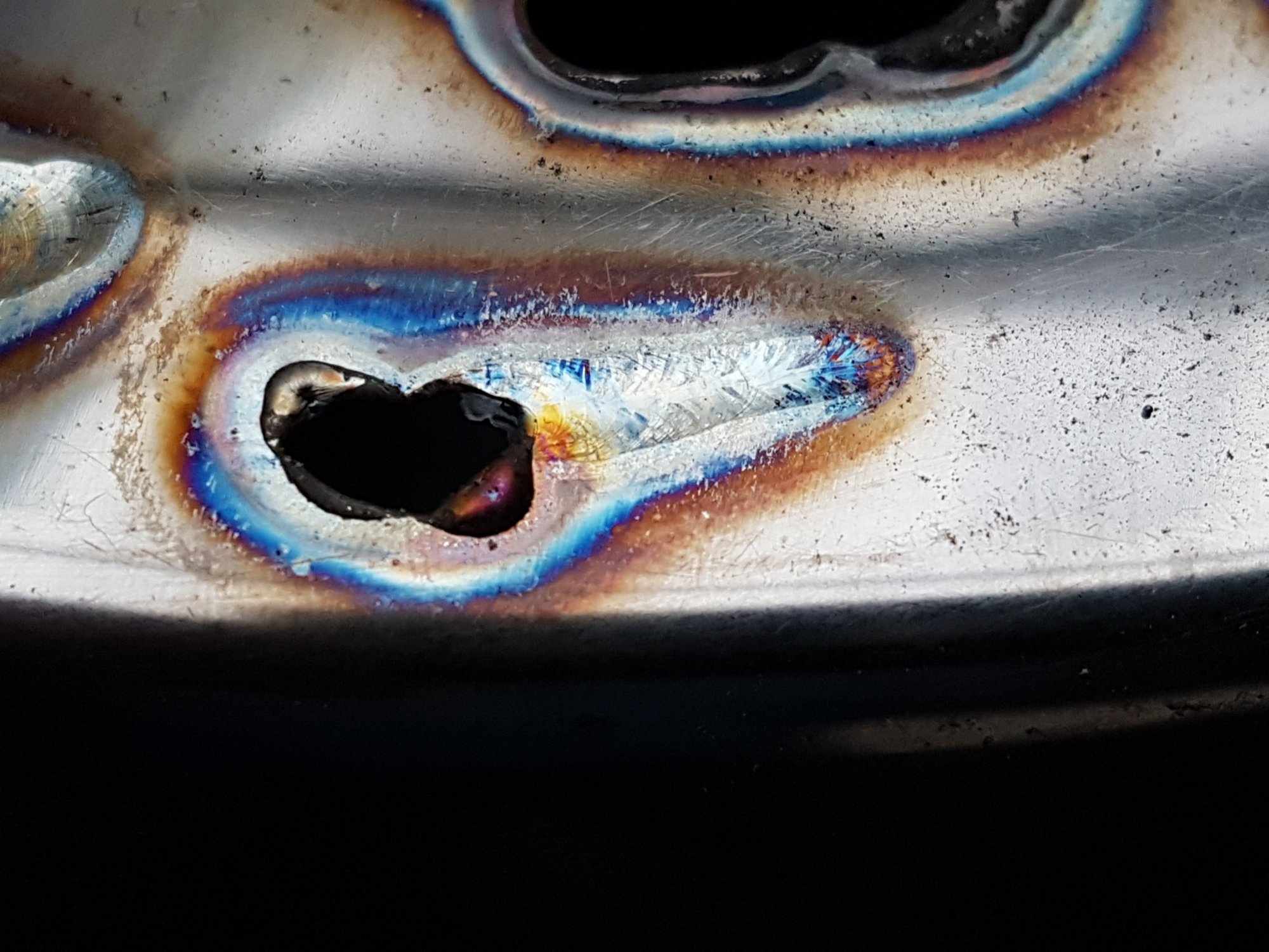

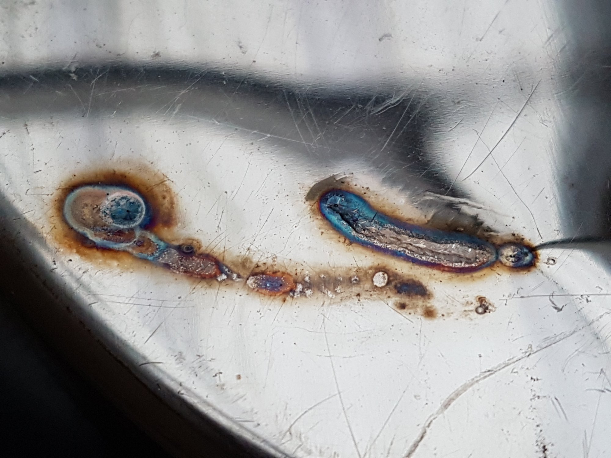

After fixing that, I got this:
This was on 0.8mm stainless at about 20A. I knew it was very thin for a first go but just wanted something to go through the motions on and it was the only bit of metal I had that was already clean. I just wiped it with IPA before welding. Is that likely to be enough if there's no paint/grease/rust to start with?

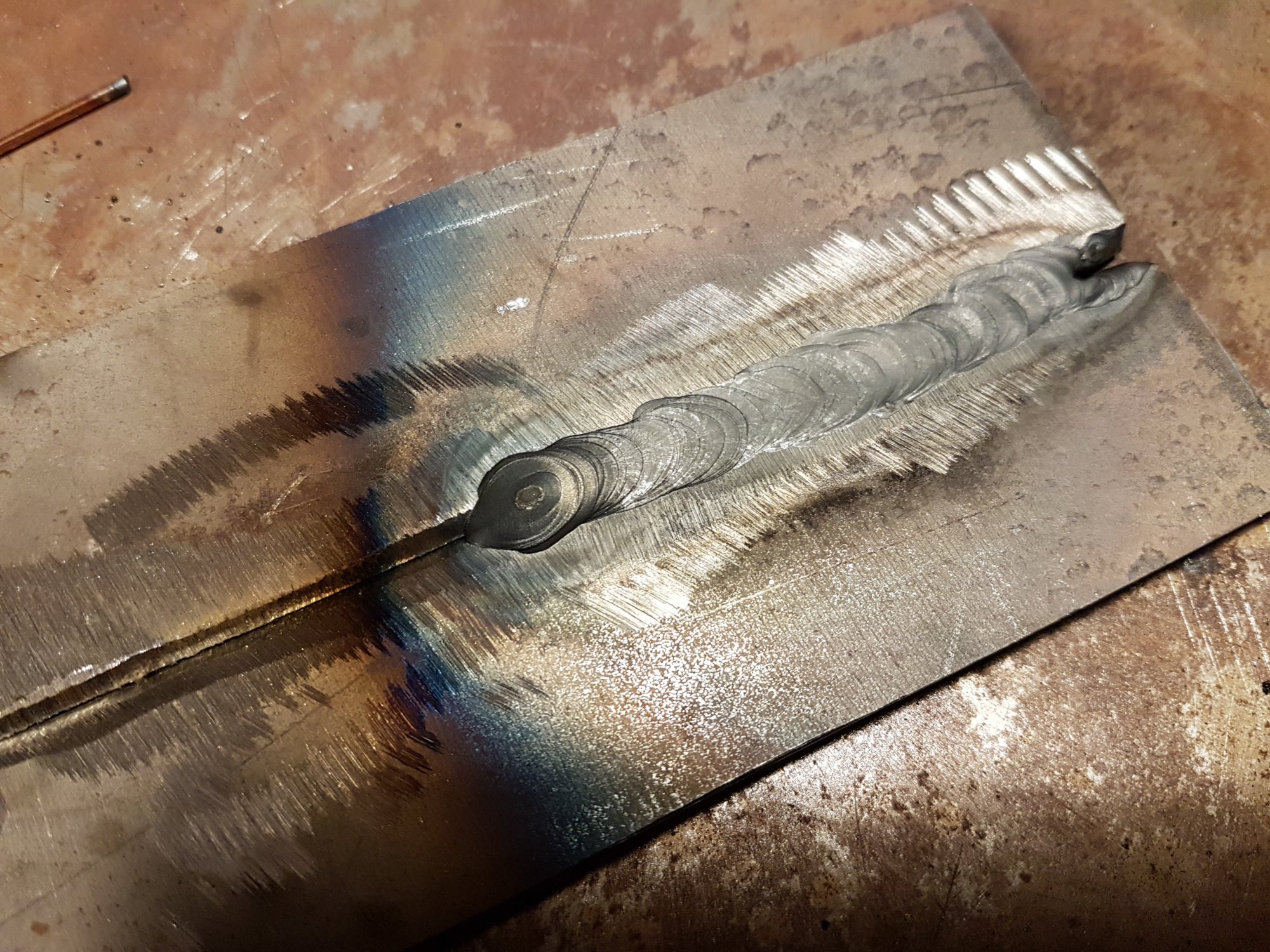

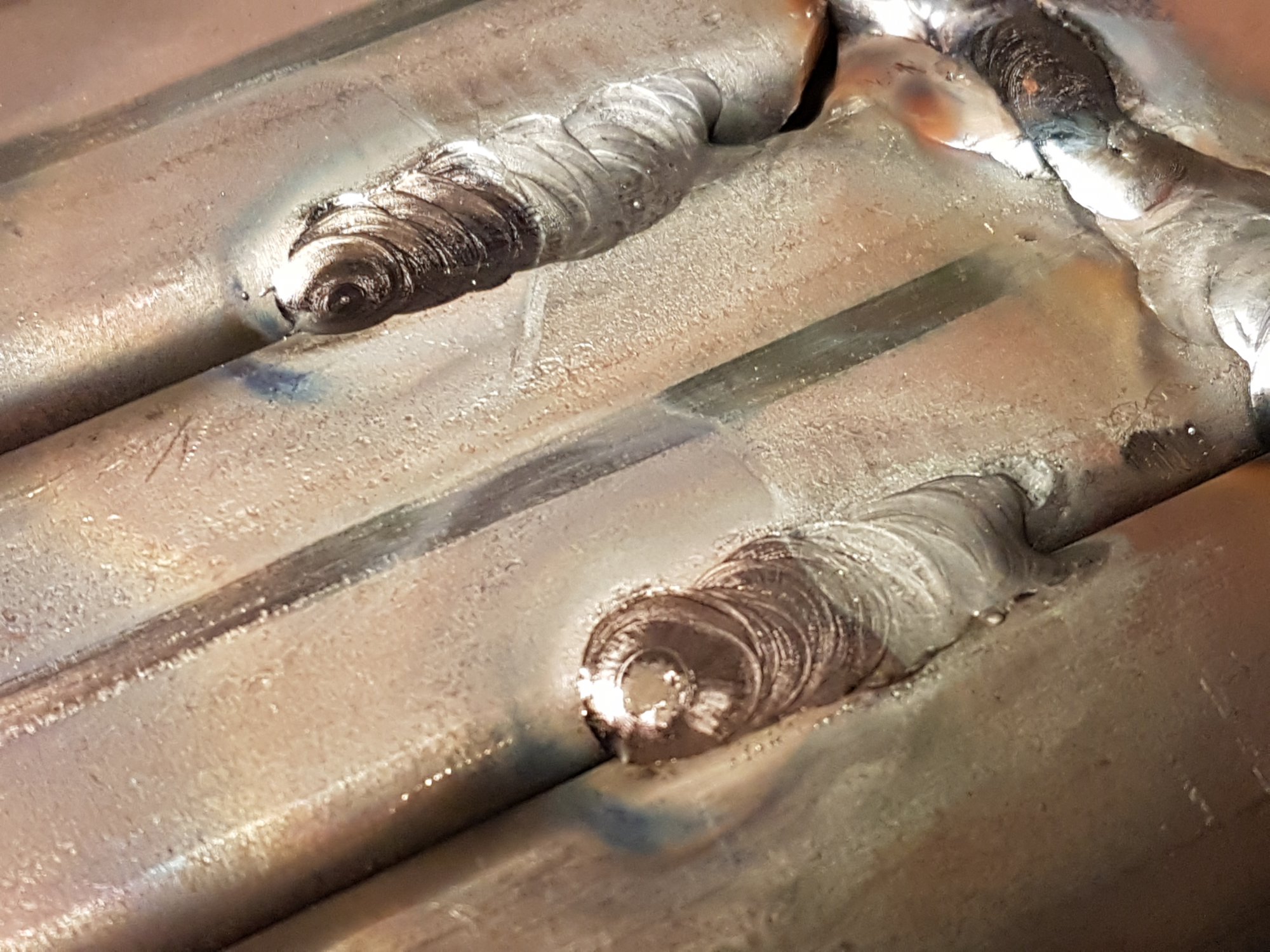

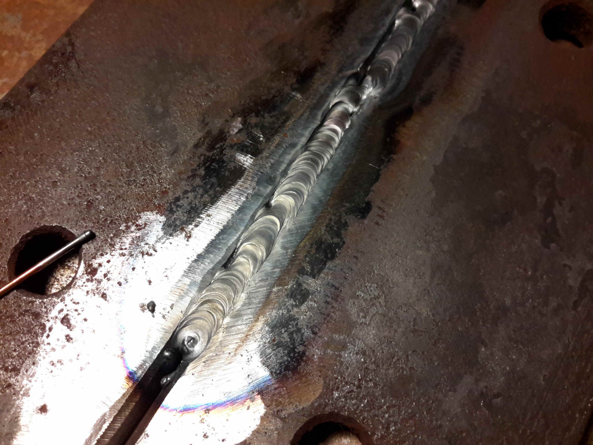

Day 2 attempt was laying beads on 6mm stainless:
I'm guessing I had the torch too high. On the mirror stainless I could see a reflection of the tip, on this it wasn't so clear.

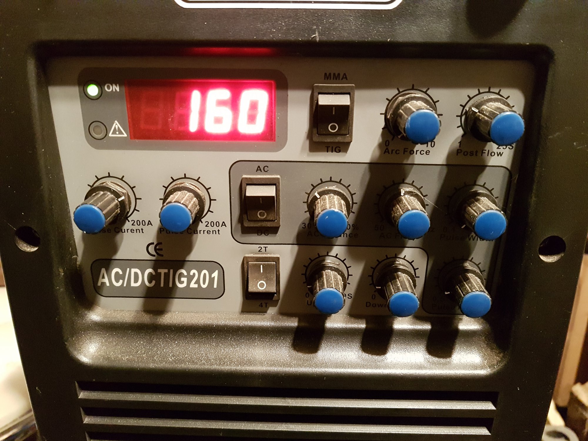

This was with 160A DC. these were the settings:
For steel, do I only need to change the amperage as I change thickness?

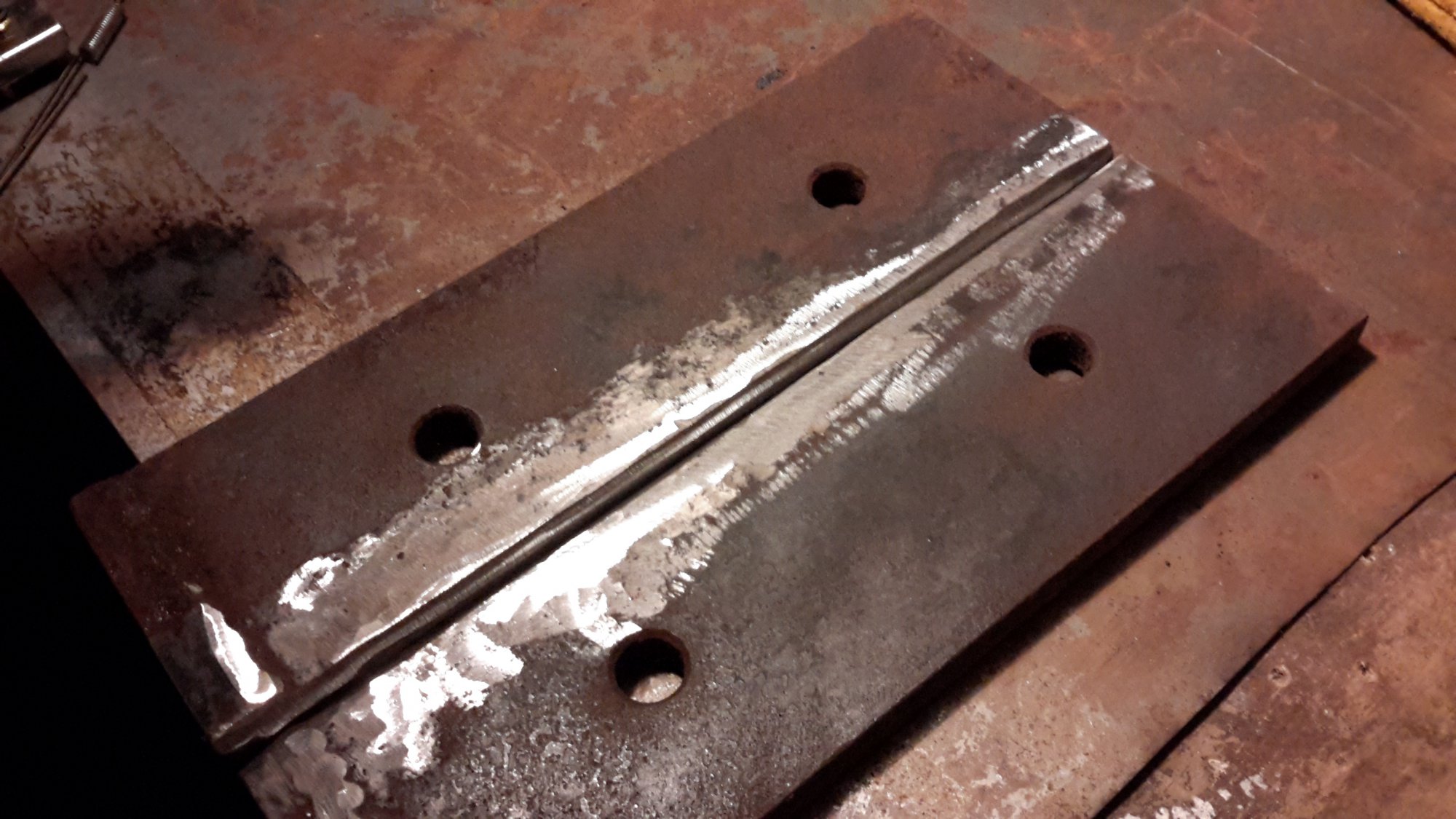

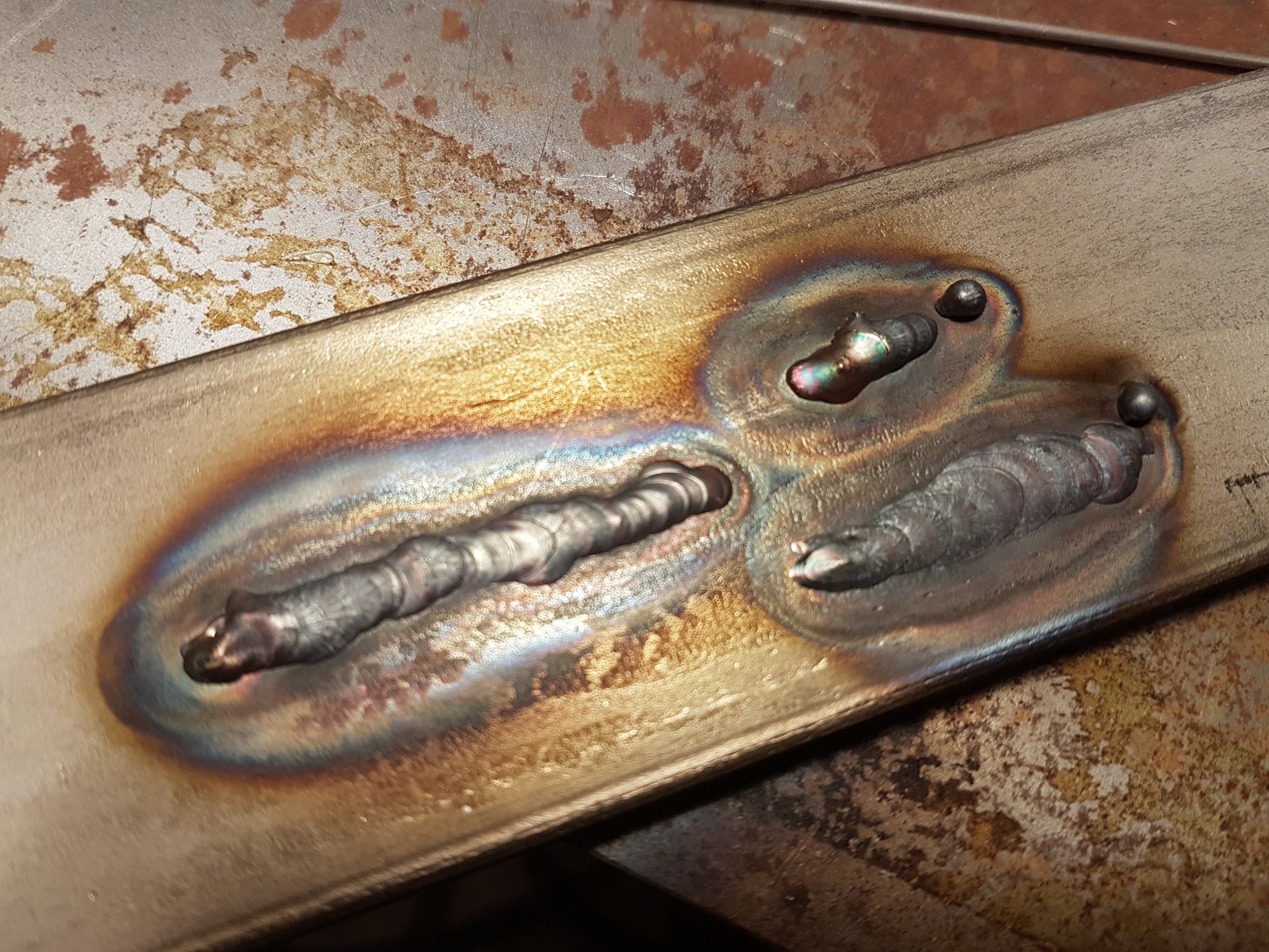

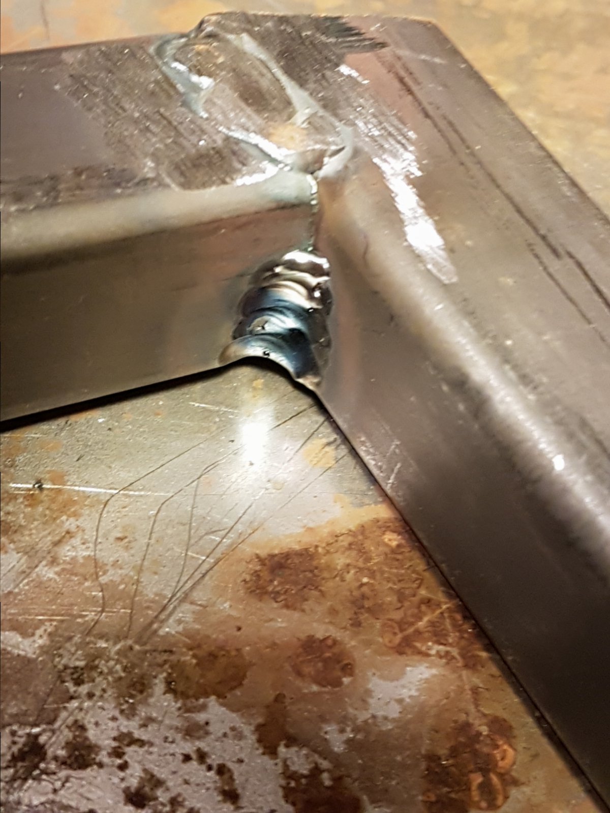

3, butt joint in 12mm mild steel. This was rusty as hell to start with so it took a fair bit of grinding back. I added a 4mm chamfer and space the plates slightly. It may be a bit difficult to tell from the photos but is this surface prep sufficient?
Welds:
Ignore the divot right at the end, I had a breaker trip, so gas, arc and lighting just cut off abruptly.
To me, these welds look better than the beads on stainless but clearly I need to work on my speed and feed.

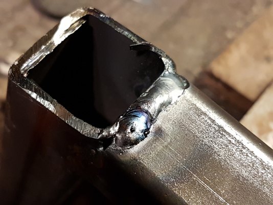

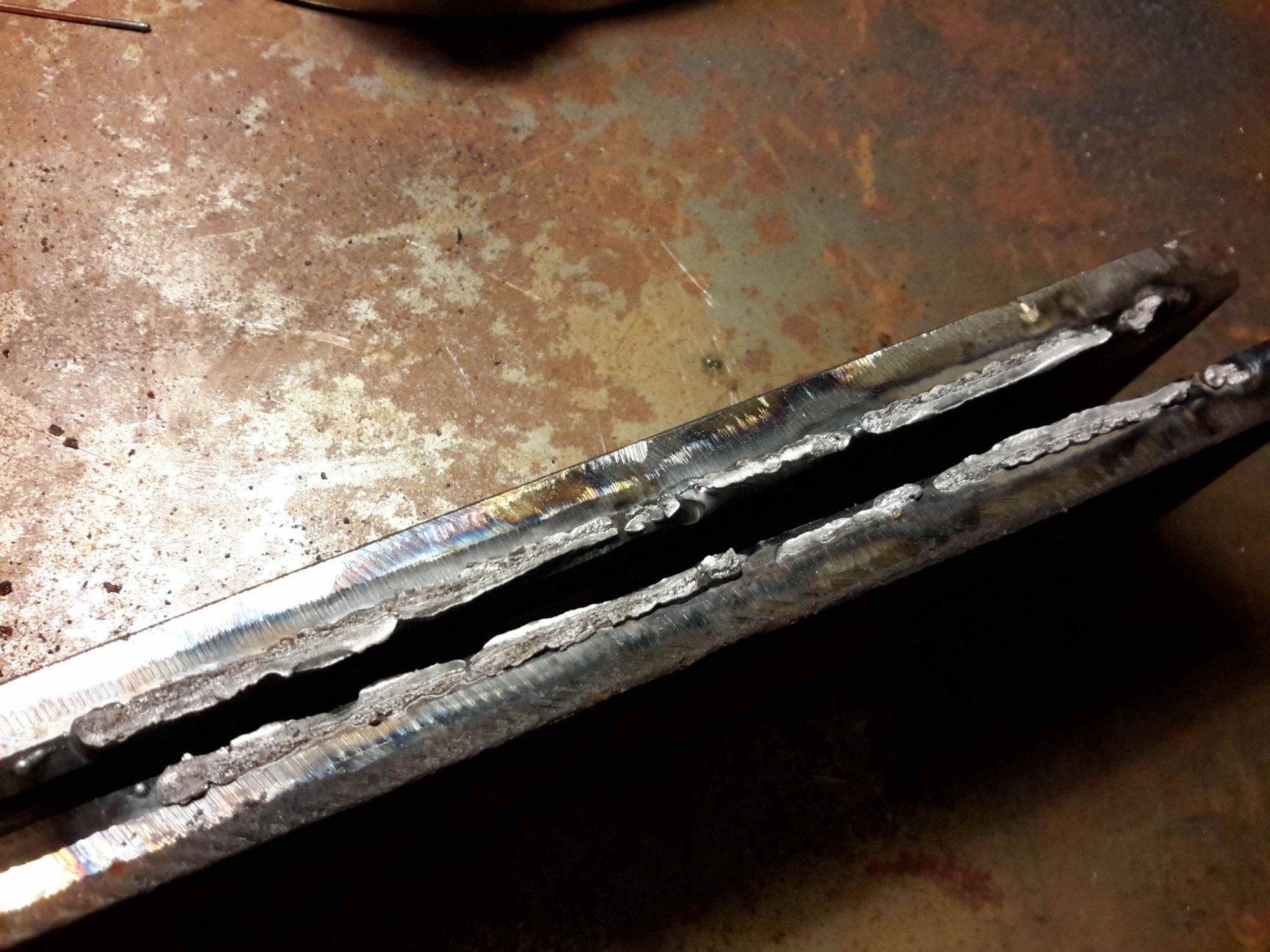

With some effort, I broke the weld to check penetration:
Bugger all. The welds were well stuck, just only ~3mm deep. Do I just not have enough current for this thickness or am I doing something wrong?

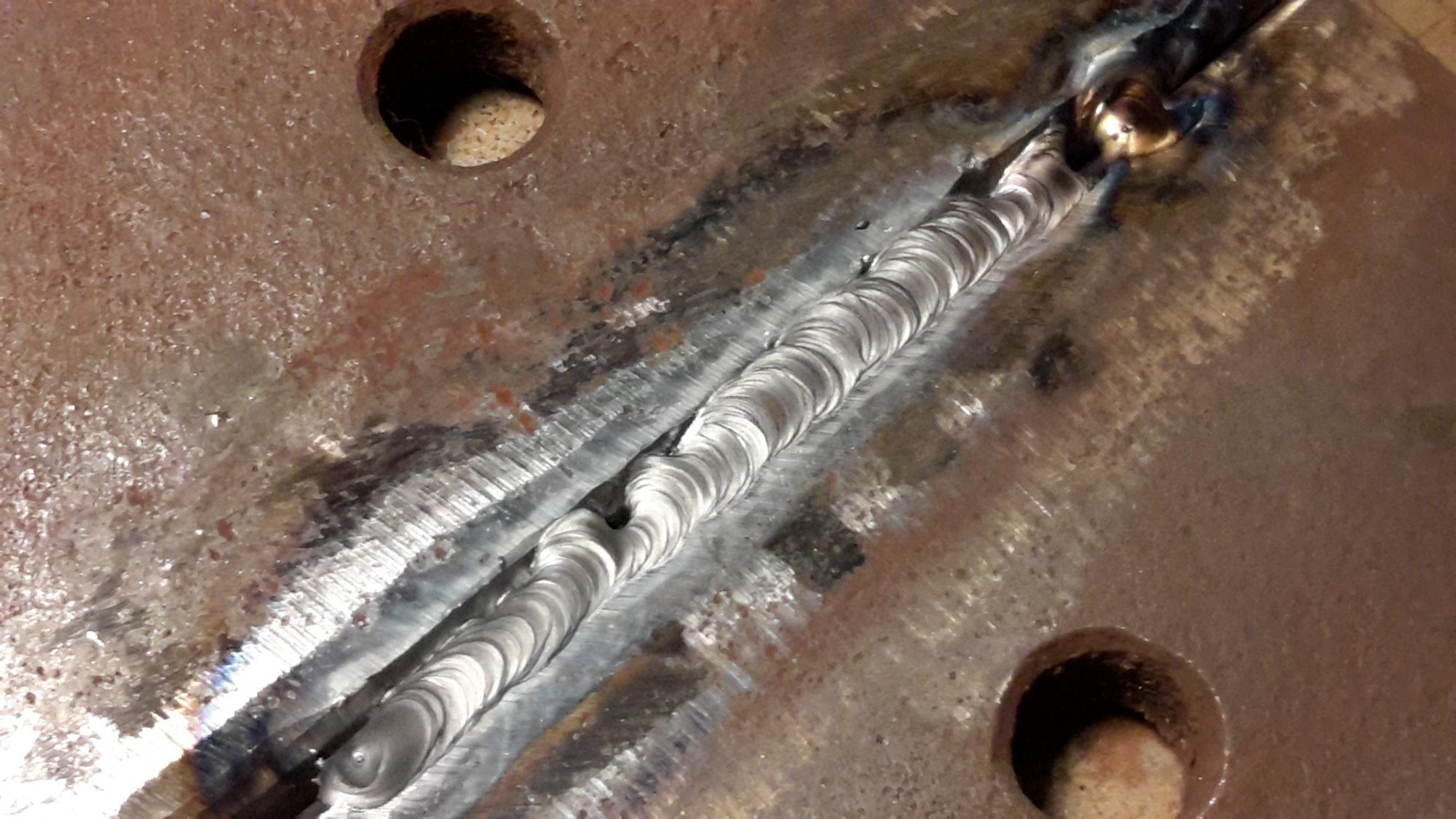

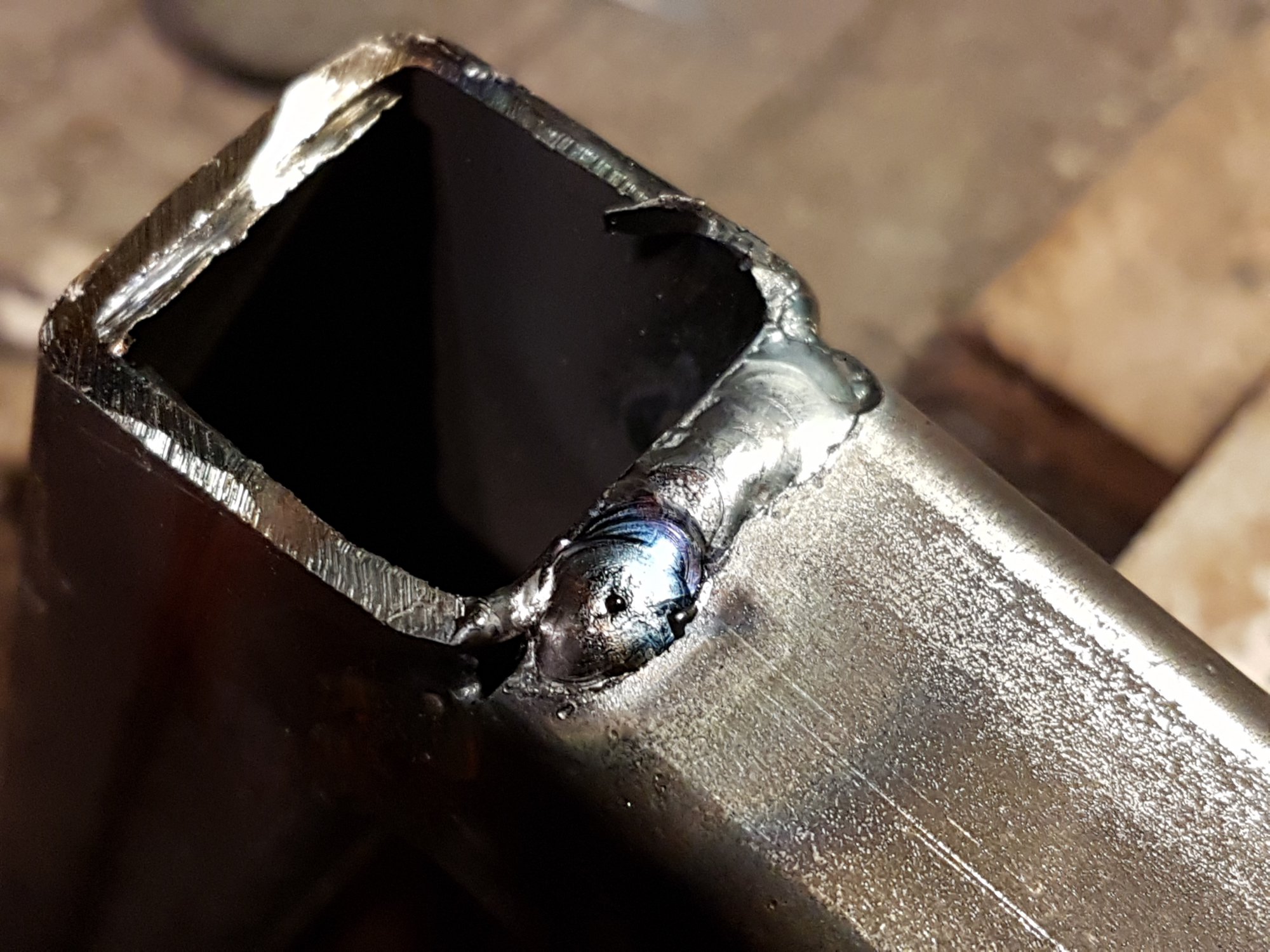

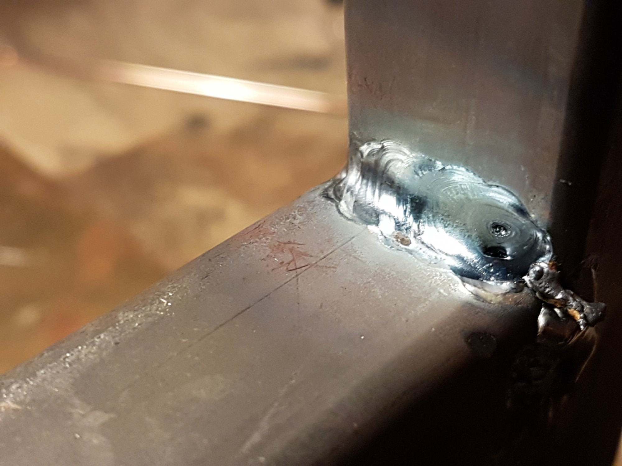

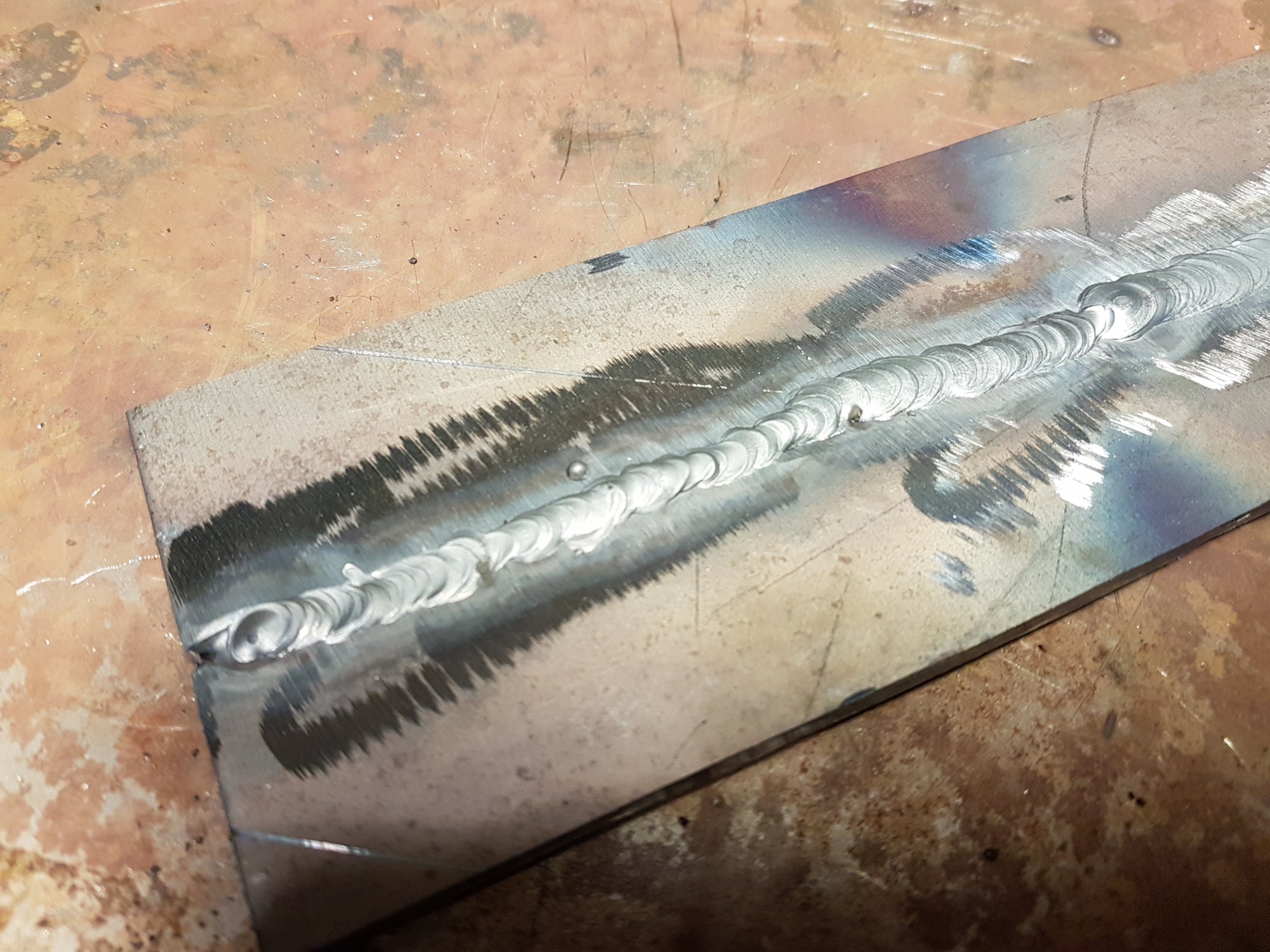

4: 5mm mild steel, still the same settings:
The dull grey look again and I guess really overheated (it was glowing red). Is this the torch too high or something else? Much better penetration though.

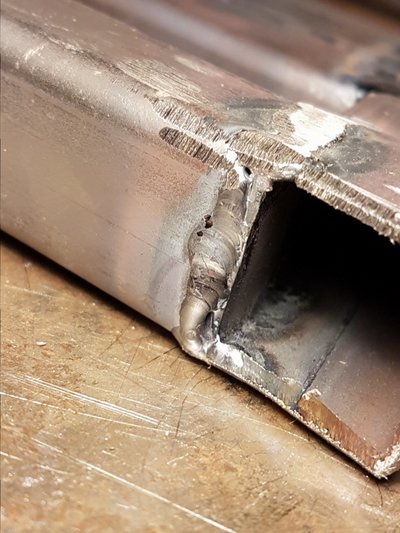

I tried again on the same piece but this time concentrating on holding the torch lower and backing off on the pedal once the pool had been established:
That looks worse to me.
