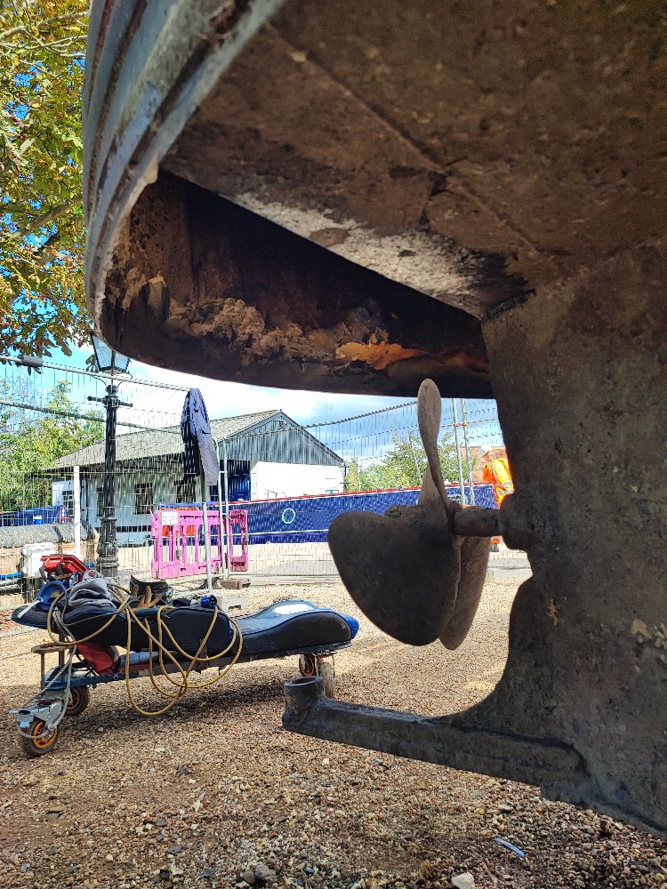

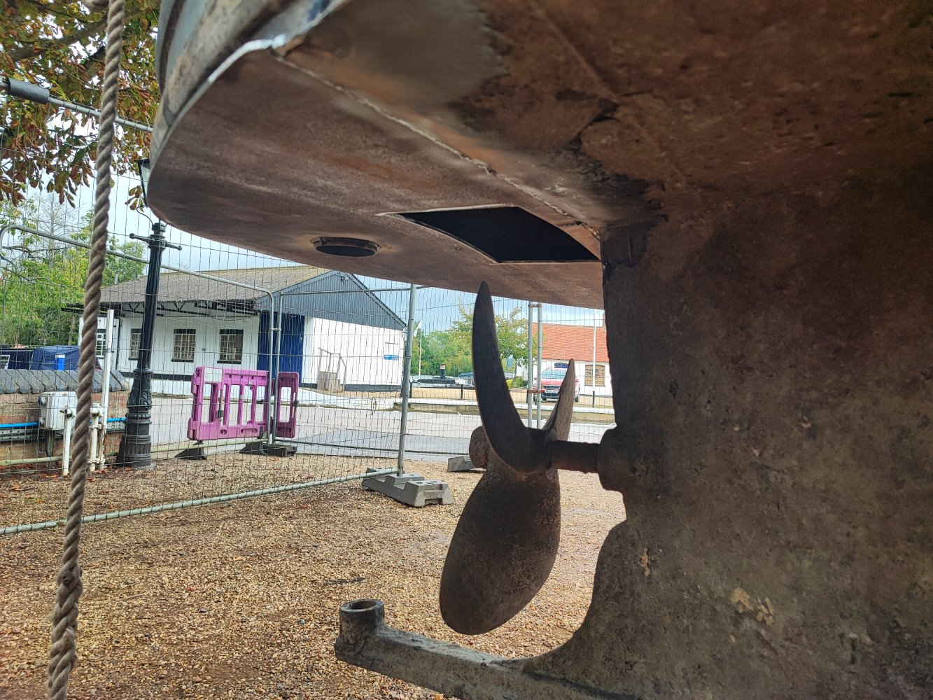

After being delayed due to my accident earlier this year we had this one lifted out last week to start repairs.

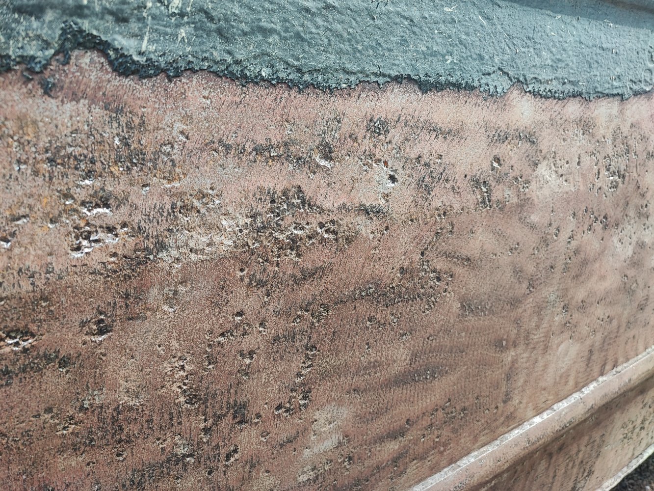

It had had a pre purchase survey and failed due to the condition of the rear counter, tiller assembly and weed hatch as well as a vast amount of pitting along the sides and some other bits and bobs.

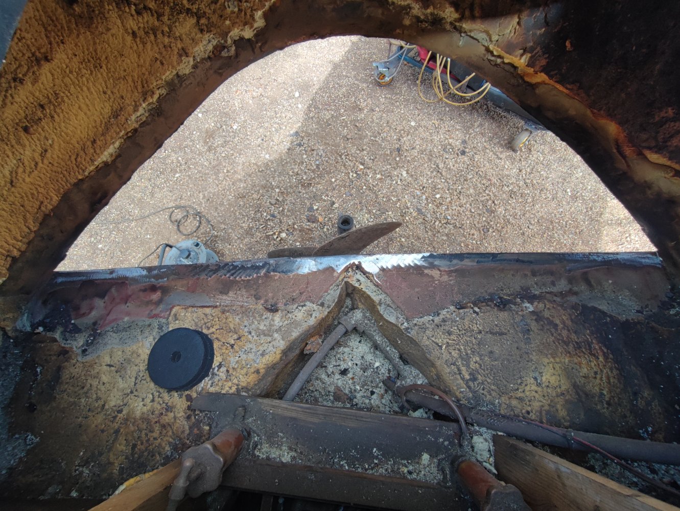

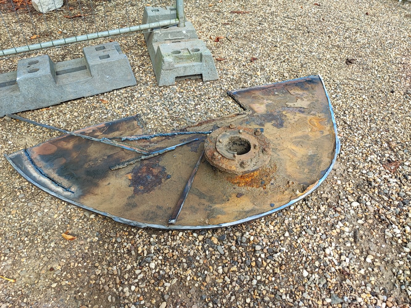

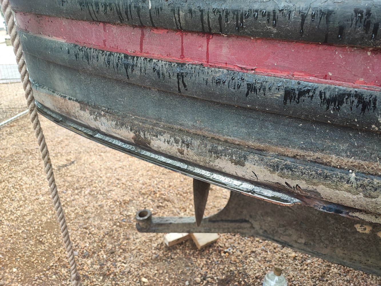

Instead of overplating and patching we cut the whole of the effected area out and started with fresh metal.
