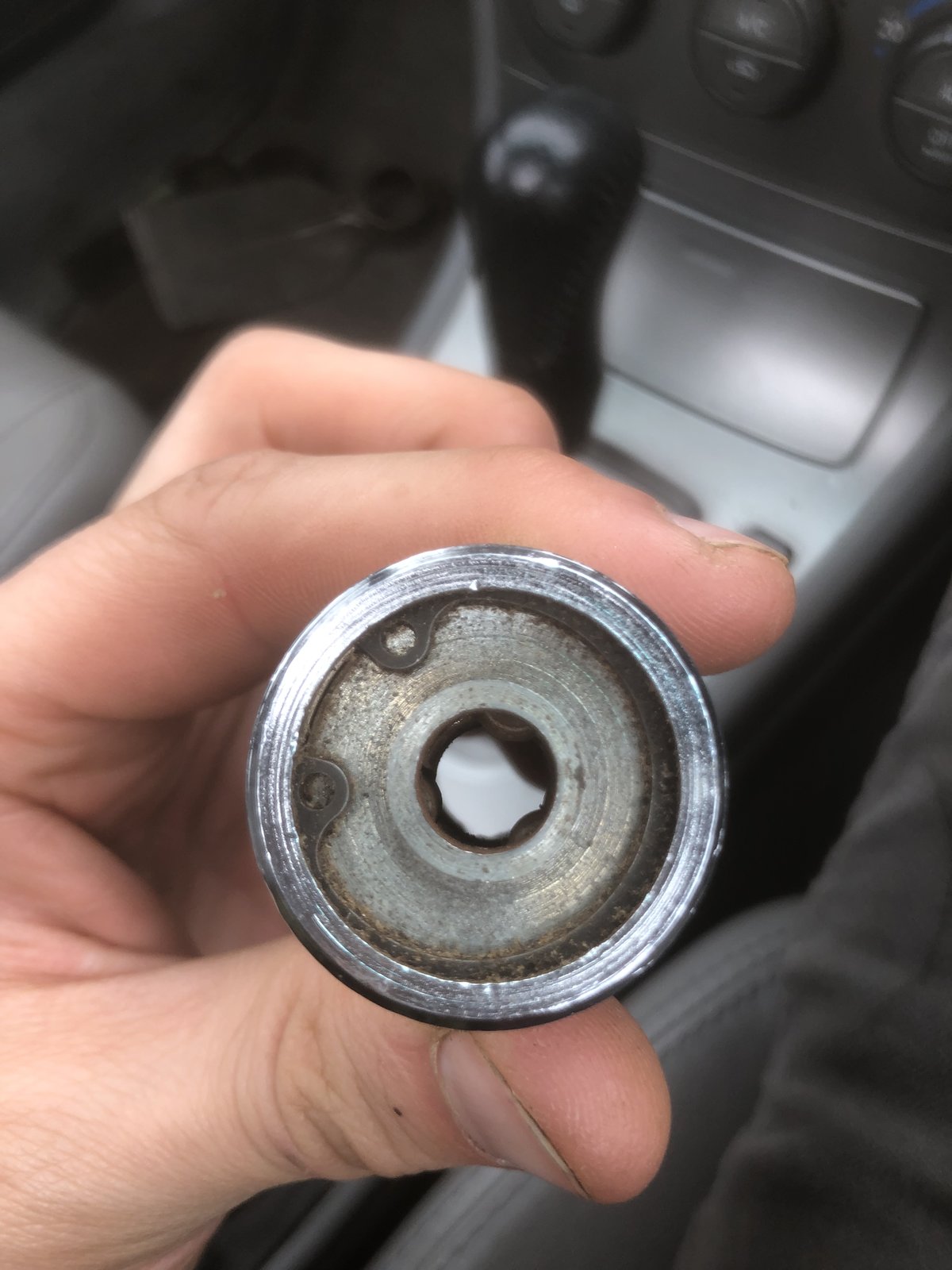

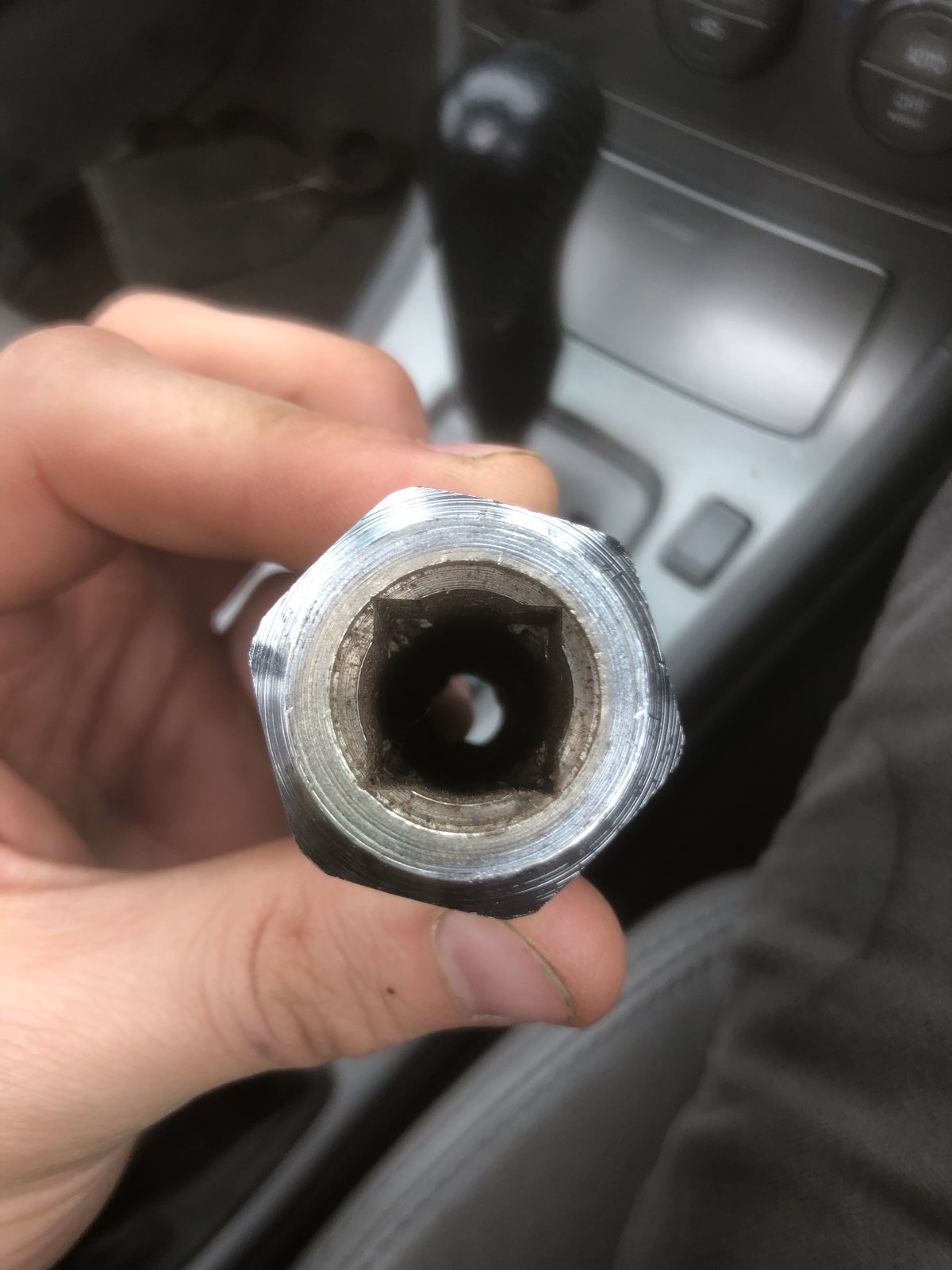

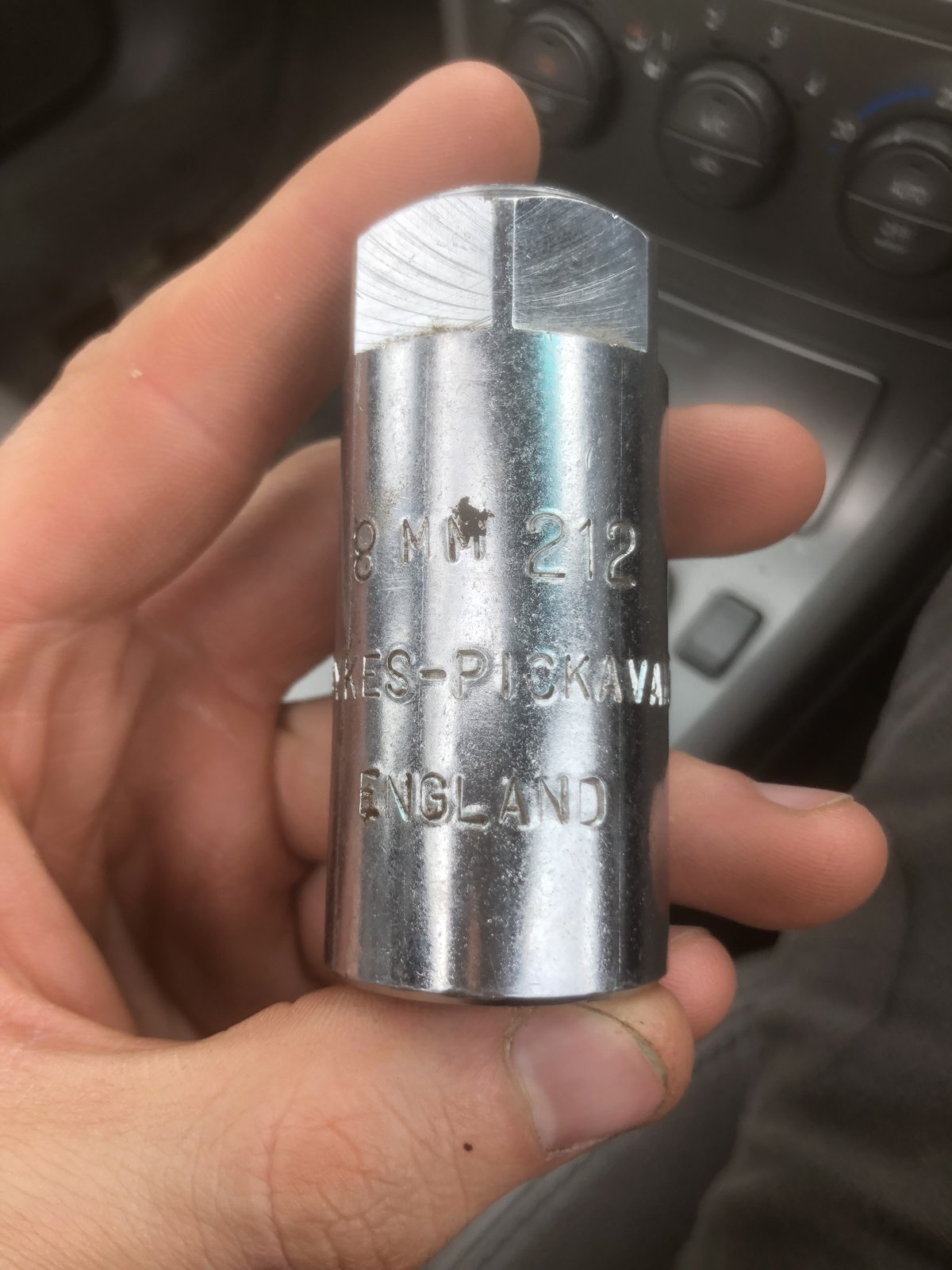

The silly goats have put the 8 upside downLooks like a stud remover. Try an M8 bolt in it and see if it grips. The 8 has been stamped upside down by the looks of it too!
Looks like a stud extractor, the three rollers inside act on a cam when you rotate the tool and are forced inwards, gripping the stud.
Inside the 'socket' covered by the plate that is retained by the circlip. I could be wrong but it looks very similar to some I have.Where are the rollers?
It may be correct as @Dieselkid 63 is in New Zealand!The silly goats have put the 8 upside down![]()
Inside parallel to the centreline.Where are the rollers?
