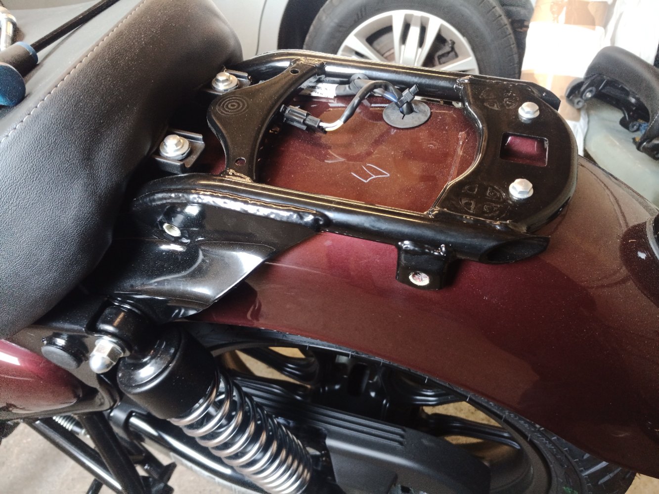

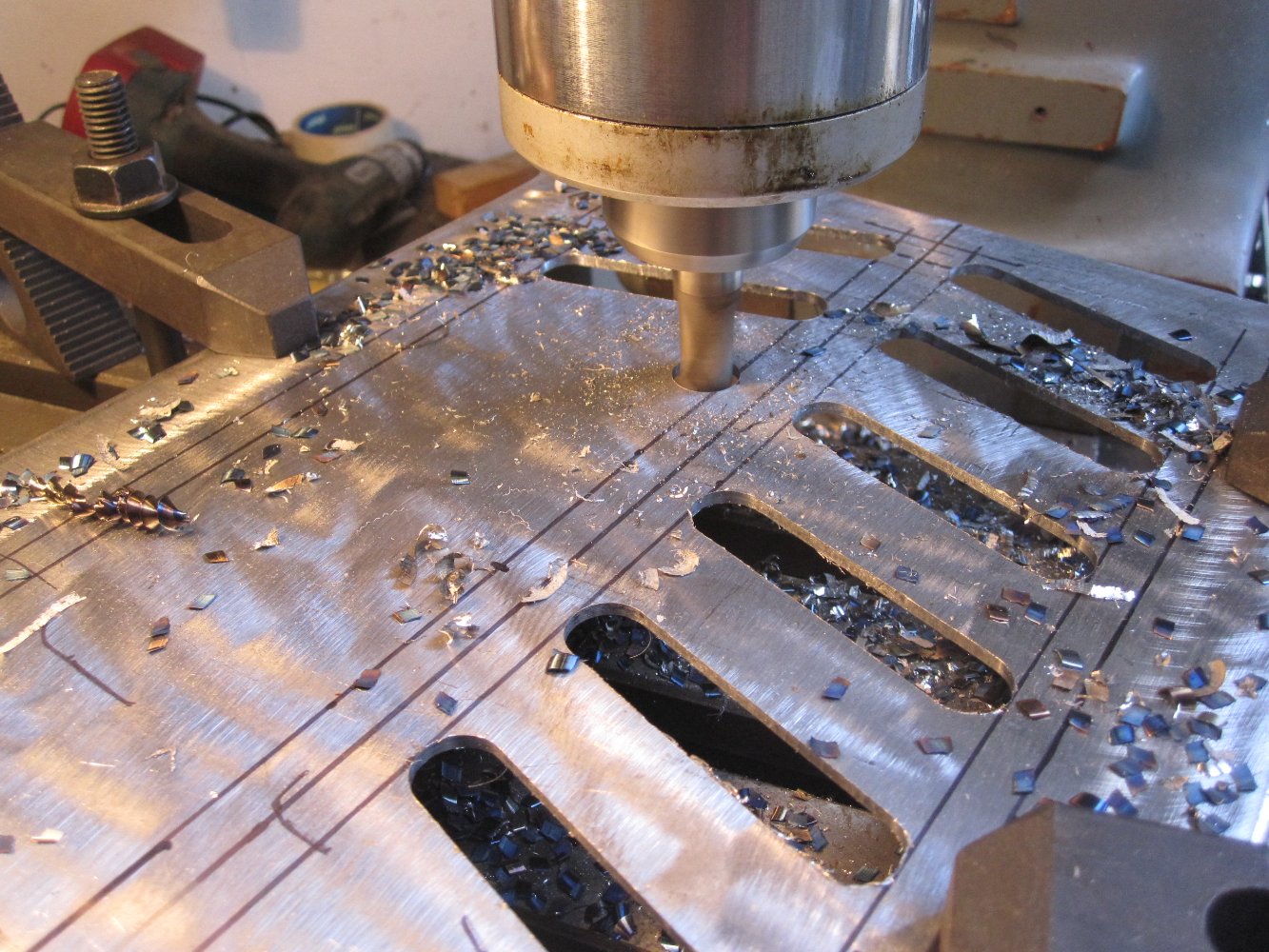

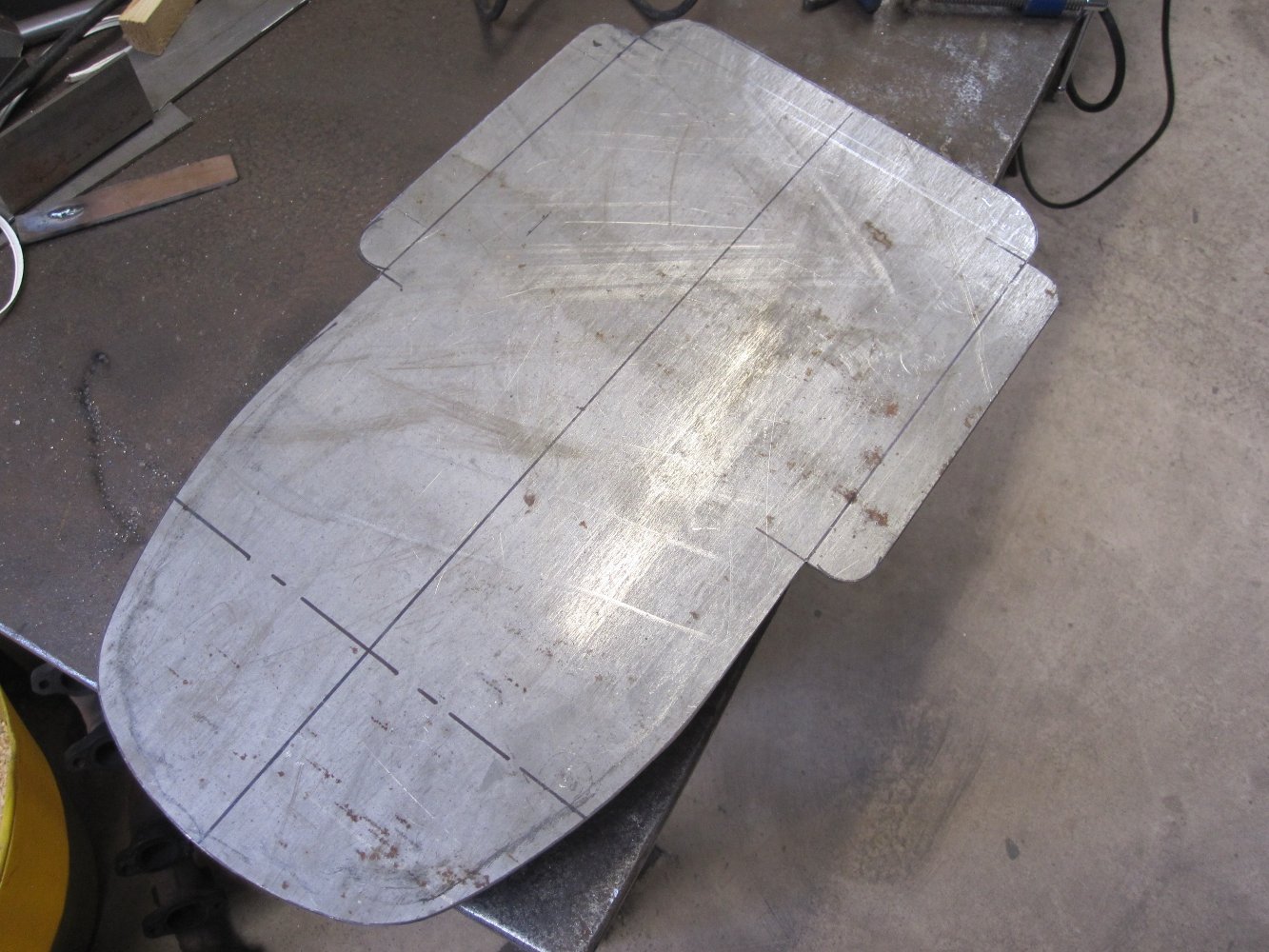

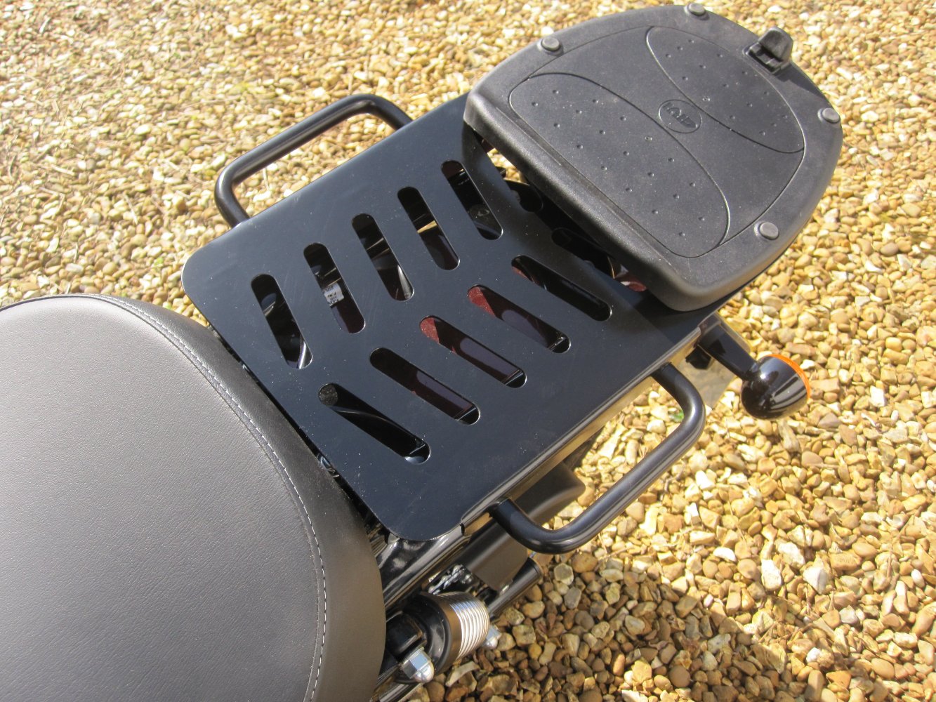

Do not need a pillion seat, something to carry "stuff" more useful. On removing the pillion seat from the Royal Enfield Meteor it exposes the frame and some unsightly wiring, so a tube ladder type rack would not be ideal. The usual "cad package" ensued to see what's possible. All looking good so some metal hacking followed. Not having a cnc plasma had to resort to the milling machine to cut out some lightening slots. They also make it look a bit more professional and not something lashed up by an old bloke in a shed. Mounting bits welded in and some black paint plus added a new quick mount top box plate.
