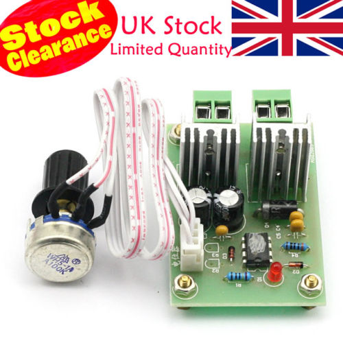

Replacing the power supply for wire feed seems popular, so I did this but also added a PWM as they're only £5 from ebay.

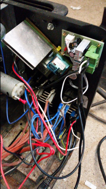

I also used an old 19.5v laptop power supply and a £1 24v relay.

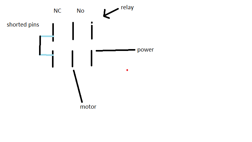

I de-soldered the original pot and bridged it with a short length of wire. The welder will now run at full speed all the time, but this doesn't matter as the old positive power lead for the motor is being used to operate the relay.
The power supply is wired into the main switch, and connected to the PWM. Neg output from the pwm goes straight to the motor, and the positive is switched by the relay.
The PWM I chose has a POT on a lead, so lets me use the original hole for the control knob.

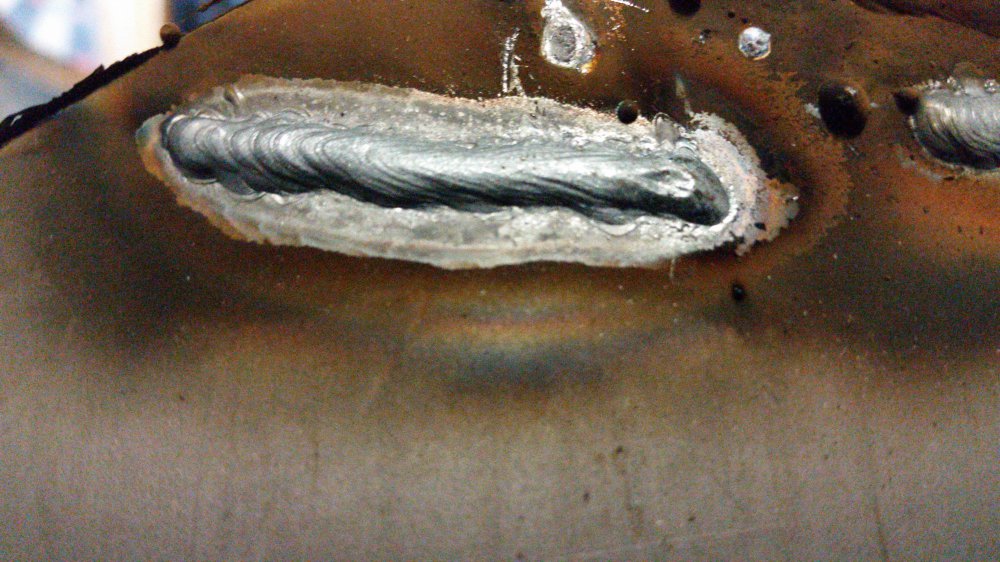

I have the pot turned down quite low for a nice bead on 2mm sheet.
